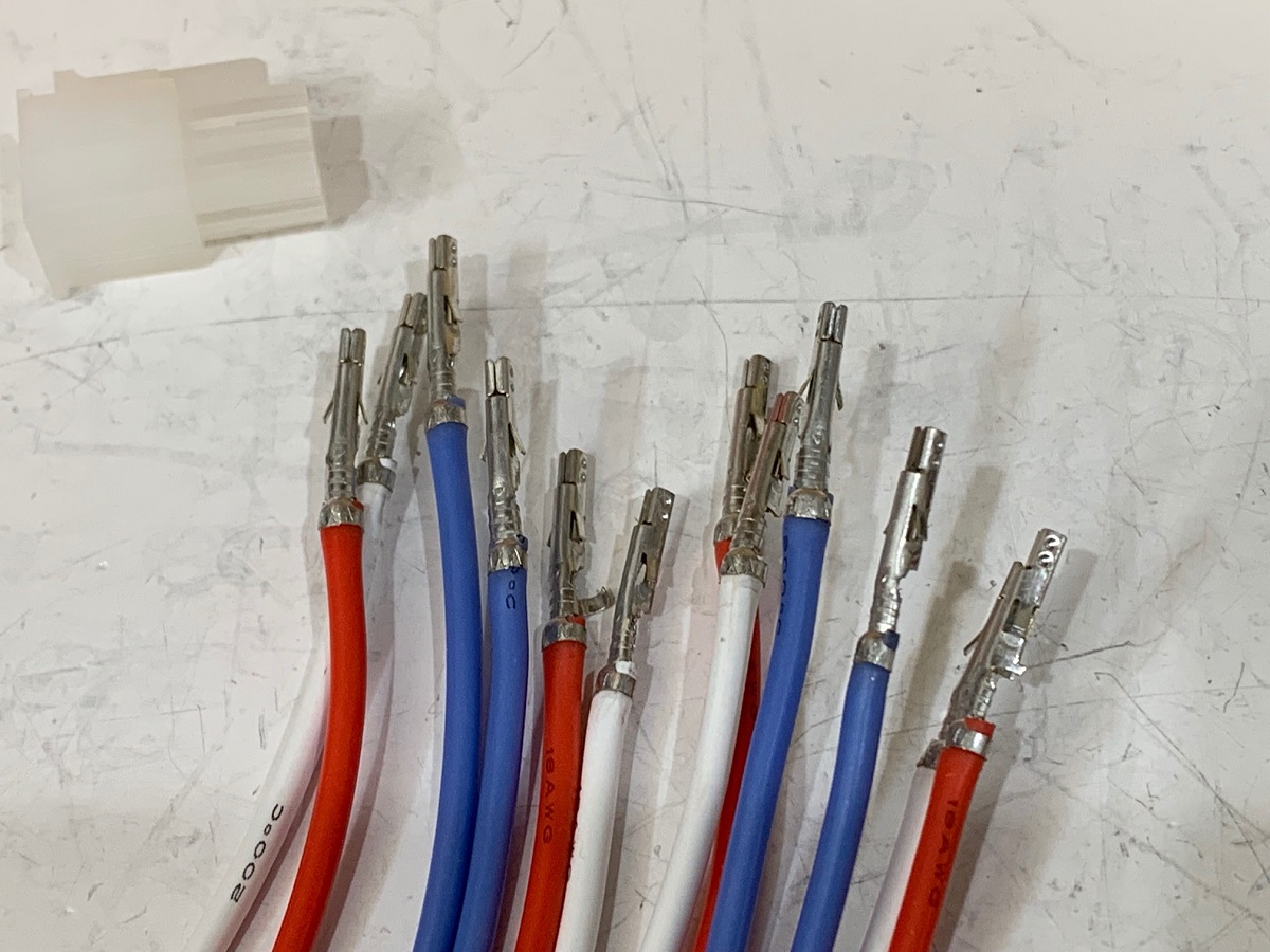

The Wurth/Molex MiniFit connectors specified are an industrial standard and capapble of reliable connections in high vibration environments. I would take them anyday over soldered flying leads due to the reduction of mechanical strain at the solder joint. Industrial/aersopace/automotive applications use connectors not only for convenience but for better protection of the joint from mechanical strain due to the stress risers at the wire/solder joint interface. I like spade connectors too - they are simple, inexpensive and very compact. That's why I specified them for use in certain locations like the PSU input and optional speaker outputs. But for BJT's amd MOSFETs, I specified Molex Minifit because there are 3 wires that should not ever be mixed up when connecting/re-connecting the actives (it will blow up the MOSFETs/BJTs like a dead short instantly when power is applied). So the connectors help to ensure the proper connections are made and they give convenience of a single connection vs 3. I did not choose to use the Molex Minfit simply because the are "sexy" as you say.
I have successfully used these connectors over many many amps and PSU's, and so have other folks here. We don't seem to have problems. Please show me a closeup photo of one your wire crimps before you insterted it into the shell. If you do it properly, it wil insert and fully seat in the shell and not be able to be pushed out when the shell is inserted into the mating jack that is mounted on the PCB. Here is what a properly crimped wire looks like before it is inserted into the shell (notice how the wings of the crimp wrap smoothly around the wire and clamp it down):

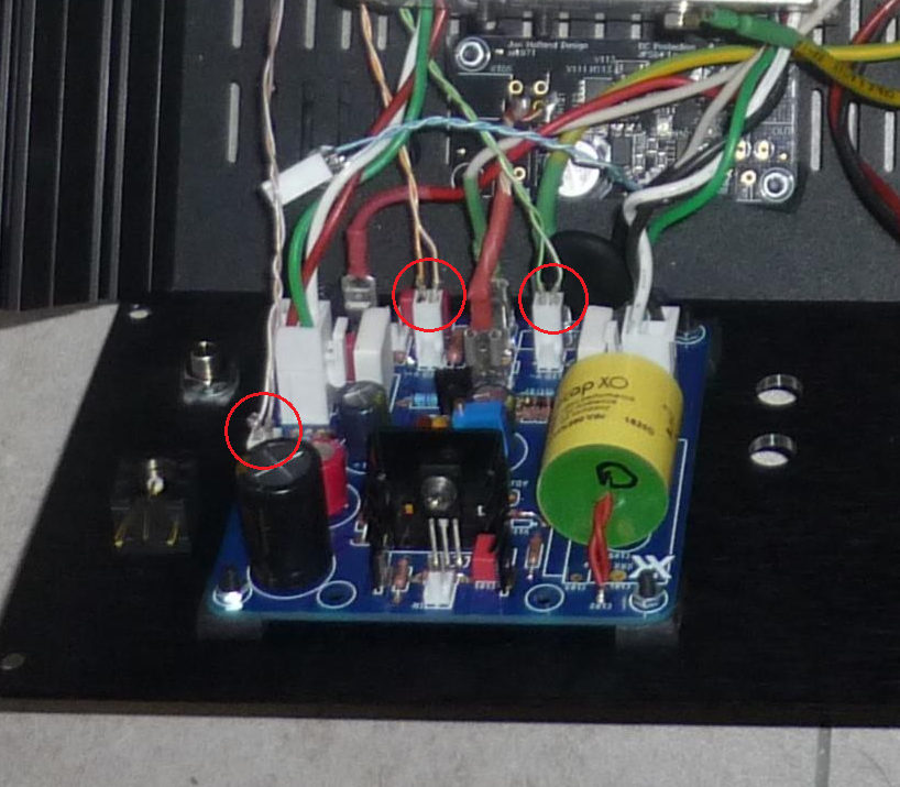

From the photo you posted of your build, I can see that your Molex KK connectors were improperly crimped as they are protruding way out of the shell - ony the wire is visible.
844484d1589610725-alpha-nirvana-39w-8ohm-class-amp-1-testing-jpg
Alhough this is the smaller KK connector, and here is a closeup of the your photo above showing the crimp connectors sticking out of the shell:
attachment.php
If the same sort of crimping technique was used on the larger Molex Minifit connectors, you probably have an unreliable connection that could come loose with vibration or movement. There is proper technique to making the crimps correctly. It takes a little practice (you will ruin a few crimp connectors in the process) and there are lots of YouTube videos that show how to do it. I even have a quick Howto on it here:

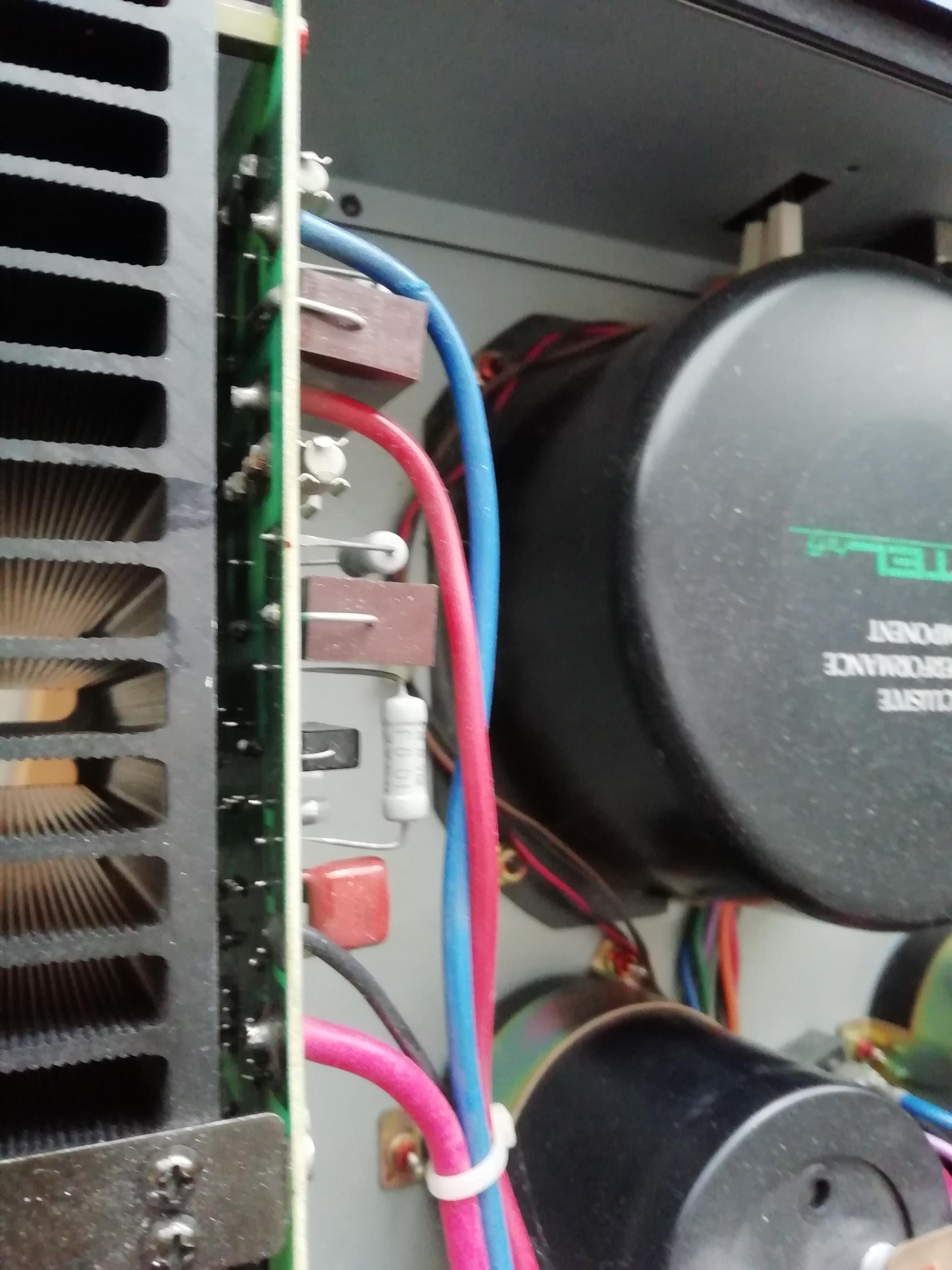

I build amplifiers since some 40 years and still prefer solder joints over connectors, but maybe I am an old fashioned stubborn DIY'er. Others are welcome to not agree.
Just something to consider, with Molex connection you have:
1. Molex PCB part soldered to PCB;
2. cable mechanically connected to Molex cable part by crimping;
3. the mechanical (spade) connection.
So three joints instead of just one solder joint.
More can go wrong with the connector isn't it?
An audio amplifier (normally) does not live in a "high vibration environment".
In a well executed solder joint in an amplifier, with well executed wiring, there is no mechanical strain.
There are applications where lead containing solder joints are still used over mechanical connectors; you will find examples in automotive (highly vibrational environment!).
With pads at both sides of the PCB and through hole tinning, you will have a very reliable maintenance free joint (at no extra cost of connectors 🙂). My Rotel not even went that far as it's PCB is one-sided copper...
