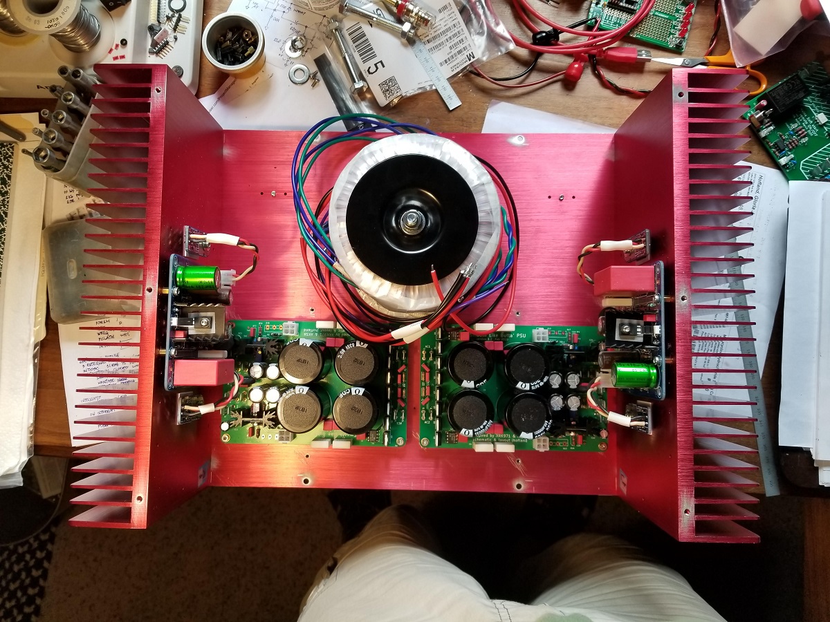

I am posting the progress that jhofland is making on a commissioned amp for a member on DIYA with the usual dual SLB's and dual trafos for the PSU. The chassis is a particularly colorful one from Aliexpress. Jhofland will design a custom soft start with a remote on/off switch for this amp. It will also use the RTR SSR speaker protection modules.
Dual traffos, X?
Are they stacked?
Andy
If you look carefully, you can see two on top of each other.
So it's not a (magnetic field) problem to stack them?
Andy
I’ve done it myself. I think on crossover inductors you want them orthogonal and far apart. Power toroidals keep most of their magnetic fields compact and inside the windings, and going around in a torus, unlike a loop air core inductor which has A very wide extensive field. I think Jhofland would have avoided this if it were a problem.
Andy
I stacked mine too in my USSA5, no issues, but I choose to wire them both in the same phase @primary side.
Yes, I have been successful before doing it the same as you see here. I've stacked them so the leads for the bottom transformer are on the top and the ones for the top transformer are on the bottom. There's a small spacer roughly 3mm thick added between the two transformers so the leads don't get crushed.
Surely one would always do this?
That seems like a very logical thing to do, jh ... but does it actually deliver any better result than doing the opposite? (So the leads for the bottom transformer are on the bottom and the ones for the top transformer are on the top.)
Can anyone confirm that if you choose not to stack the power traffos but put them side by side ... then the further apart they are, the better? (To minimise magnetic field coupling.)

Hi Andy,
I started my USSA5 with the trafos stacked and Alpha Nirvana with the trafos side by side. Then decidedly to stack the AN’s trafos and change the USSA5 trafo’s to side by side orientation. I didn’t notice any changes in sound at all. I believe properly routed wiring and grounding scheme have a much bigger influence to ‘noise’.
I have also stacked side by side directly adjacent with no issues. One of my quietest amps has two toroidals side by side and touching each other because case is so tight. Like I said earlier, a toroidal transformer keeps most of its magnetic flux in a right donut shaped bundle *inside* the windings. Anything outside has to make a loop perpendicular to the toroidal field and the loop must complete a circuit that encloses (go through the central donut hole) that magnetic field path. Otherwise, it’s not a huge influence.
From your line of questioning Andy, it doesn’t sound like you are going to take the explanations and anecdotal evidence by any of us. Please read up on toroidal transformer theory and see why a toroidal is used. It’s the same reason nuclear fusion reactors that use magnetic containment are in a toroid. The magnetic field is almost perfectly captured inside the tokamak.
That's great to hear, X - and thank you also, V, for your descriptions of what you have done.
That's a bit unfair, X.
I have learnt something today that will help me a lot in future amp builds. I had simply always thought that traffos needed to be separated (which has problems, sometimes.

Hi Andy,
Sorry - I didn’t mean to offend you. It’s just that three of us (Jhofland, Vunce, myself) whom have built amps with toroidals stacked top/bottom or side/side mode, tell you that it’s fine, and your questions just keep coming... makes it sound like you are not satisfied with our explanations.
Hi Andy,
Maybe Im just one who needs to be told 3 times, X?
