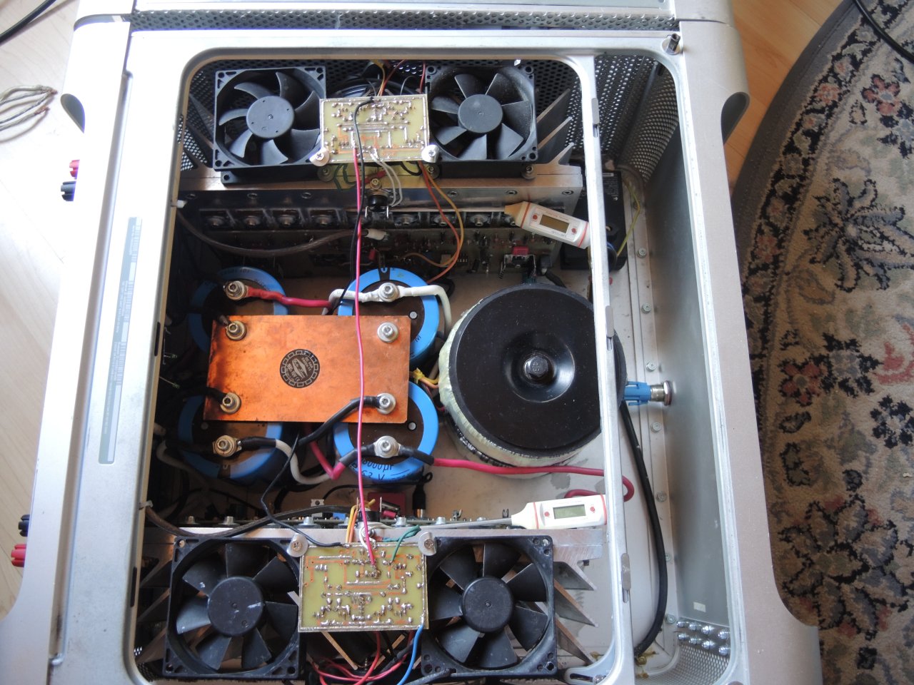

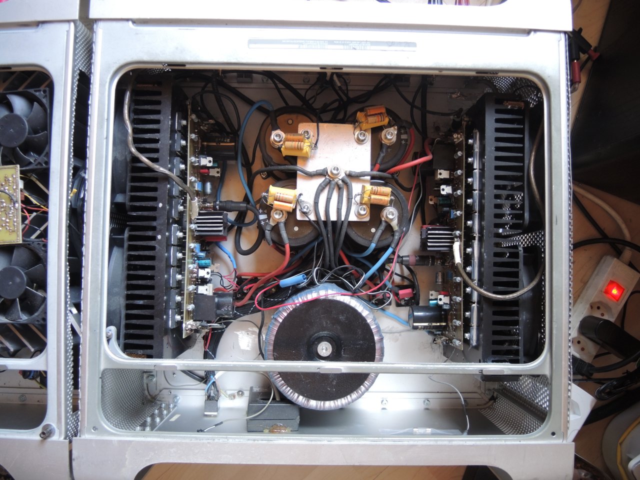

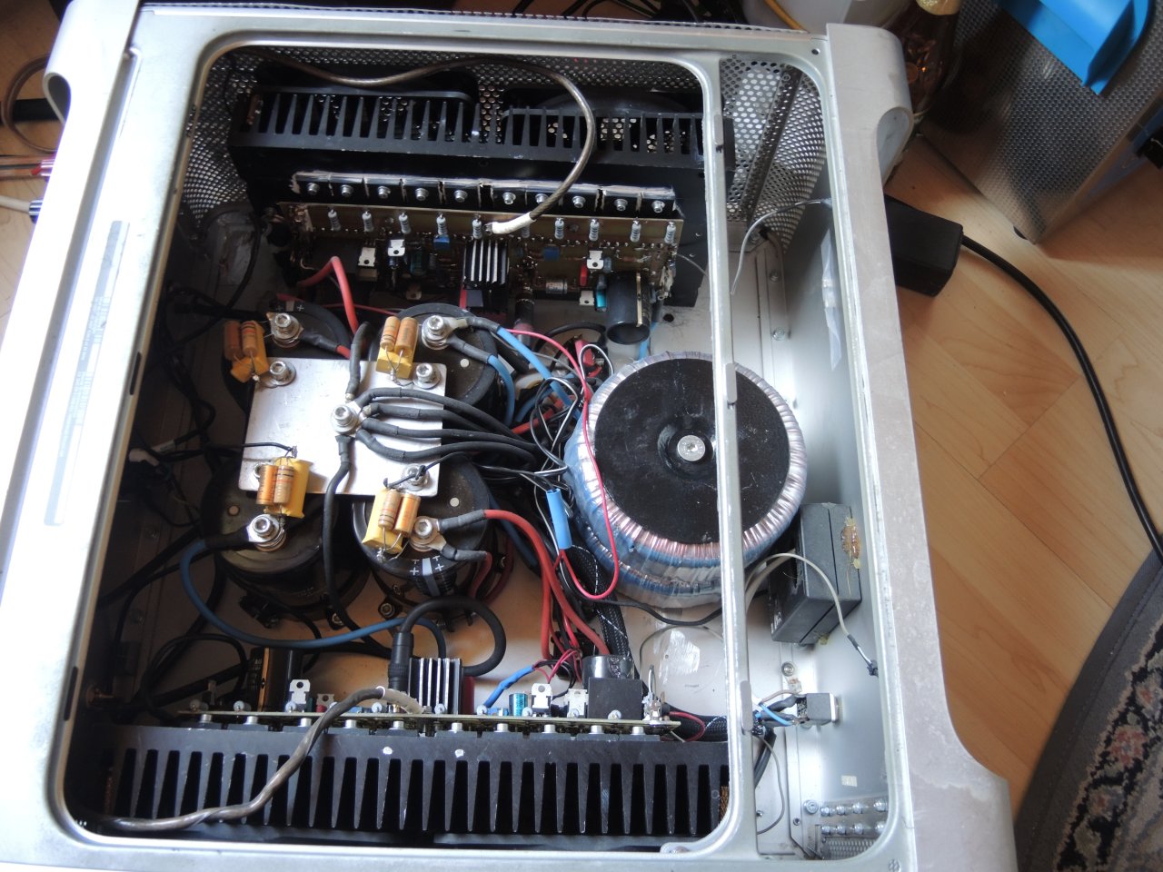

Too many wires laid out to and from the PCB.. try to use less.
I have in my amps - Rail +- wires, Ground wires, Loudspeaker only the Positive one to the PCB the second on Center/grounding this and then the Fans control ..
Try to design the Power/transistor PCB that there you don't need wires to connect the Pins.
Check out this pics so you will see the difference, and then check out my 2020 with almost only Supply in and out wires.. But that one is not finished yet so it might does not look that good. it will be in the box same as the others, in about 14 days when testing has finished. you will find in my thread about Class A.

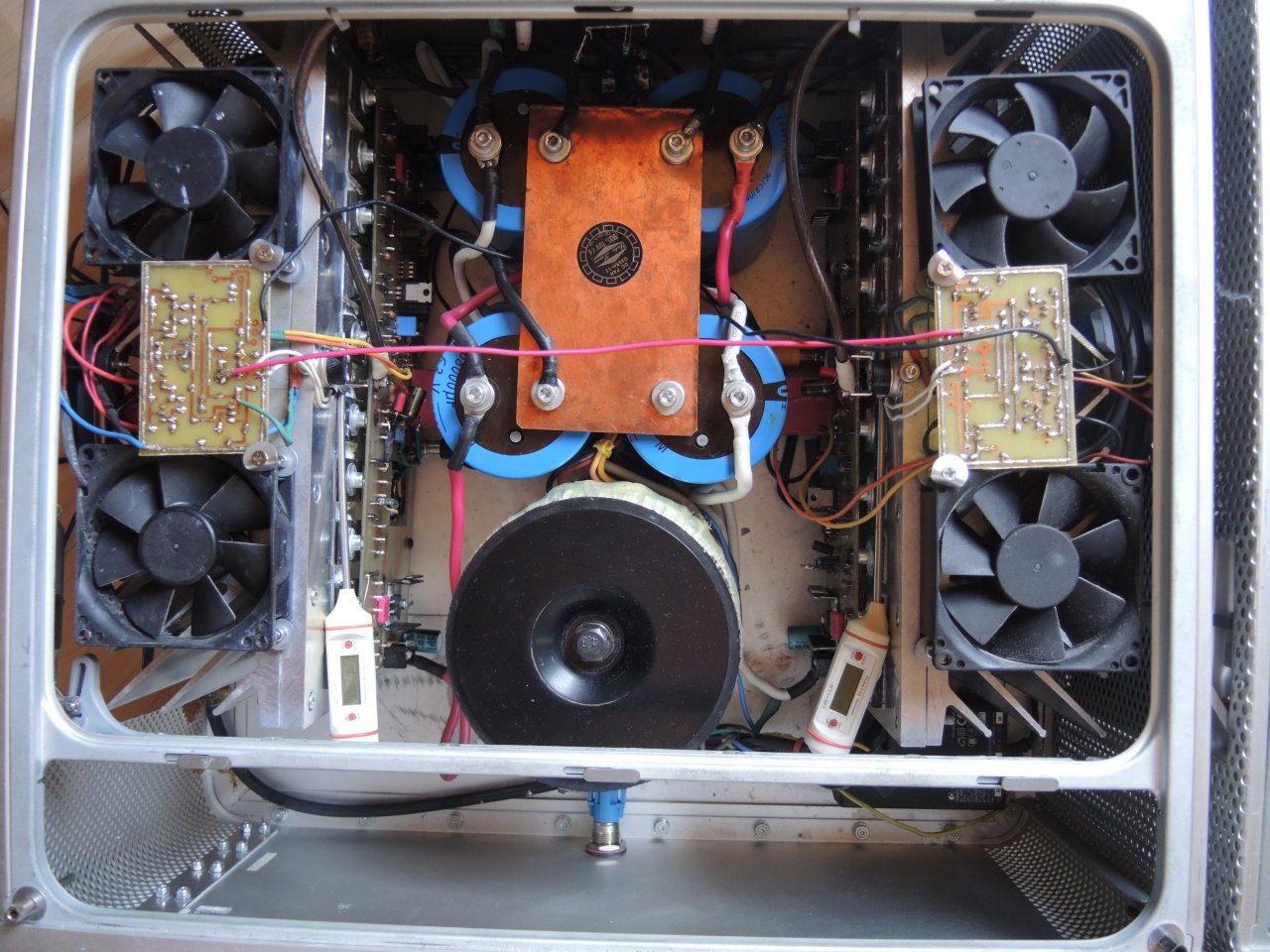

Amps are: Class a, Ver.4 - 50Watts per channel build 2013 Single end with Constant Current Transistors Quasi Complimentary *all NPN transistors in Output * - and PID to control DC Out.
4 Fans running at approximately 450RPM / Fan
Class A Ver. 5.02 -50Watts / Channel Build September 2017 Single End with Constant Current Transistor Quasi Complimentary *all NPN transistors in Output * - and PID to control DC output & Fan Control units which will activate Fans, at the Temp of 75C and switch them of at 30C even the Amp has already been switched of beforehand.
Fan speed is 600rpm / 6 Fans and I can assure you, you will not hear the Fans
Anyway I like your build it looks good, and of course that you are using the Active Cooling sinks..
Today it's very uncomplicated to have the Fans run at speeds, so that they keep the heat exactly where the designer wants them without to be annoying loud..
If an Amp get 75C or 80C this doesn't kill the AMP otherwise my AMPS would be dead a long time ago... they run almost daily for 4 and more hours.
Nice build I like it.

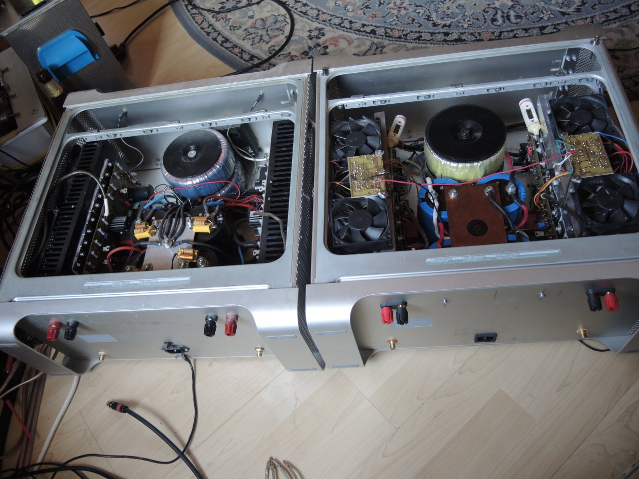

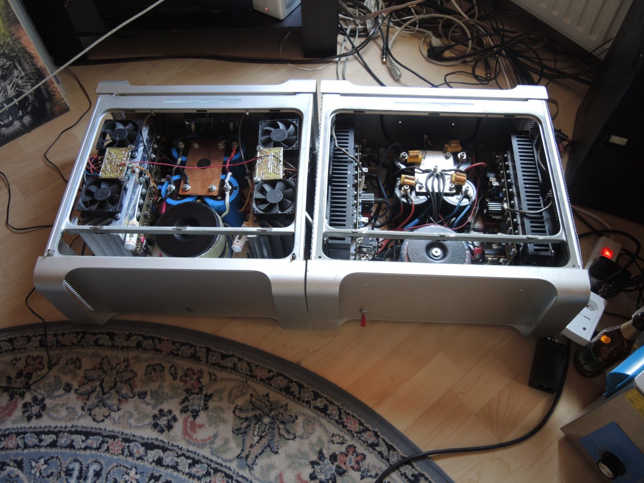

Yes MAC PRO G5
Hi Hpro,
Are those repurposed cheesegrater Mac Pro chassis ?
Nice work btw.
Jacques
@jagues antoine
Yes that are G5 Mac Pro computer originally.. givin nice Chassis.. I buy them for about 50 - 100 CHF = Same in US$ a piece.
I also use the Heat sinks of them for my new Class A..
It's almost to the point to get it into the case..Again Mac Pro G5 Boxes
Needs a bit modeling and there we go..
Regards Chris
