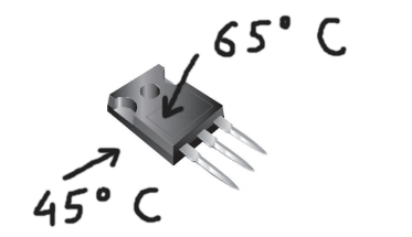

I did more temperature measurements, and I have one observation:
a) when measuring FET temp on the BACK of the case: 64 degrees
b) when measuring FET temp on the SIDE of the case: 44 degrees
Well, that makes it two, not one.
See picture.
20 degrees difference! Wouldn't suspect..
I guess distance from the plastic surface to the die matters!
Or it's the way the infrared thermometer "sees" the smaller vs bigger surface?
These temps registered 20 minutes after start, they will crawl closer to 70 degrees later on, and they are measured with infrared device,

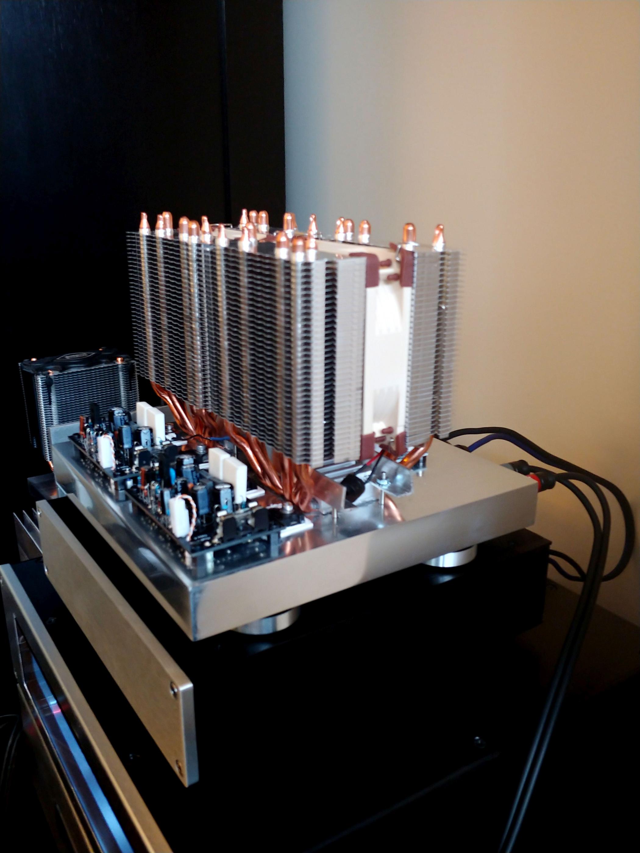

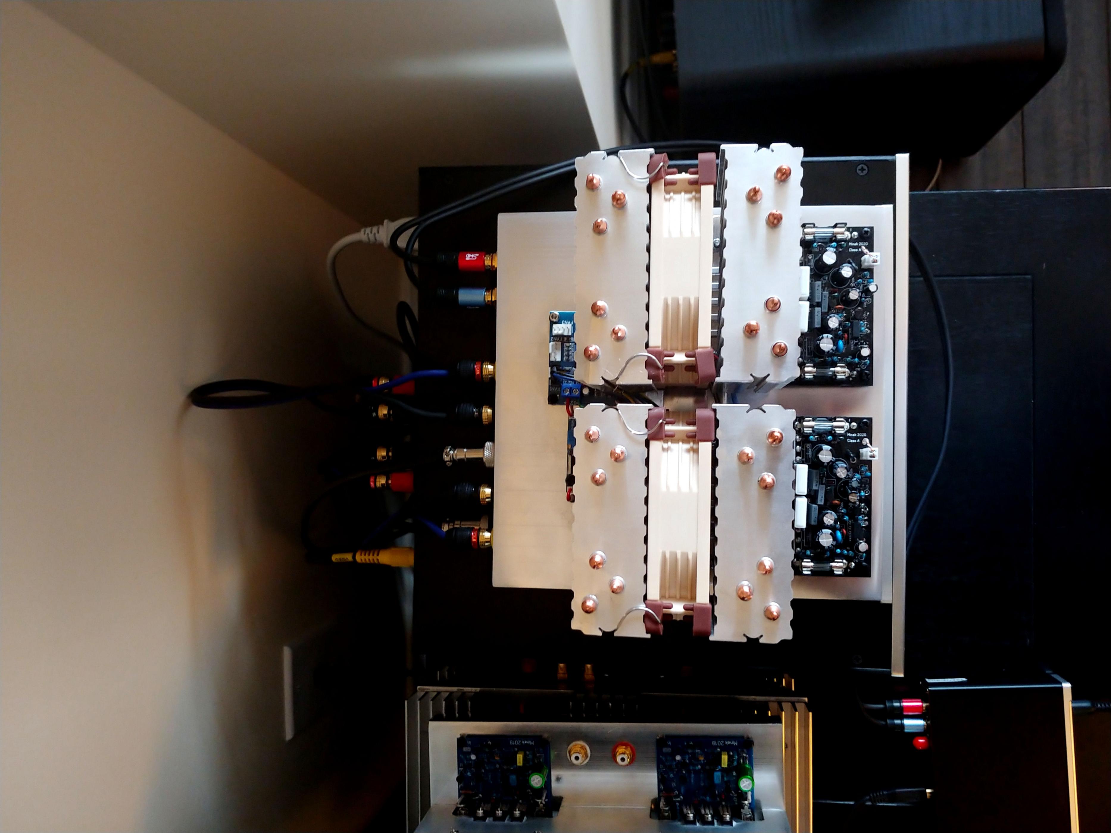

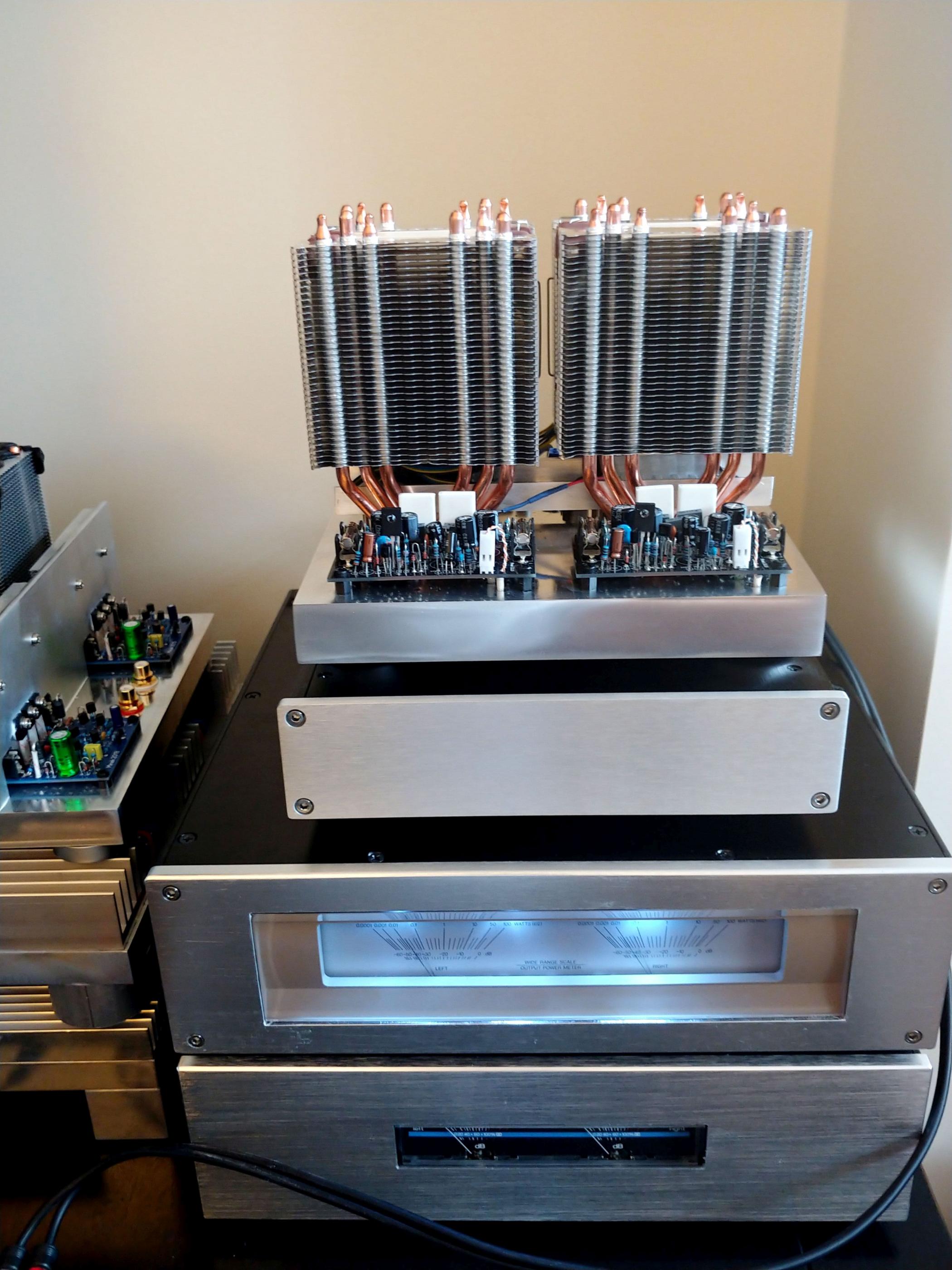

I see about 62-65 after an hour or so, without any air moving. When they are placed in the dedicated room, there is an air column (adjustable volume and temp) that cools all components, I set it up when I built the room.
Here are the final photos.
AN is on top of small Alu box without VU meters - that's AN's
PSU.
Below it's my other two PSUs, that are used for all other amps -
the one with lights on is handling output (speaker protection and VUs) for AN.
It's not really needed - I could plug speakers directly to AN, but I want to use
protection...
New, 4-pins Noctua fans are actually controlled by the temperature sensor (it turned out
that previous 3-pin fans were not!), and they are running slightly faster than old ones.
As a result, FET's temperature of in low 60s, and they are also dead quiet.
These VU meters are from burned out Technics chip amp and from dead Akai tape player..

I'm building two more ANs like this for friends..
Waiting for 4 more HP bricks (model hstnn-da12) - only $18 each, and they
are very good quality PSUs; and for Alu box enclosures for them.
The hardest part is milling aluminum for the chassis 🙂

Most of the reasonably priced IR thermometers out there do not like shiny surfaces and also they have a much larger area that they “look at” then the led indicator light. The area gets larger as you move the thermometer away from what you are measuring. So if the area of the device is small, like the side of that mosfet, it will be a smaller part of the overall picture that the thermometer sees, and since the fet is the hottest thing in the picture, the temperature indicated will be averaged downwards.
So, I would tend to believe the higher reading taken from the front of the mosfet.
Fantastic build, by the way. Art and technology as one!
What's the dif in temps fore and aft?
Can't measure it, have no access to the narrow back edge of the fet...
Can only measure 'upper' back, and one side.
