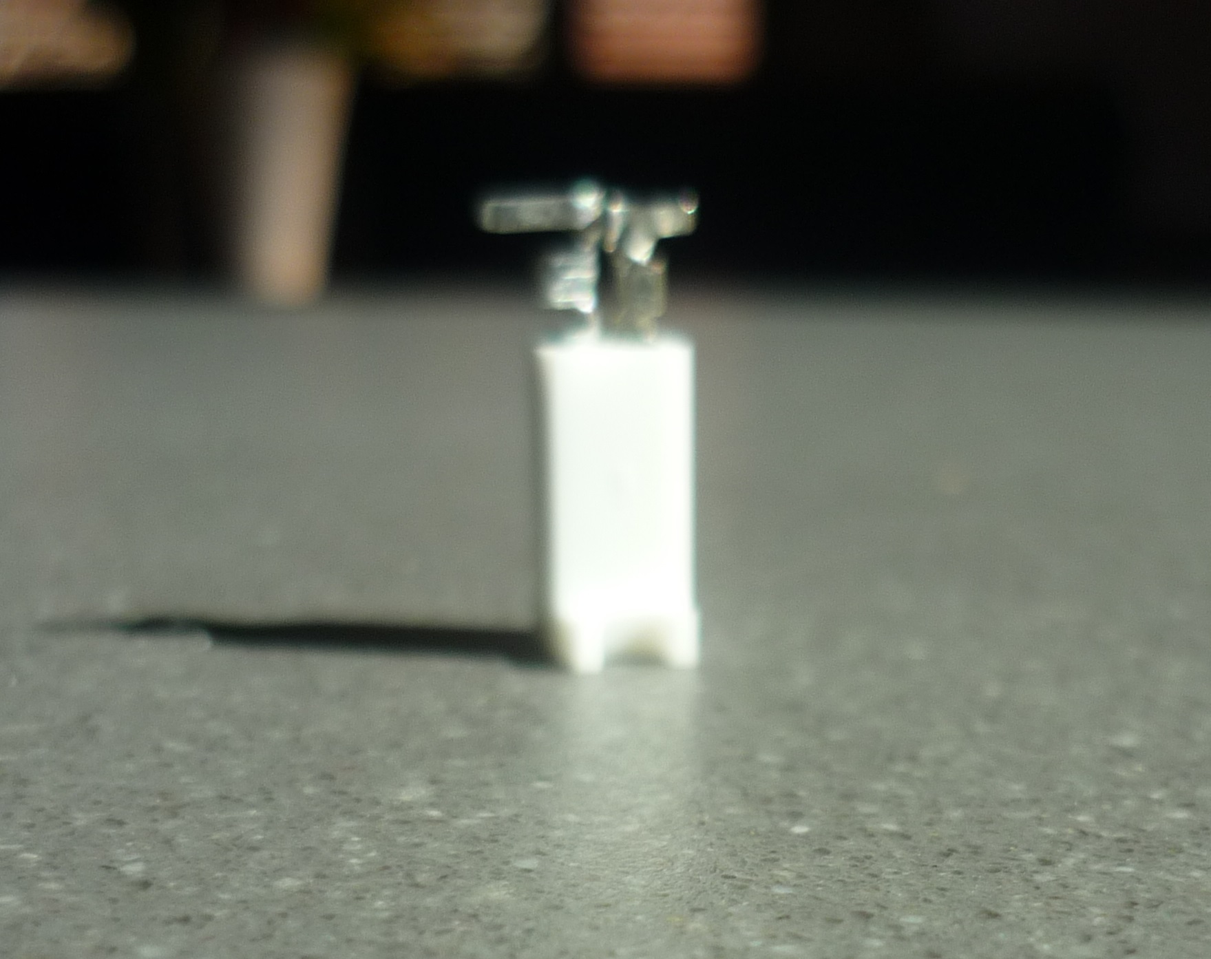

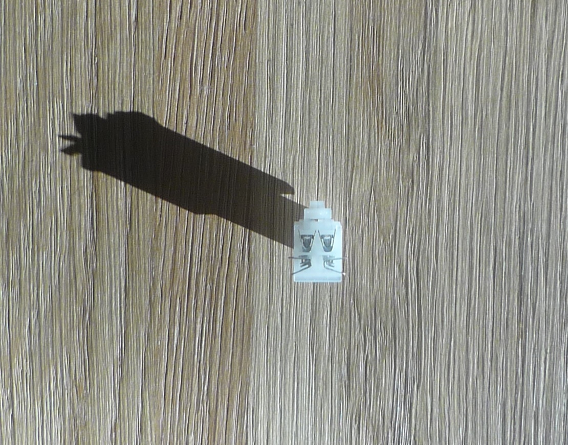

Hi X,
Attached is a photo of a spare 2-pin Molex header - with 2 unused sockets inserted (inserted with different orientations).
These are pushed in as far as they will go - and still stick out the top? (They are the components specified in the AN BoM.)
Andy

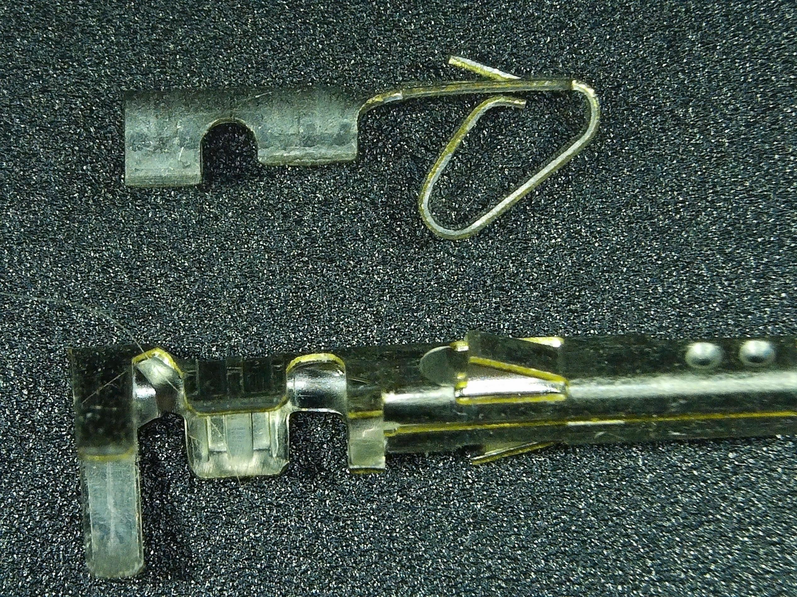

Andy,
Those crimps look to be for the MiniFit series, you are installing them in the smaller KK series.
The picture is not clear, but I see the wings that crimp around the larger 18awg wire insulation.
If that’s the case, they are on the BOM and are specifically for the MiniFit Jr housing:

I don’t know why your connectors stick out like that - except that maybe you have the wrong crimp connectors for the KK shell. The Molex Minifit connectors are much bigger that the KK connectors.

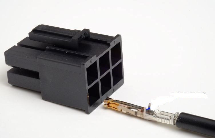

Molex contacts
As Vunce mentioned, the contact pins for the Molex KK series and the minifit series are quite different. I have attached a photo comparing them. The smaller one is what goes into a Molex KK receptacle with the small tine oriented toward the small slot in the receptacle and should be inserted until the tine clicks in place After crimping the minifit contact should still have the two fins sticking out. The contact goes into the receptacle with those fins pointed toward the flat of the D looking at the opposite end of the receptacle as the entry point.
I hope this clarifies how to load them.

You are correct, V - those sockets are Molex 39-00-0039.
In the Mouser cart for the AN that I printed off back at the start of the year, there are no pin connectors listed for the 2-pin housings (22-23-2021 & 22-01-3027)? Hence I used the 39-00-0039 which actually were specified in the SLB build (Wurth 4-pin connectors / sockets were specified in the AN BoM).
What pin-sockets are supposed to be used with the 2-pin KK series?
Andy
Thanks for the pic, Jan. I have not seen that top connector before - it was certainly not listed in the BoM that I printed off when I started the build.
I will try out your instruction on how to load the minifit connectors, soon (and see whether I can do it correctly. )
Andy
Hi Andy,
It took me a few tries and some bad ones going into the garbage. Personally, I have a harder time with the section of the contact that's supposed to wrap around the wire insulation and I have resorted to trimming a little off and prebending that part so it crimps evenly. The other thing I will note about the KK contact is that trying to use wire a little too big around makes it especially difficult to put into the housing.
Jan
Jan
....and I have resorted to trimming a little off and prebending that part so it crimps evenly....
Hi Jan,
I perform the same minor surgery on the ‘wings’ of the Minifit crimps
Sorry, Jan - I can't picture what you are trying to tell me - re. the Minifit connectors.
Re. the attached pic of a header with 4x un-crimped pin connectors 'dropped into the top' ... which is the correct way for insertion:
1. the 2 fins pointing to the housing lock mechanism at the top (like on the top line)?
2. or the fins pointing out to each side (like on the bottom line)?
