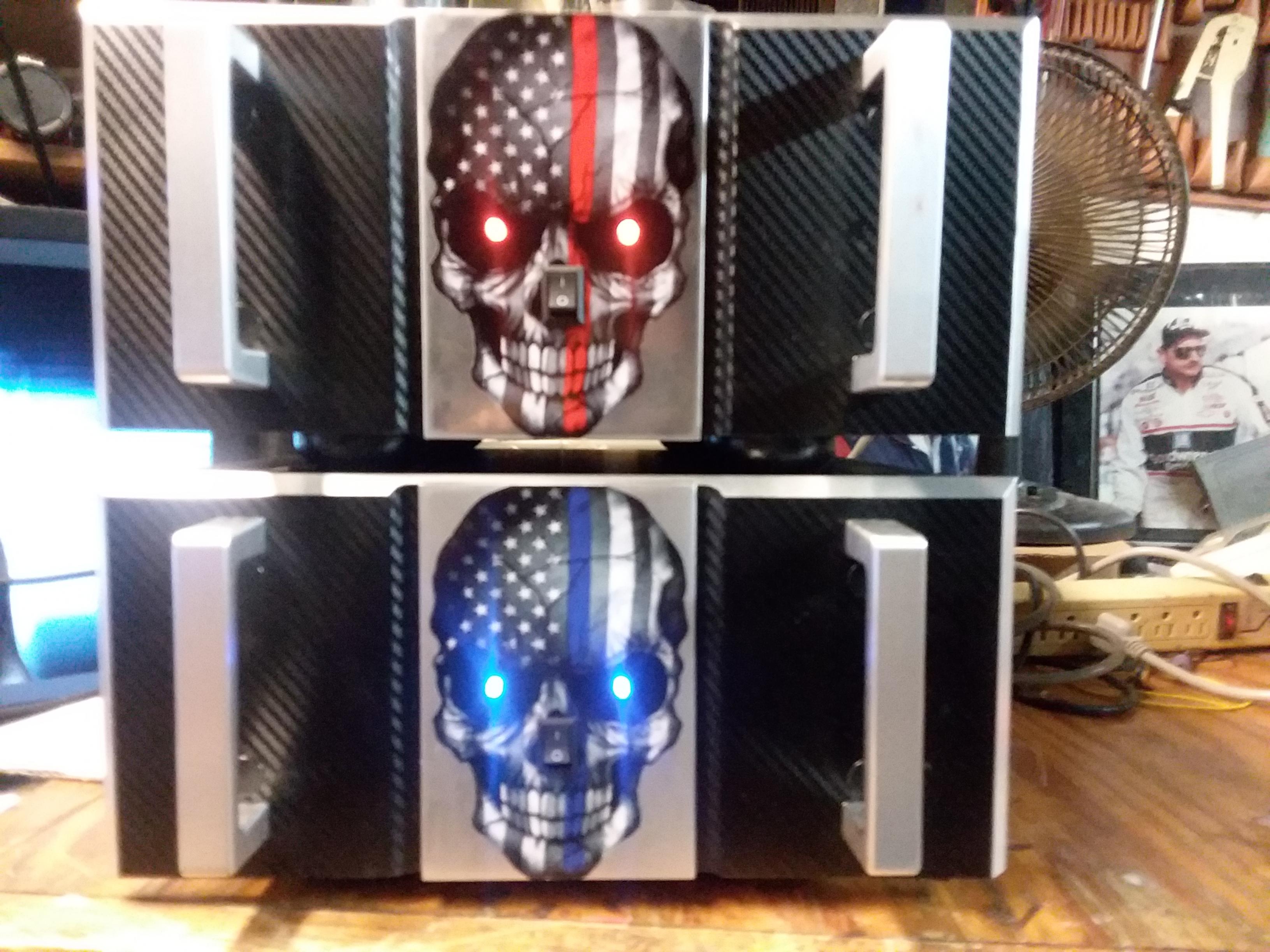

First Ever...
Ladies and Gents, may I introduce the 3rd AN, and the first ever monos.... sexy bitches if I do say so.
Hugh and Jim, thank you both... much love brothers. ;)
Sorry about the **** pictures, I promise to get better ones when they make it to the room.
