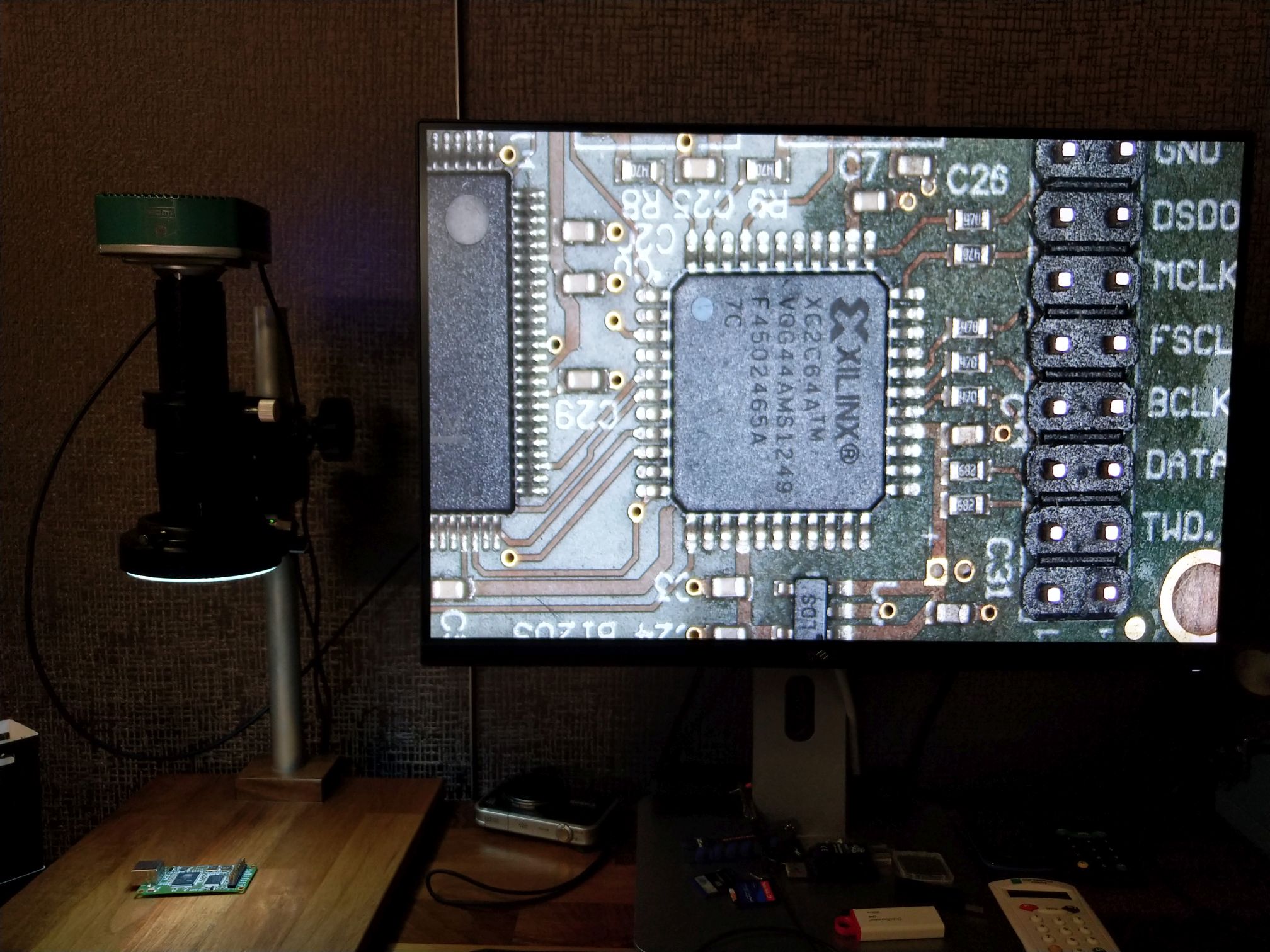

I find SMD soldering much easier with a 60fps hdmi microscope.
The 60fps hdmi makes it real-time without lag.
Take a 180x zoom lens and a 0.5x barrow lens to double the working distance.
I's nice to see those small critters 20x bigger,
also very helpful for checking the soldering quality afterwards.
