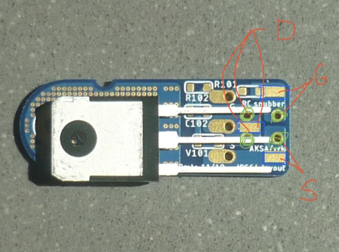

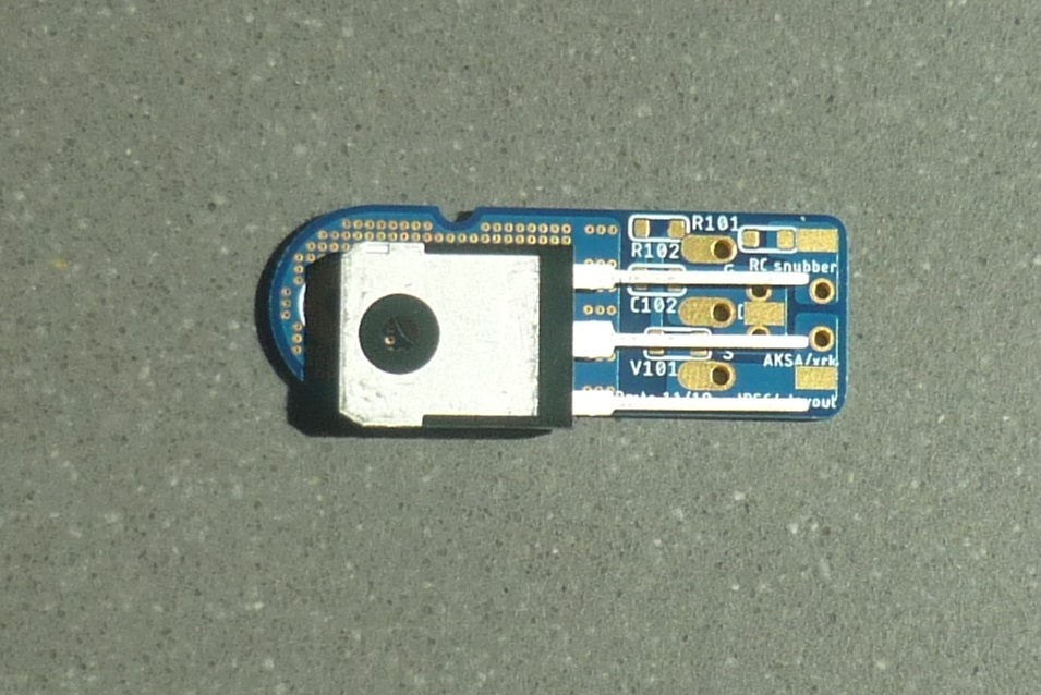

So - Q1: - the 4 holes (in a square) on the RH end of the Snubber board (see below pic) are for soldering the 3 wires which connect to the 3 pins of the MOSFETs?
https://www.diyaudio.com/forums/attachment.php?attachmentid=823825&stc=1&d=1583807075
Q2: Am I right in thinking that:
* the 2 holes on the LHS of the square are both for pin2 (Drain)
* the top right hole is for pin1 (Gate), and
* the bottom right hole is for pin3 (Source)?

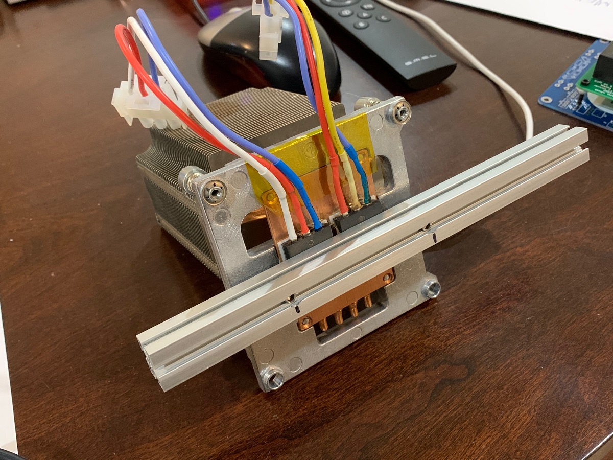

Here they are clamped to that really compact Dell CPU cooler (which, btw, Vunce has verified has no problem cooling 150w thermal load):

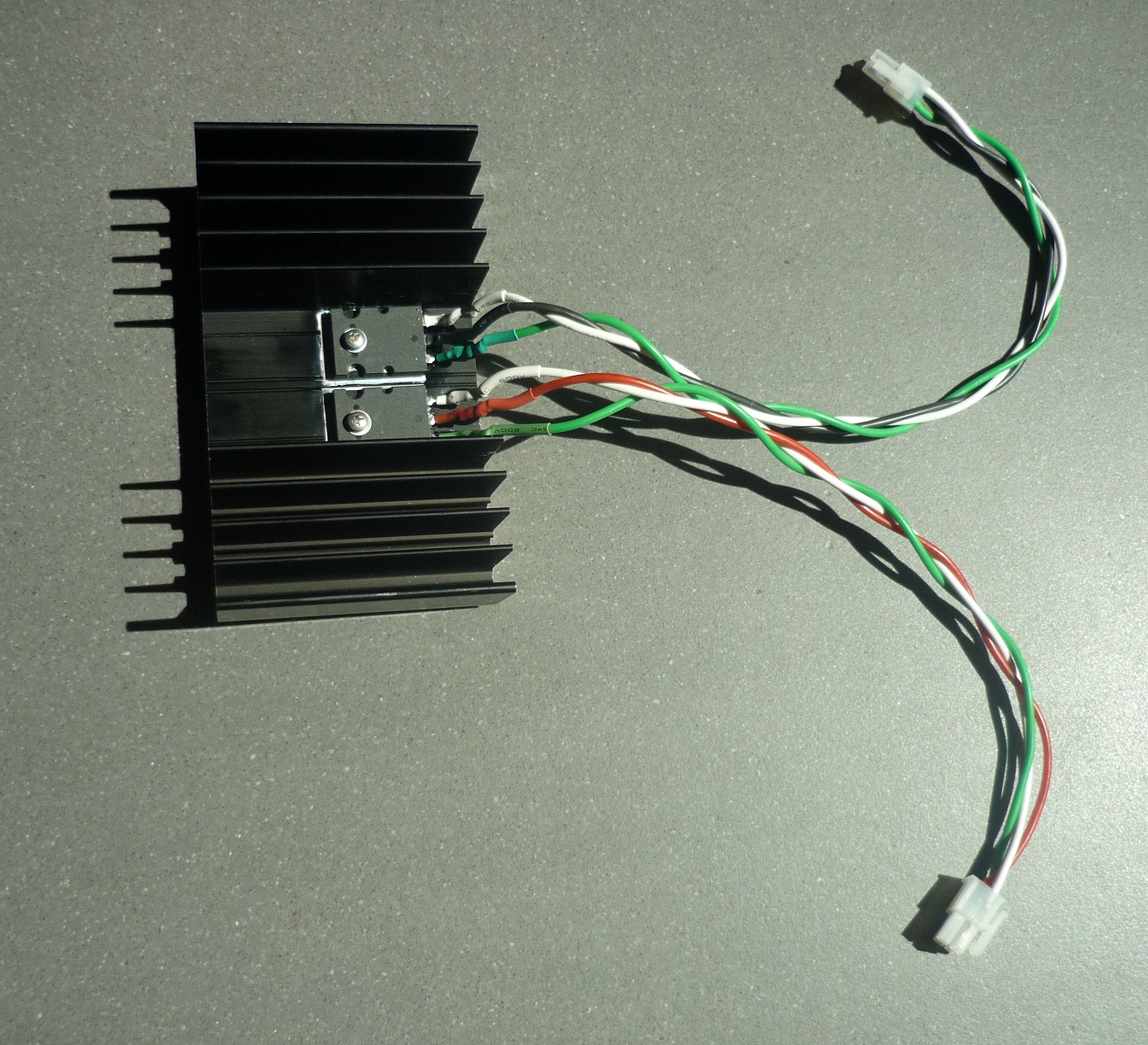

Yes, I had done the same thing with my SLB transistors (which are bolted to a heatsink).
See here:
https://www.diyaudio.com/forums/attachment.php?attachmentid=823827&stc=1&d=1583808373
Incidentally, I find it amusing that the supply transistors in the SLB are in much bigger package than the TO-3P which the AN MOSFETs come in! :D

As an addendum to my last post, testing continuity on some of my Snubber boards:
1. Yes, I get continuity between the 2 holes on the LHS of the square and pin2 (Drain)
2. I get continuity between the bottom right hole and pin3 (Source)
3. but I do not get continuity between the top right hole and pin1 (Gate)!
But, interestingly enough, I do get continuity between the rectangular pad in the top right corner of the Snubber board and pin1.
Shall I just drill a hole in this and use it for the wire for pin1?
Andy

Hi Andy,
If you look at the snubber board, you won’t get continuity between pin 1 and the rectangular pad on the corner unless the gate stopper resistor R101 is installed. Have you installed the resistor yet? You also need to install the C102 220pF and R102 47R snubber parts on the other locations. Plus the 12v zener diode V101. Pay careful attention to orientation of diode for N or P channel.
Please see markup of your photo. Green circles are holes for the Molex Minifit connector for 90deg connection to the MOSFET snubber board.
Blue rectangles are for parallel direct solder to the snubber like I did.
Red shoes G D S pin locations and corresponding pads.

Hi Andy,
Red shows G D S pin locations and corresponding pads.
823917d1583843527-alpha-nirvana-39w-8ohm-class-amp-abaf034a-4b3a-4ace-926e-cdec1322c5ee-jpeg
Thanks, X - of course ... silly me, I had forgotten about that 100ohm gate stopper resistor! :eek:
Not sure at this stage whether I will use those 4 holes for a Molex connector ... or solder the wires direct. As they'll be a Molex connector on the AN PCB end ... maybe one at each end of the wires is not a good idea?

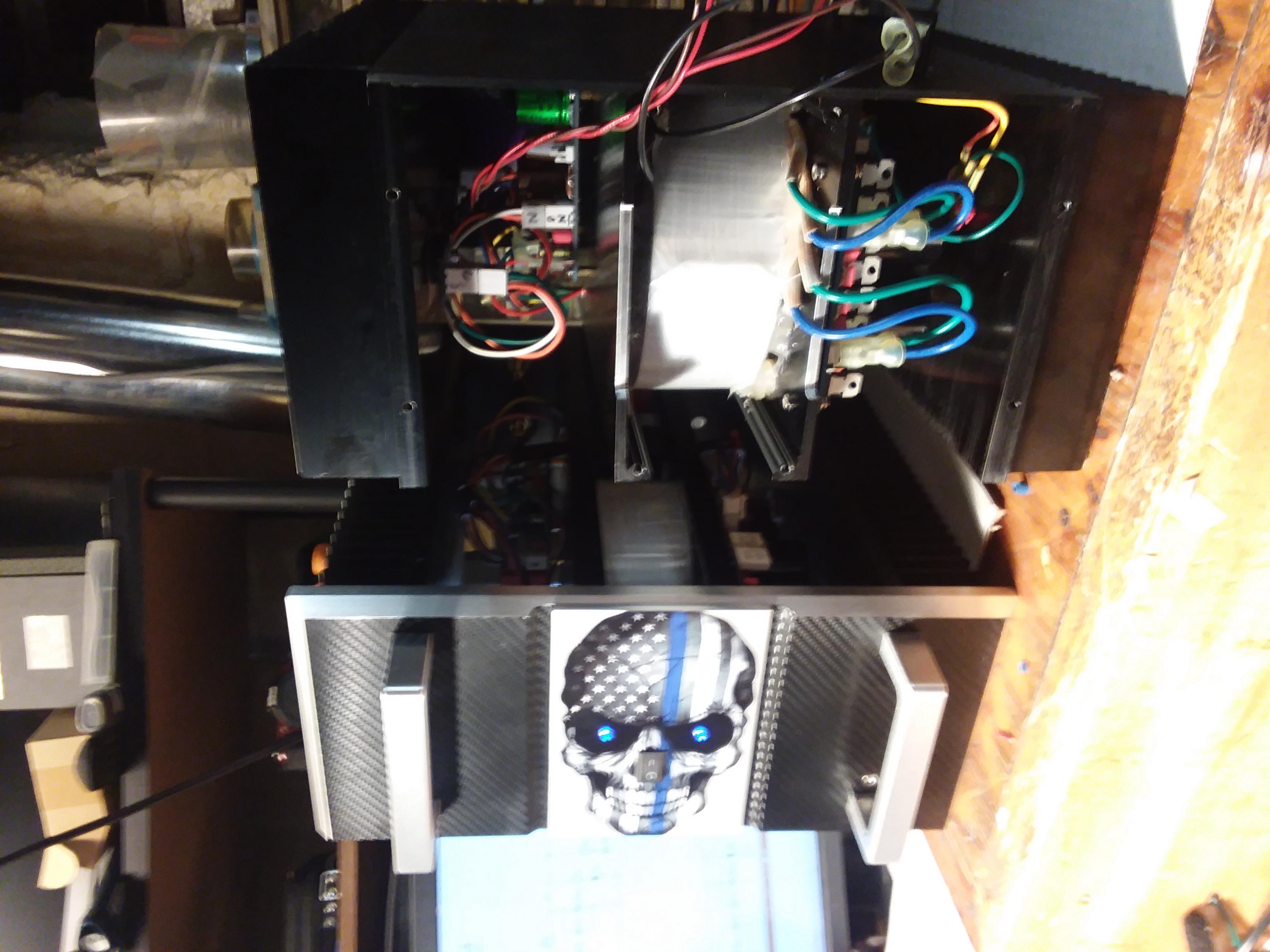

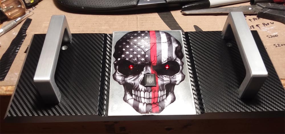

Red Skull (Right Channel)
About all that's left is to solder in the LEDs for the eyes and bolt all the covers.
The blue skull will be left channel and Red for right.
I have the M2X build done too, but haven't sourced a case. After that, it on to fishing!
