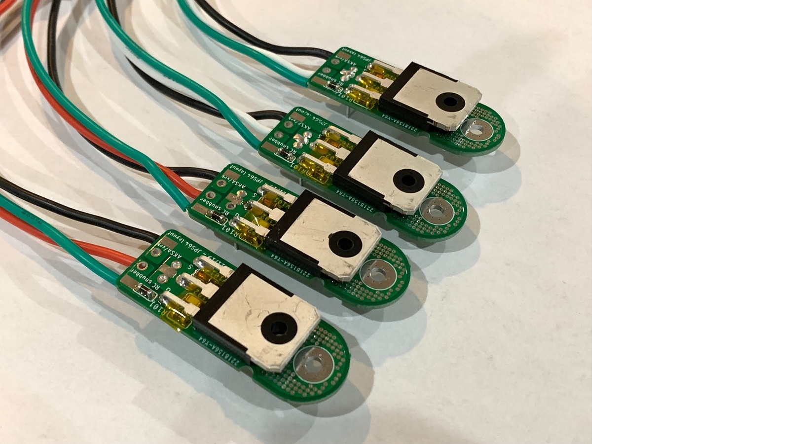

X, can you show me a pic of the reverse side of a set of these completed snubber boards? (See attached pic.)
I'm just wondering what implications there are in terms of the silicone wires connecting to the right-angled MOSFET pins - given I plan to clamp the MOSFETS (and the snubber boards) between a CPU cooler pad and a 1/4" aluminium support bracket.
Thanks,
Andy

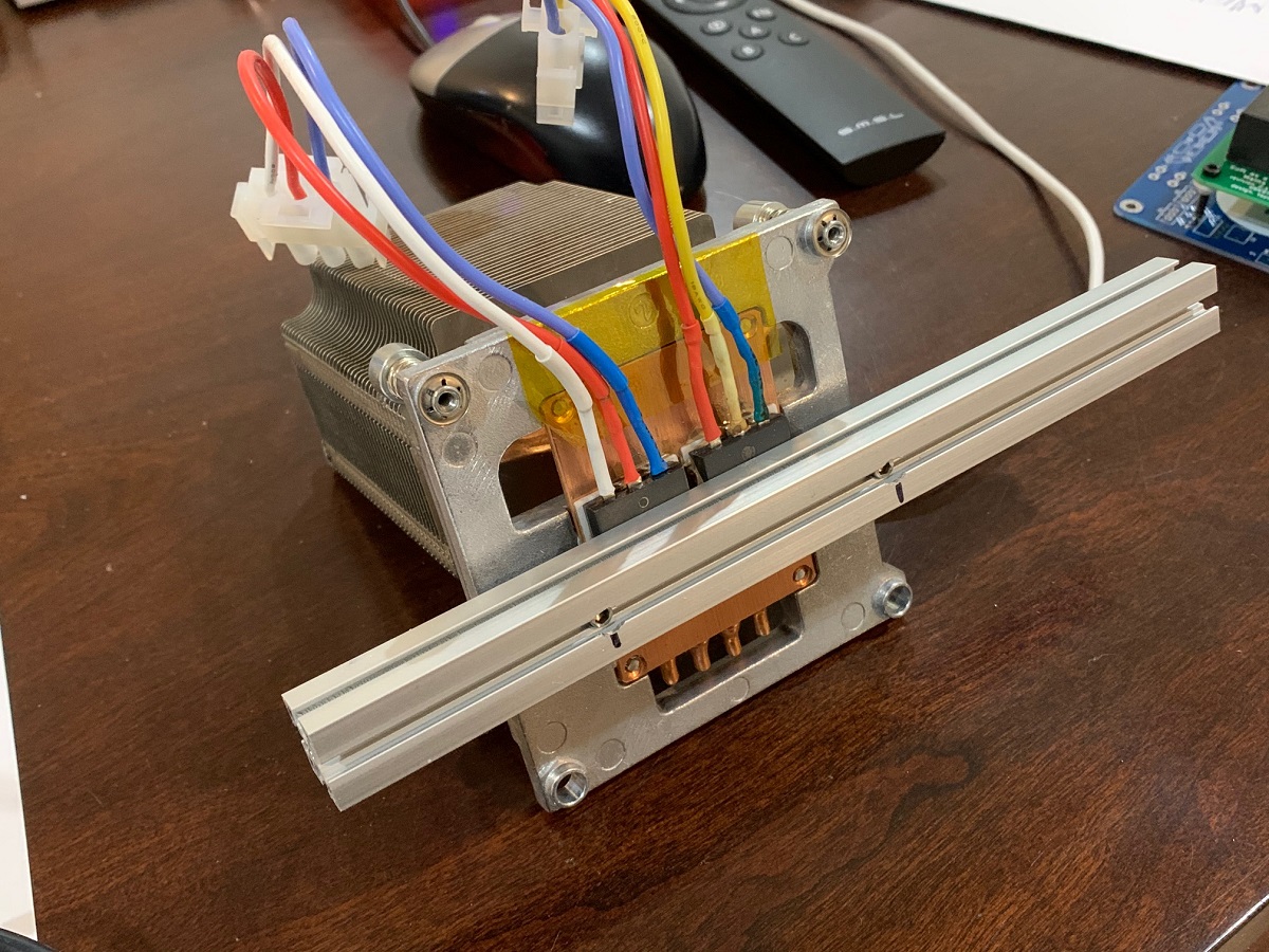

Sorry, I never took photos of the other side. It’s mounted in the chassis and all buttoned up now. Not much to say other that the wires are soldered onto the pads directly for the lowest profile connection to allow a clamp if needed. What you can do is use a clamp bar that is only 15mm wide and it won’t interfere with the pins at all. As an example, here is my recent clamp of a MOSFET and a BJT for the Glass Harmony. Using a 15mm square aluminum extrusion that is very stiff and has channels for mounting to other framework. This is using the MakerBeam brand extrusions for DIY robotics. Very handy stuff.
Although I did not use snubber boards here, you can imagine that they would fit perfectly well and not interfere. They would in fact, provide a much more even pressure distribution from the clamp bar to the MOSFET.
Here they are clamped to that really compact Dell CPU cooler (which, btw, Vunce has verified has no problem cooling 150w thermal load):

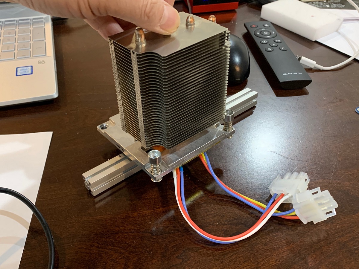

Here is the CPU cooler viewed from above:
attachment.php

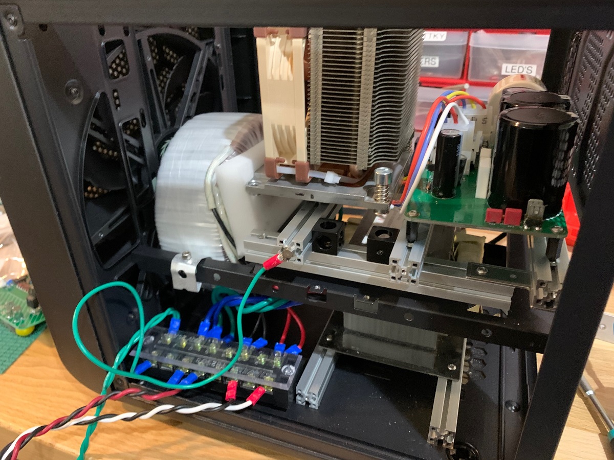

And here is the CPU cooler (with 90mm Noctua fan) mounted into a framework formed by the MakerBeam 15mm extrusions mounted inside a PC chassis. The chassis is a ThermalTake Core VI which is turning out to be an ideal monoblock chassis for CPU cooler based Class A amps, including the ABBB or any Alpha for that matter:
attachment.php

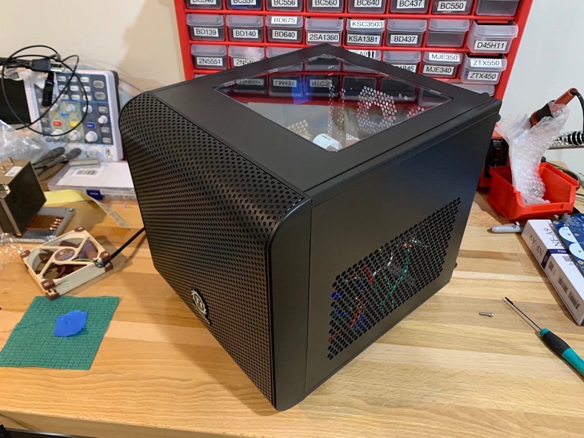

Here is what the monoblock chassis looks like all buttoned up, plain but very practical and compact. More importantly, because of its consumerism based PC-gaming heritage, cost is unbelievably low compared to any audio grade chassis you can imagine that will handle a 150w+ cooling load:
attachment.php
