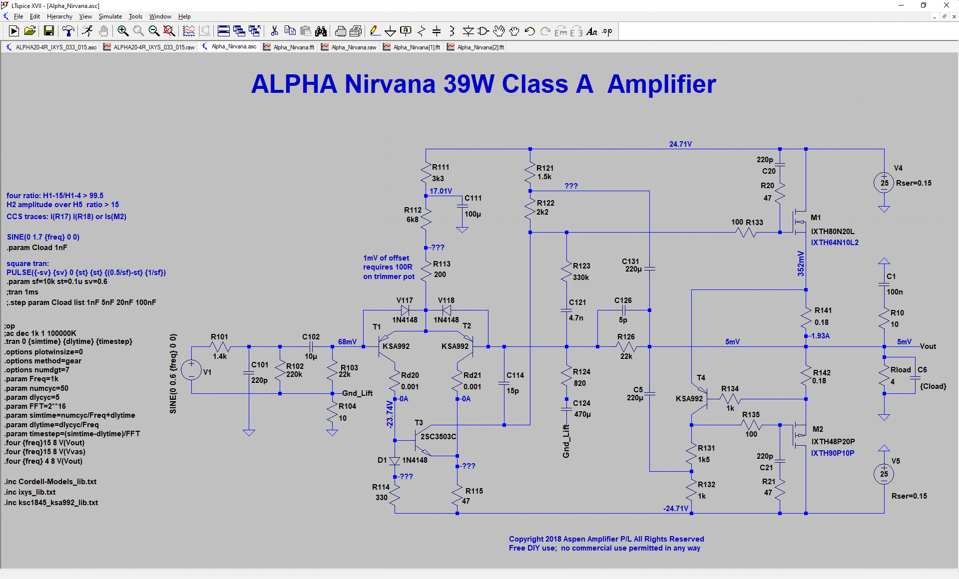

The Alpha4R that I'm listening now will be upgraded to the Nirvana.
I'll be using the same case and PS, so the change will be easy.
Since my PS is 25V I opted for the 8R version.
Of course I had to play a little in LTspice to see the outcome of putting a 4R load on the 8R Nirvana.
With normal bias at 1.65A and 15vpp the output currents I(R141) I(R142) are out of balance and the negative is clipping.
But when I augment the bias to 1.93A (0.18r) it's nicely balanced, no clipping with 15vpp and 4R.
So 1.93A seems a nice alternative.
Now I only need the blessing of Hugh or X 🙂
Danny

Quoting your colleague Sangram: .... it's a SE amp, operated in PP.
Hugh Dean, the designer: it's SRPP (series regulated push-pull).
Kokoriantz: it's SRPP....
Hi Danny,
I examined your schematic and you are almost there.......
If you reduce the two 0.18R source resistors to 0.15R each you will increase the quiescent to 2.3A. With 24V rails, you will dissipate 110.4W, but if you have enough cooling with your LARGE mosfets there will be no issue.
Add a 100p ceramic NPO of 47pF from base to collector of T4. This removes a glitch at MHz level when the transistor is coming off top clip.
You will then find that with 24V rails and 2.3A quiescent you can reach 36Vpp into a 4R load, which is no less than 40.5W and THD of 0.0413%!
I think you will be pleased with this........
Hugh
