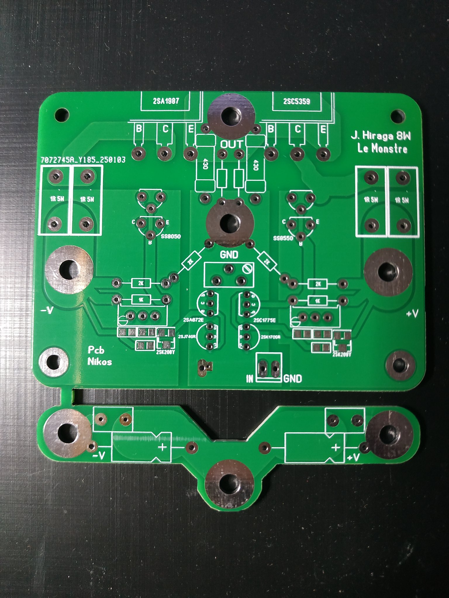

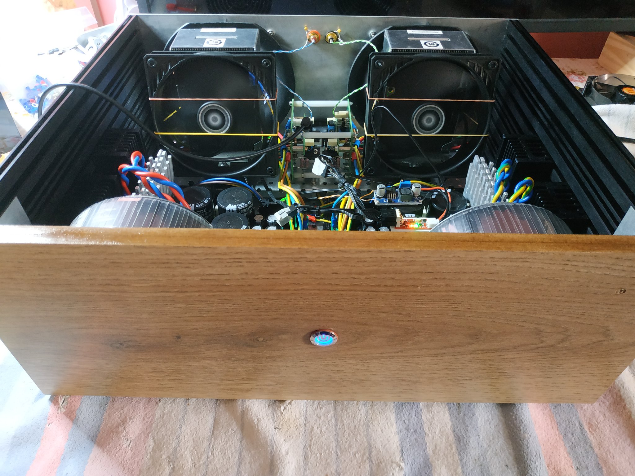

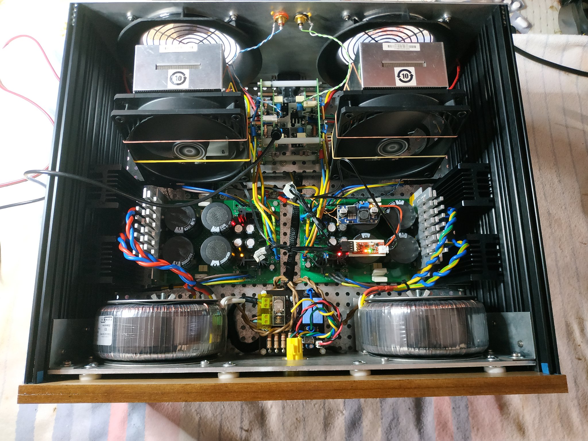

Here is my finished box front plate of AN39 .Now inside the Hiraga Le Monstre 4Ω version modules for listening.A rock steady amplifier at -/+ 24V bias 1.5A. +/- 1-2 mv offset. Very very transparency amplifier

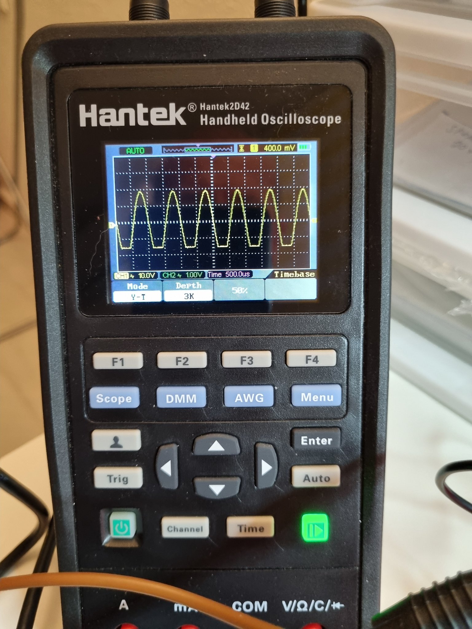

Why does such a defect occur at 14 volts at the output? The lower half-wave is cut off. Apparently I made a mistake somewhere. Current consumption is 1.34 amperes, supply voltage is +-26.5 volts. All components are in good condition.
