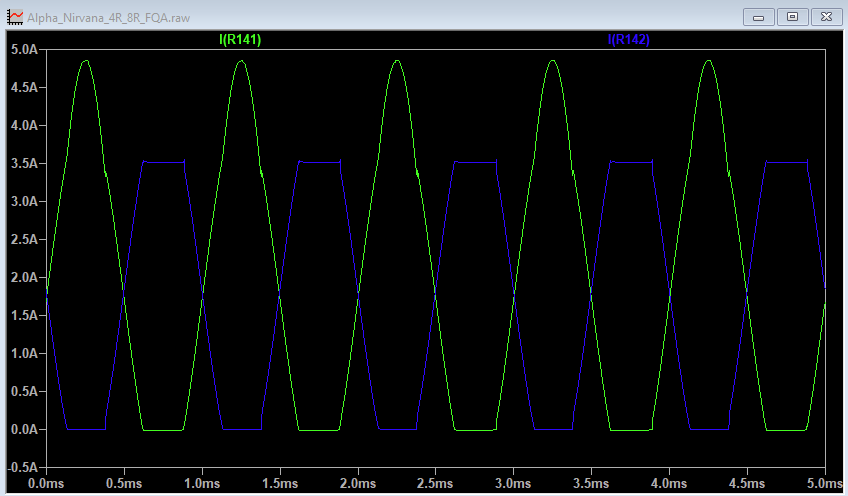

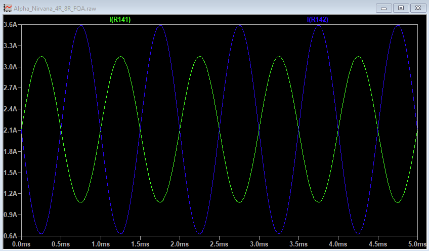

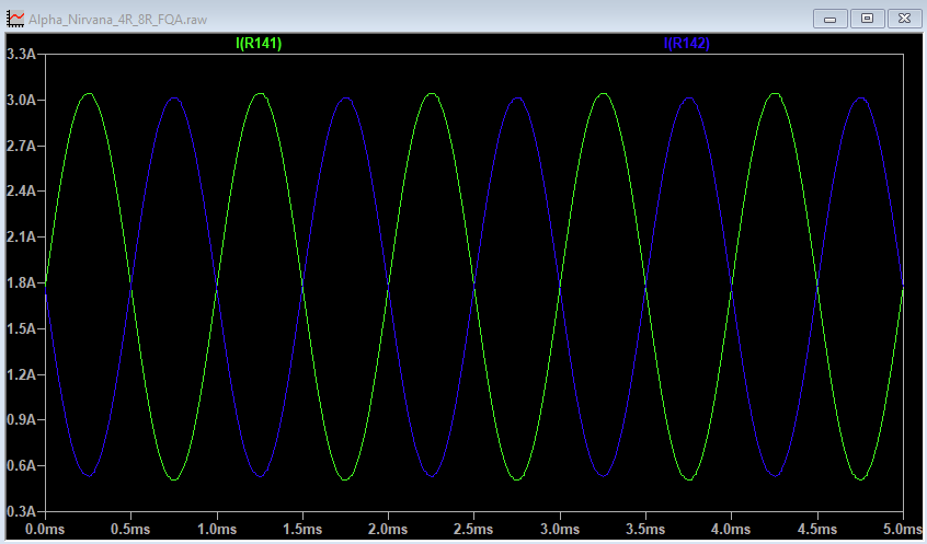

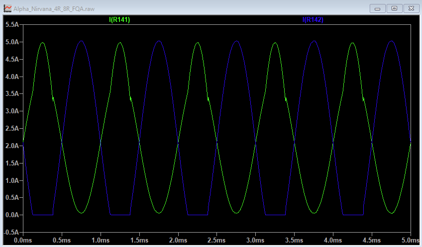

Here are some more sims like Hugh did, but at 20vp (40vpp)
Green is the current over N-channel
Blue the current over P-channel CCS
Original AN8R with 8R load
Original AN8R with 4R load, running out of current(clipping) on N and P-channel
New ANxR with 8R load
New ANxR with 4R load, only clipping of current on P-channel CCS

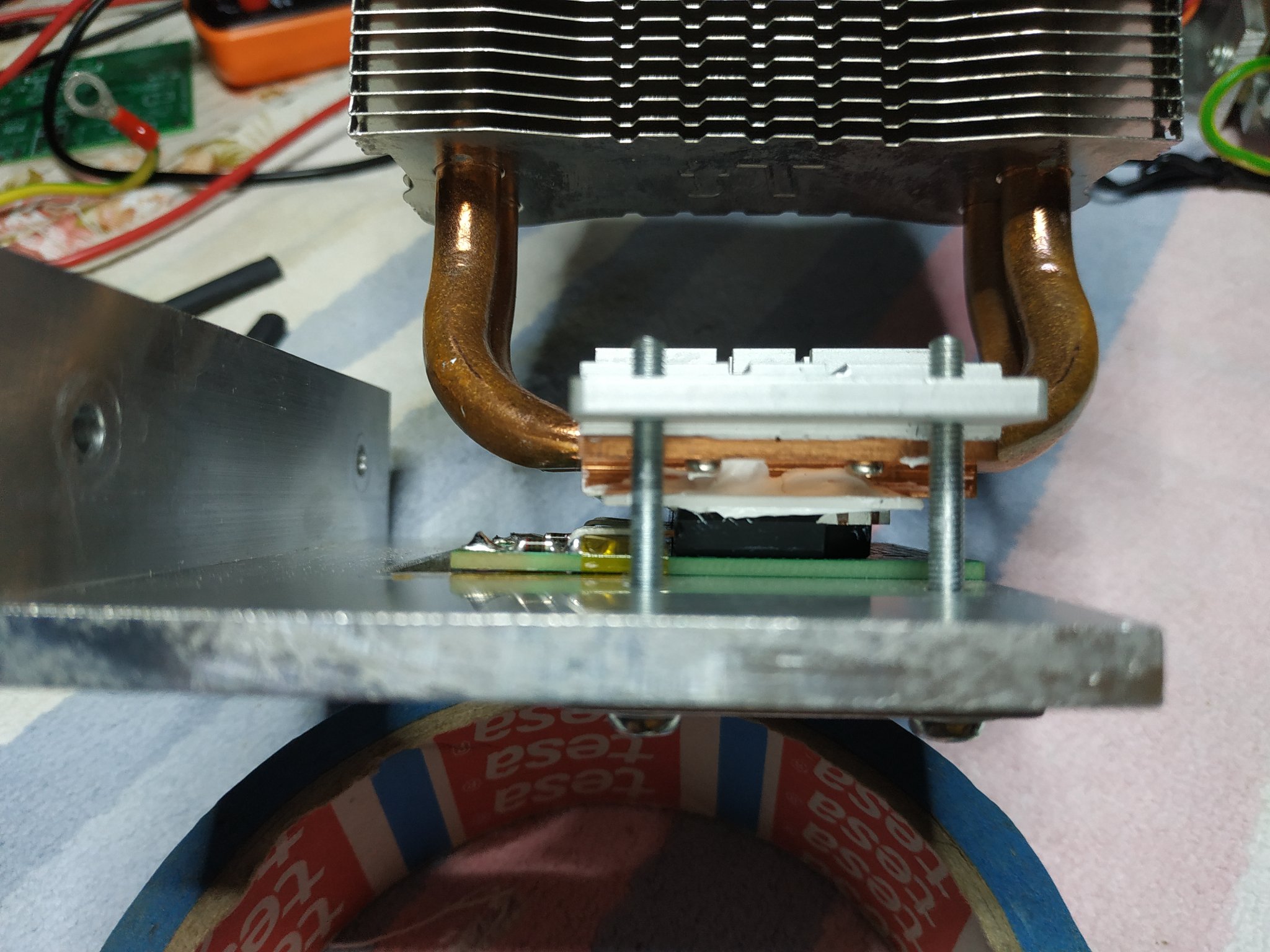

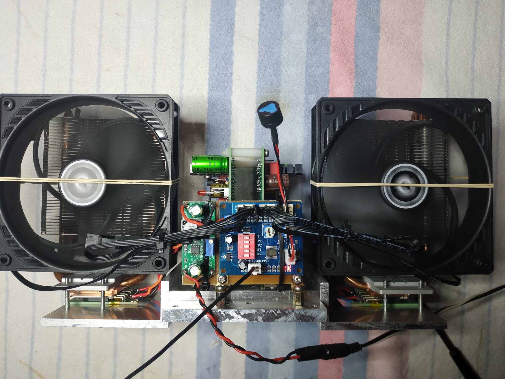

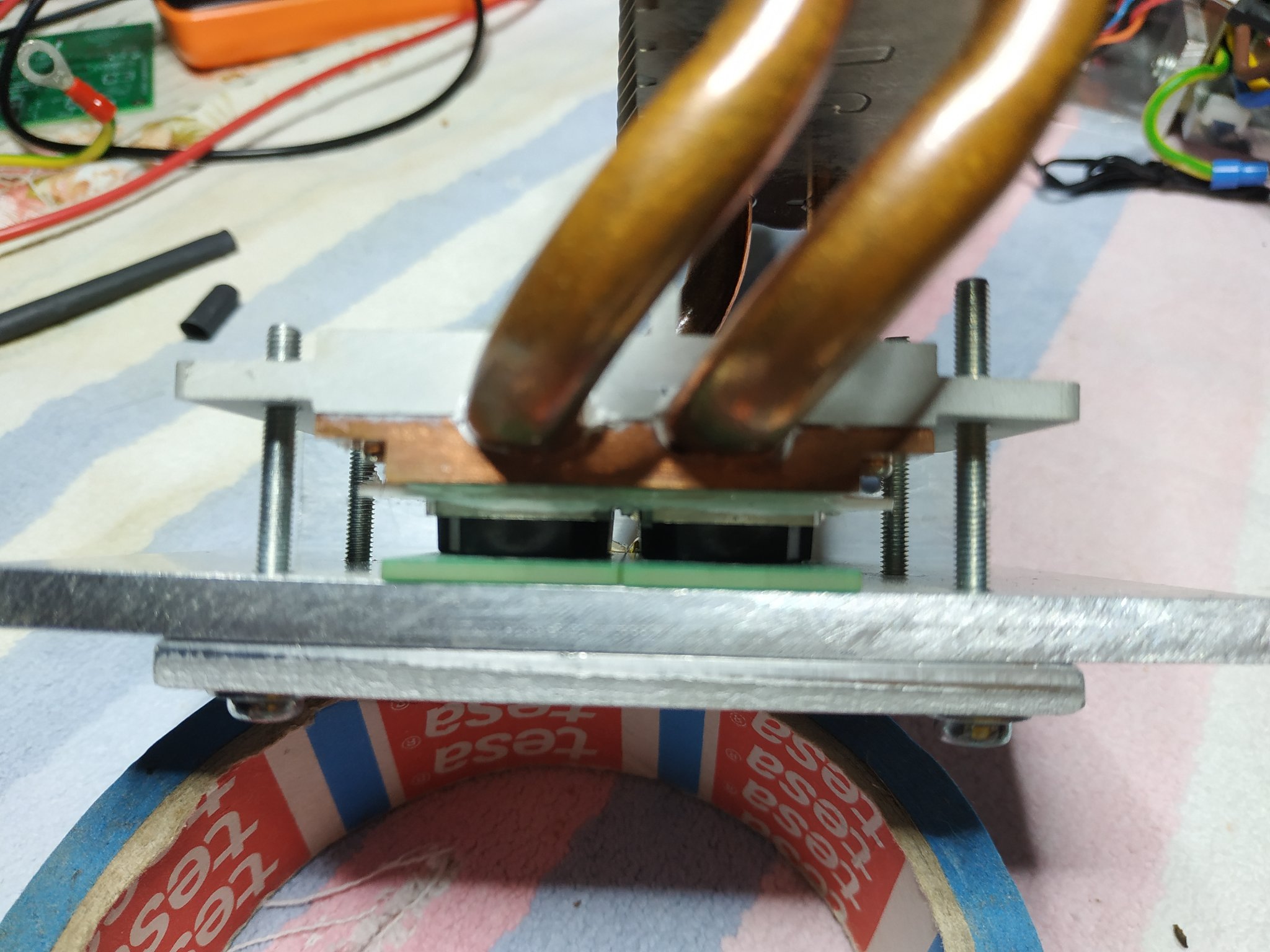

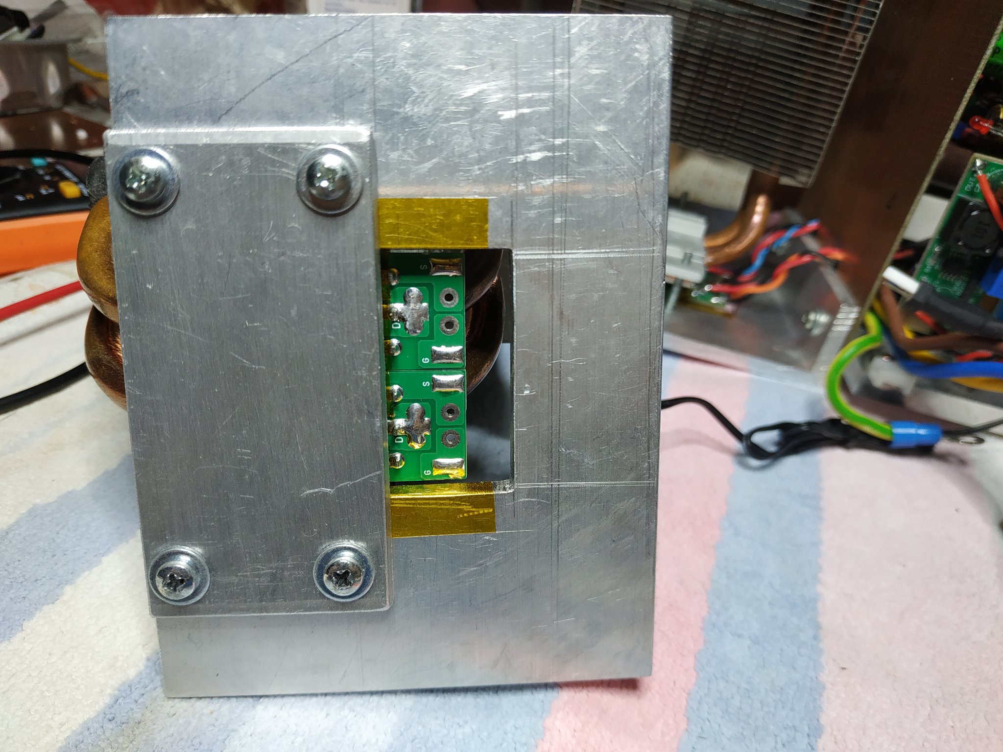

Hi Nikos,
Yes, at 2.6A it's even better, if you can handle the heat 😎
With 2.1A 2x25v 105w my 4U 400mm passive heatsinks are 25°c above room temperature.
I just listened to Daniel Pemberton - Escape From East Berlin
Never heard it this good, AN is really a very very good amplifier, excellent !
2.6A 2x 21.5V =111.8W piece of cake for CPU Fan 12cm P12 Arctic .Very very quiet, temp on cpu heatsink 44-47C, body 54-57C, room temp 30C.
