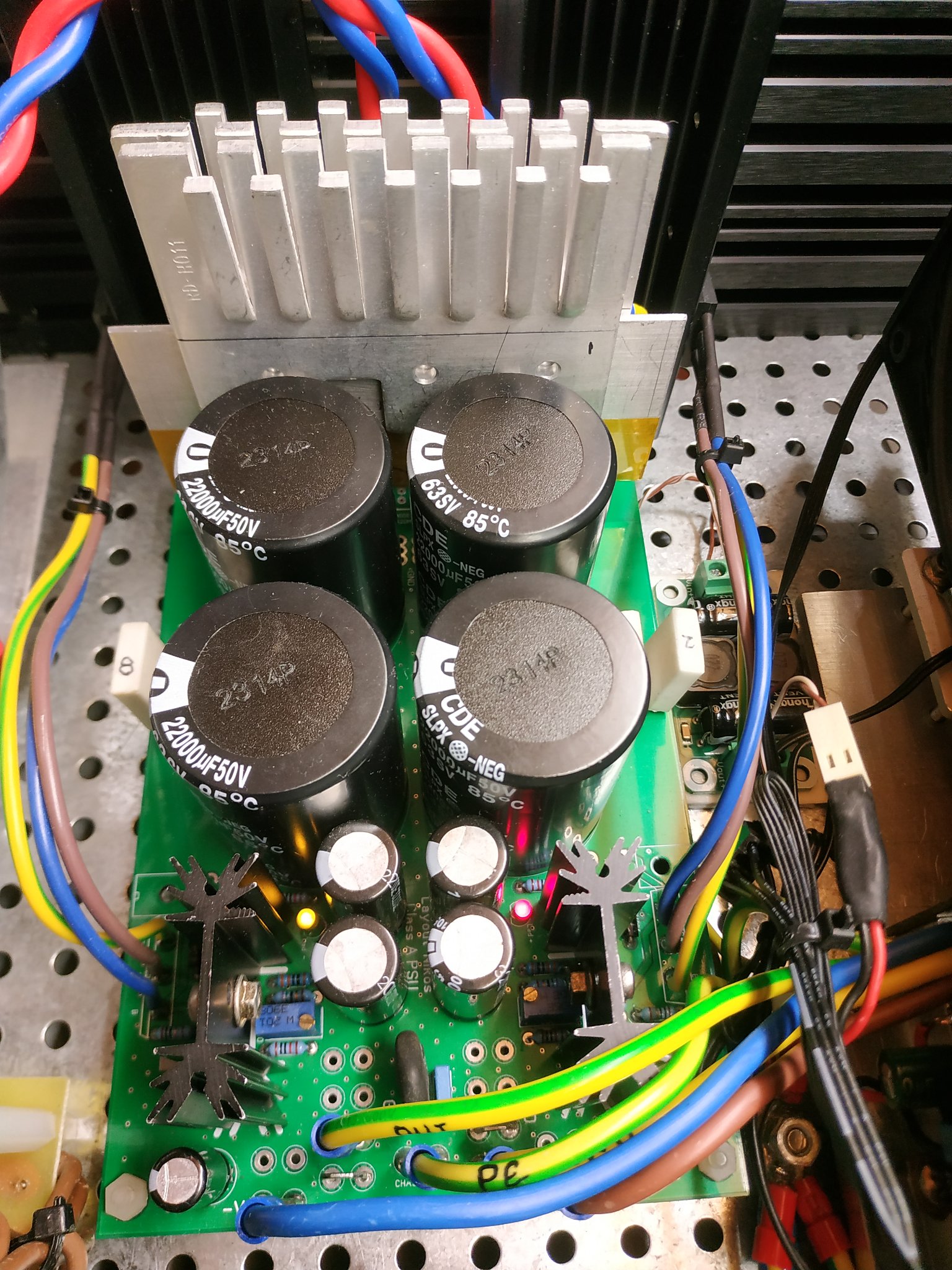

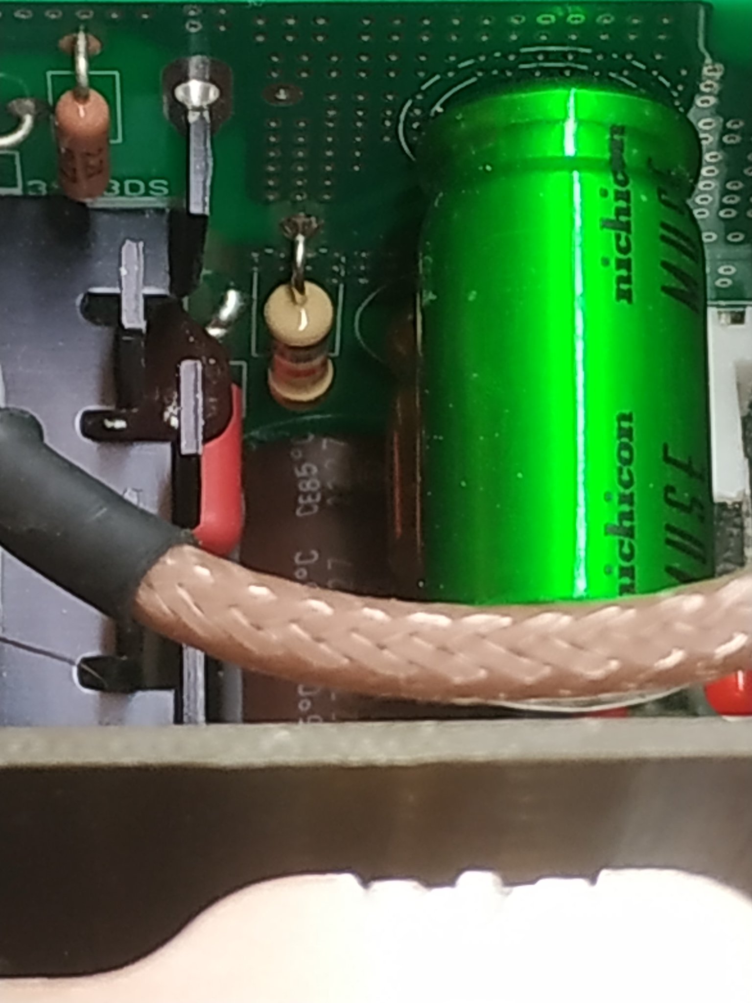

Today I finally changed the 820Ω carbon resistor in the gain with the 1.8kΩ carbon also.
And yes, I will really stay as is. Everything sounds better, voices and instruments.Without any sign of harshness, with enough detail in the voices, especially at high volume.
PSU +/-21.5V at 2.6A bias version 4R.

Hi Nikos, when you say carbon, you mean carbon film?
And what kind of resistor did you have before?
Regards
Regards
Yes carbon film....and before carbon film alsoHi Nikos, when you say carbon, you mean carbon film?
