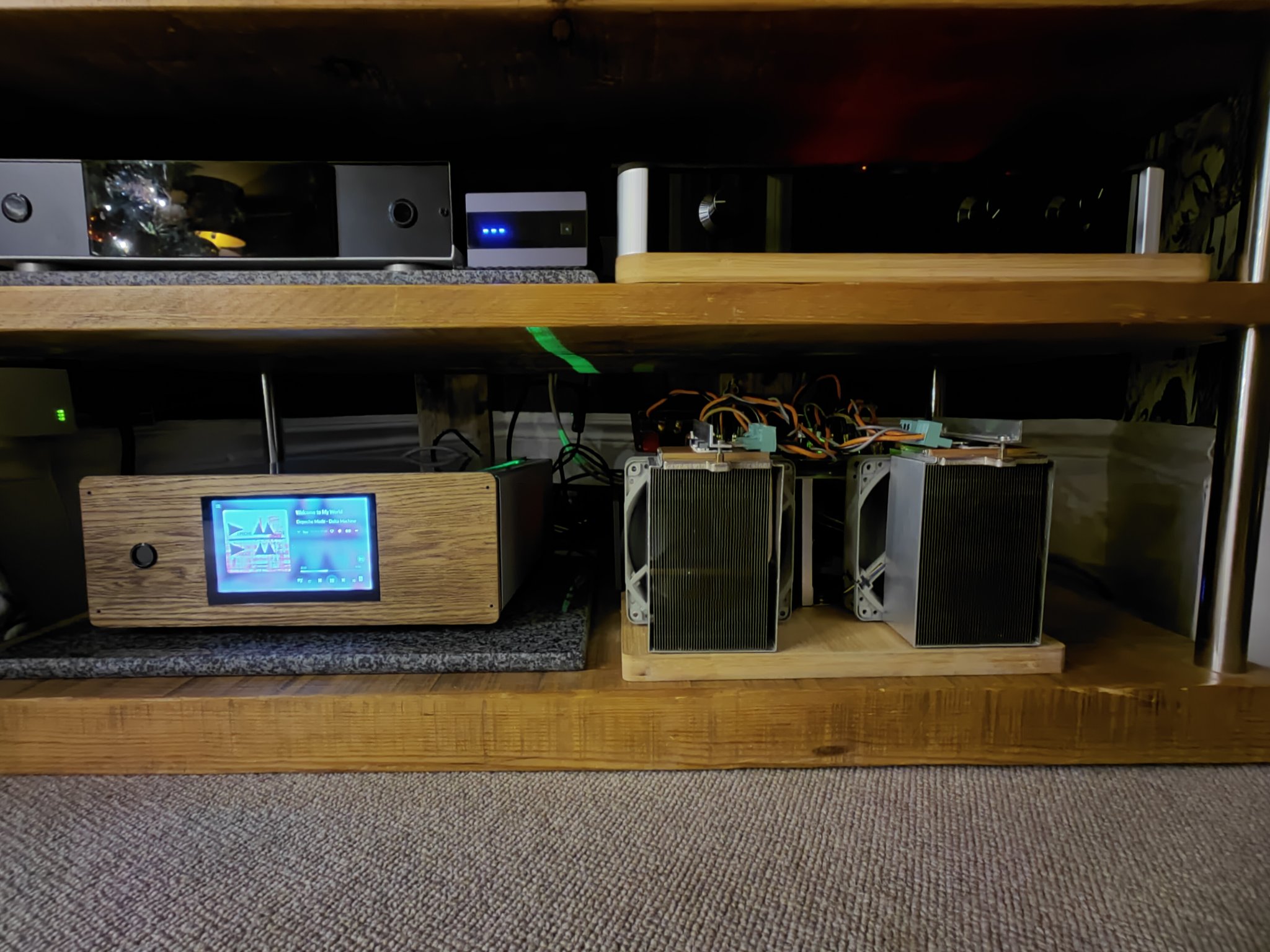

I agree with Hugh, those coolers should be very warm/Hot and the copper pad should be Hot pumping 100W into that sucker.
The ceramic insulator pads work great but you also need goop on both sides of the pads.
Are the original cooler spring/bolt removed from the cooler and replaced with standard fasteners for proper clamping pressure?

Yes I have goop on both sides. I'm using the original PC cooler springs. I thought it would be nice to use them . Thinking they'd exert decent pressure. Maybe they springs aren't enough for this application. Shall have a look over the weekend and maybe get some music out of it. Thanks Vunce and Hugh for your replies.
Hugh. Alas my weekend isn't the one I'd hoped for so apart from removing the spring loaded fixings from the clamps I haven't got much further. Hopefully this afternoon shall provide me some more free time. One thing I've noticed/overlooked is my aluminium slab is marginal as a heatsink for the CapMx MOSFETs!

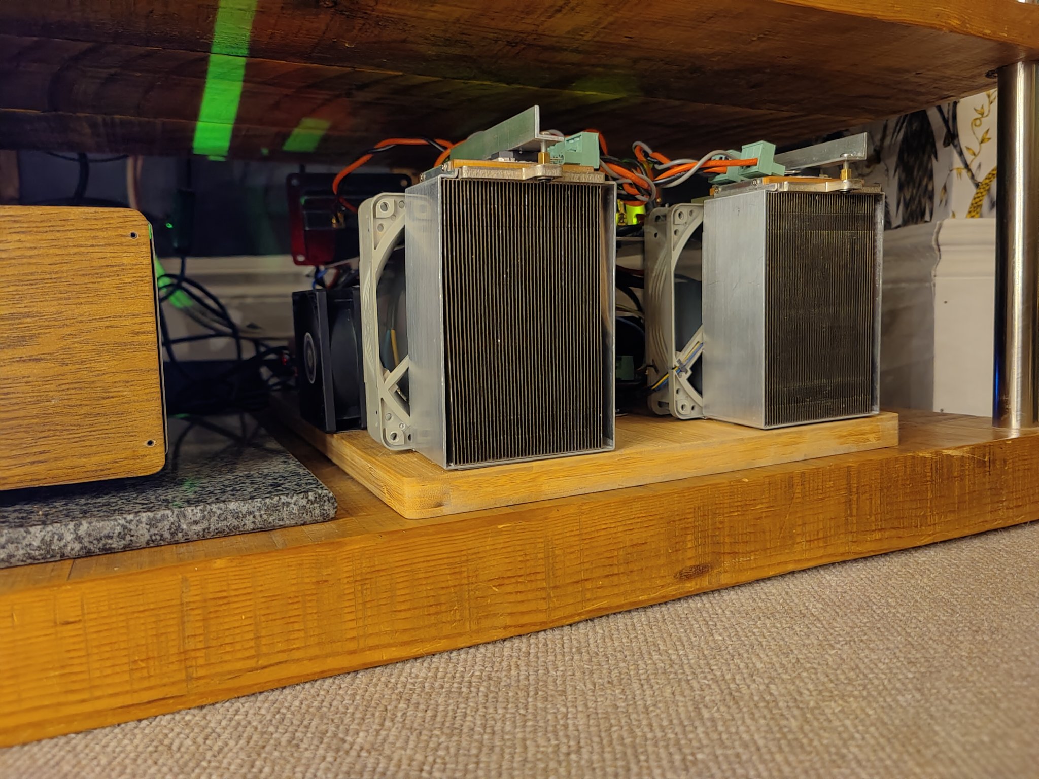

So I've changed out the spring clamping system for plain screw down. Redid the goop and I now have consistent temperatures, but the sinks are still warm only. The metal tabs of the MOSFETs are about 50c with a k probe. The copper right next to them is 15C cooler. So I seem to be not getting the heat transfer even with ceramic and goo. Might try some 'soft' isolation pads incase there is something out of flat. Or maybe the coolers are so efficient they are just getting the energy out of the copper very well.
Edit.....I unplugged the fans and within maybe 30secs the copper pads were temp equilibrium with the MOSFETs, and fans back on soon cooles down. I just think these coolers with the fans on even very slow are very efficient. I'm no heat engineer but this is all very interesting.

Congratulations! 50C on the metal side of the mosfet is fine.
I'm pretty sure you have 750mV across the two source resistors (check this), so to set idle quiescent the relationship is 0.750/(2x0.1)=3.75A.
If anything, for a 4R AN this is more than enough.
HD
