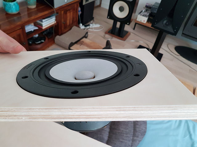

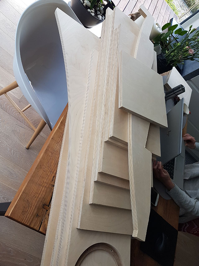

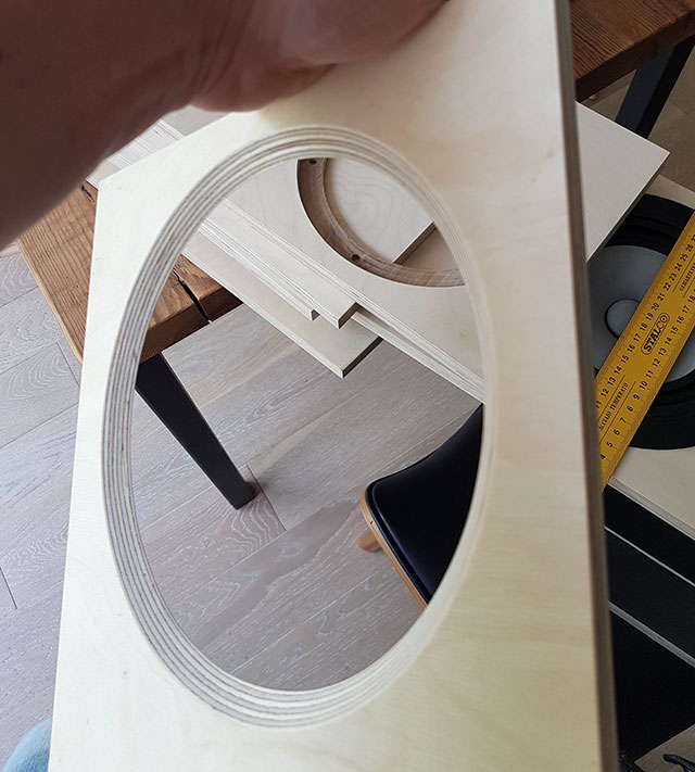

Now is my turn I have got all the plywood parts... but... word of caution...

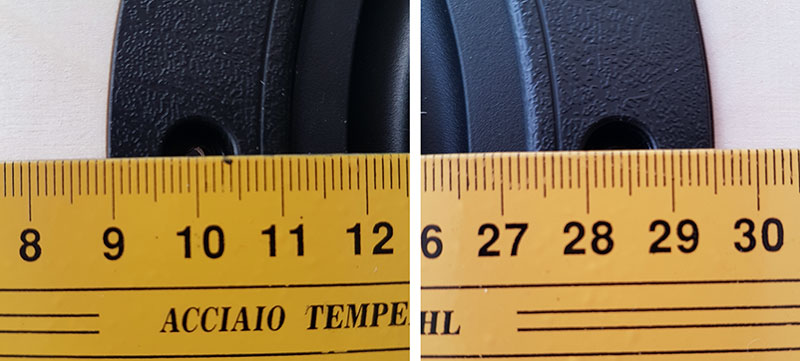

On the driver drawings that are available online the distance between the middles of the mounting holes is Ø185.7mm, I trusted this value and now have a problem because the measured value is about Ø183.5mm. I need to fix the fronts now.

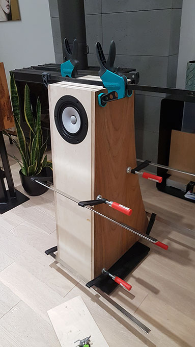

I did some progress:

Just sharing a picture of mine painted purple
Nice looking legs Sodacose, I'd have use them if I had a carpet

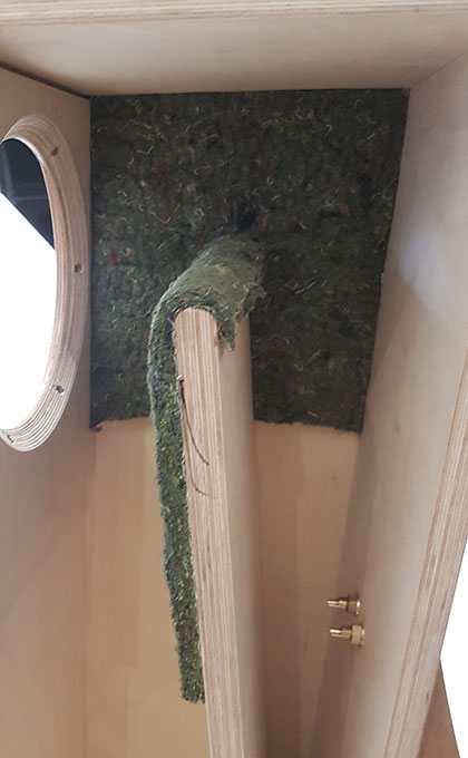

I did the same for the lining, all interior surfaces behind the driver except the back of the baffle. The last side I sprayed and added material after everything was glued up.
I used polyfill (pillow) to stuff and just added to the closed folded section of the horn, following the instructions for a regular frugal horn.
Regarding the linning I did something like that, noting on the top wall and on the back (apart from poly).
Some felt on the inside top and back is suggestted.
OK, I'm going to add the two missing linings, thanks for the hint

Thanks for that, I have added the missing lining, removed polyfill from the front chamber, left 170g in the rear one, and the sound popped out, there is more clarity, "sharpness".
