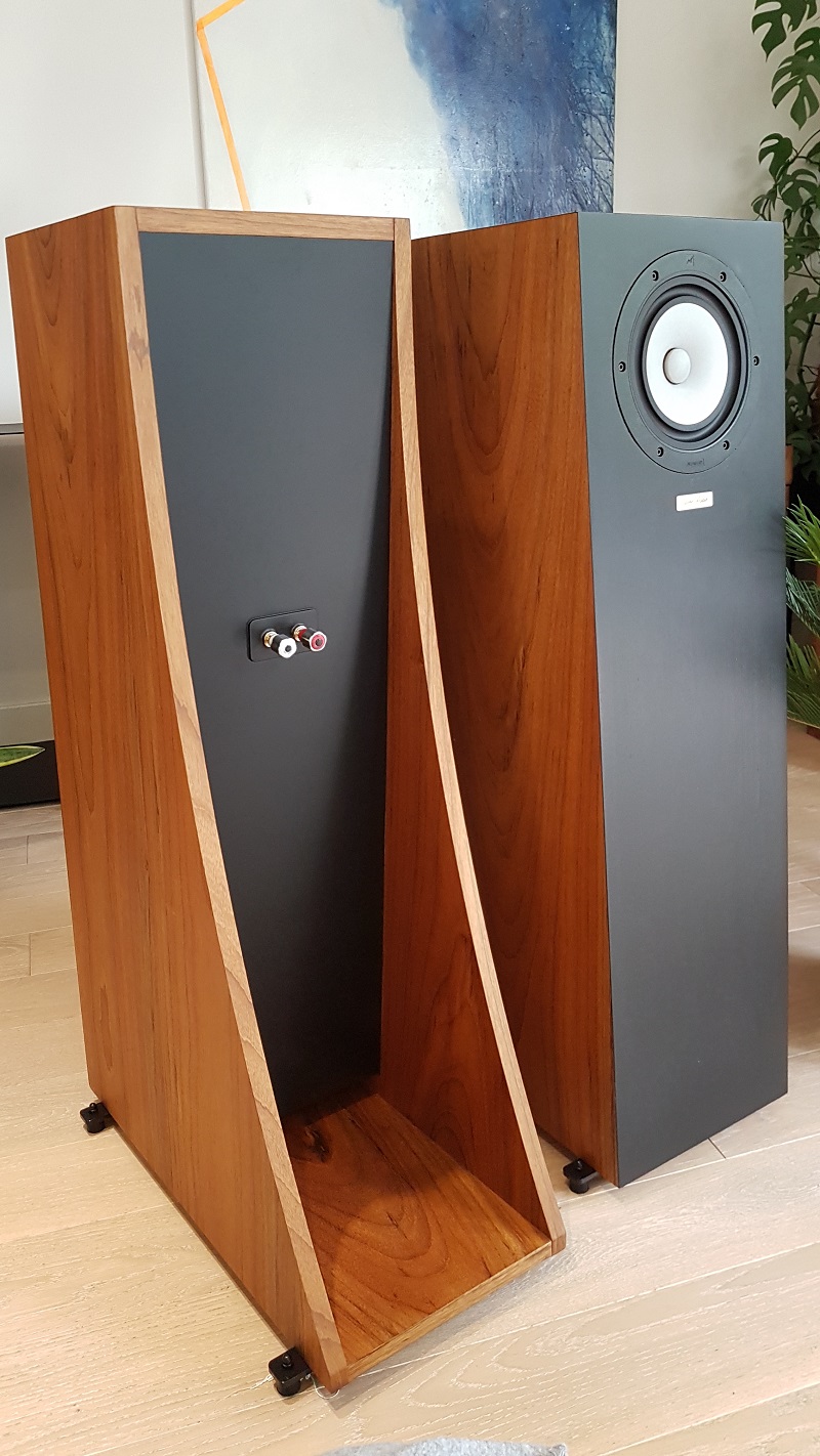

I have completely removed the poly and listened to the speakers.
I was expecting a really boomy effect... but no, it was a stronger bottom comparing to 85g (front) + 85g (rear "V" section) but it wasn't as noticeable difference as I expected.
I prepared 40g of poly (as I found in description of FH mk3) but it's not enough to properly fill in the "V" section without having empty areas.
I think I will end up with 60g in "V" and only 30g in the front. Hope I won't regret that after gluing in the last element.

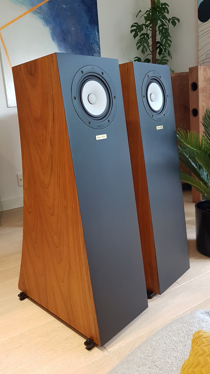

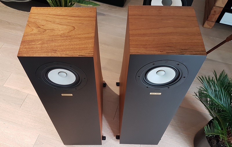

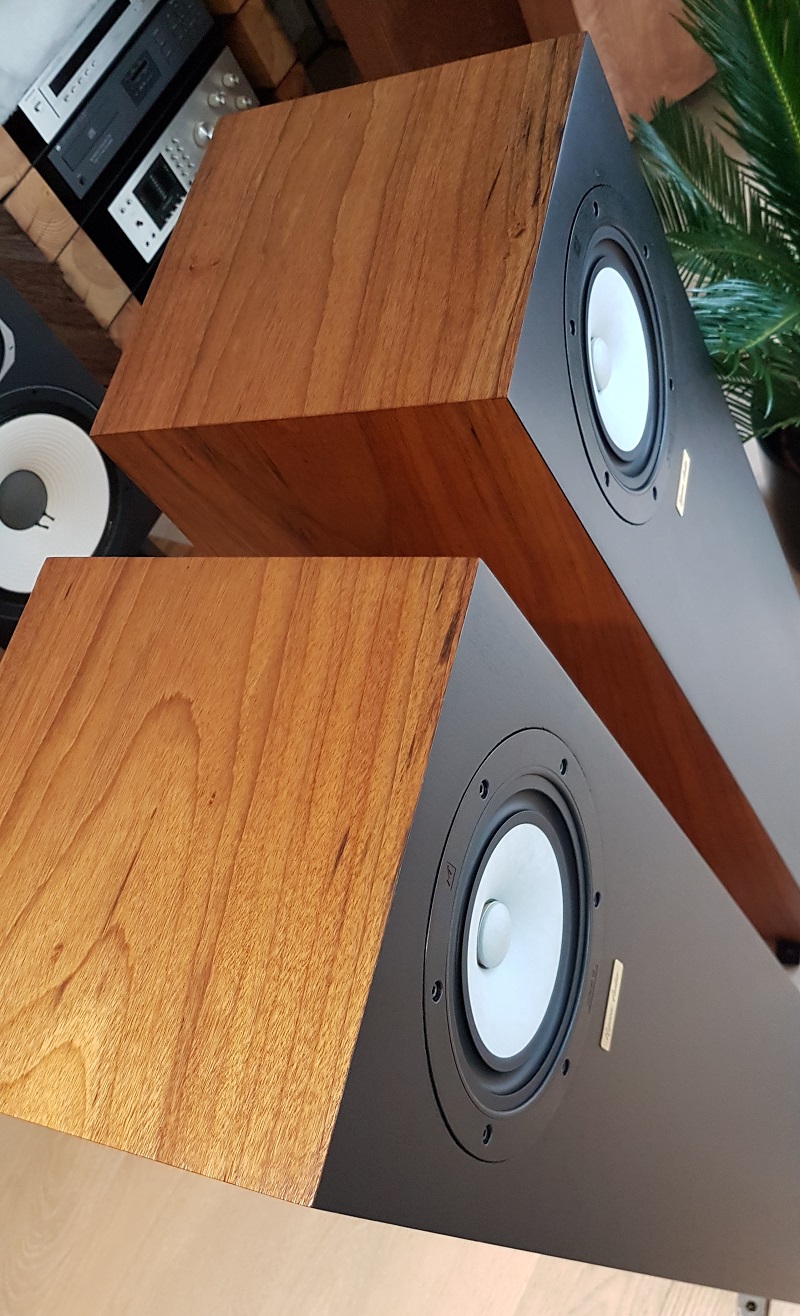

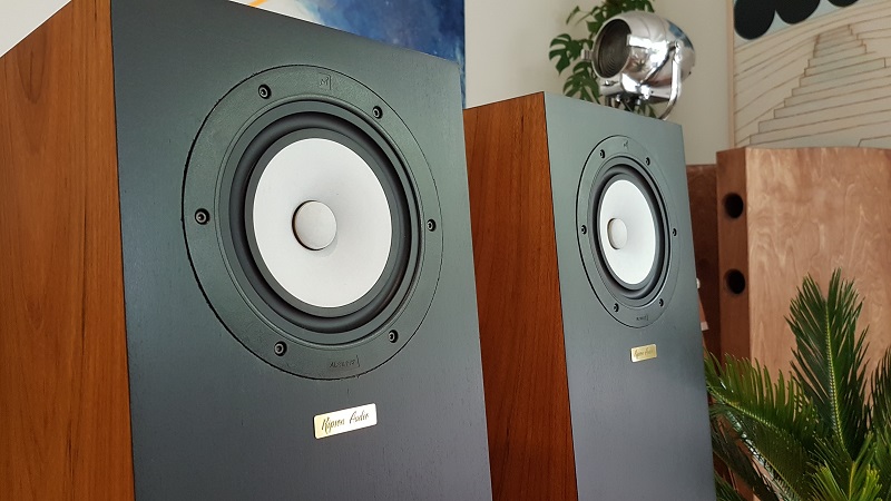

Completed!
Thank you guys for your help.
Thank you, guys 🙂
Wow, that looks great Ripson. Did you veneer the sides and top or is that all mitered?
It's not mitered, unfortunately. I asked a carpenter to veneer the sides and bottom (before gluing) using a press.
When the cabinets were ready I leveled the surfaces with an eccentric disc sander, I glued the veneer myself on the front, bottom, and top using two layers of wood glue (dried) and iron. Not as good as using press but still OK 🙂

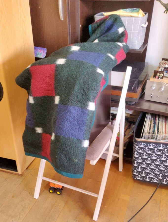

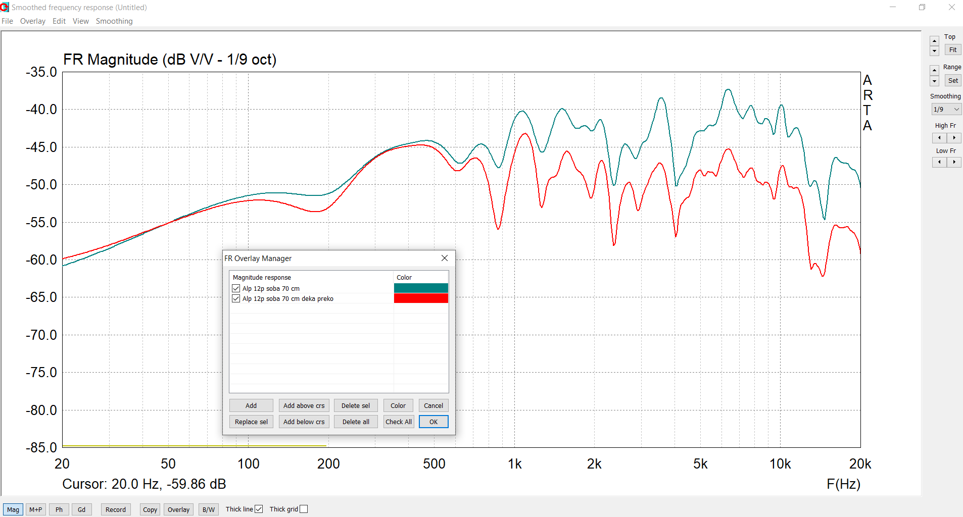

yes, you are right 9 years, not 11... the first one 12p.. but out of balance totally. every few years i build one box for it, big , smell, medium, no luck all the time i heard this shrill sound.. RLC filters in front didnt helped too much.. after i get measurement system i see where is the problem.. after eq'-ing with the blanket became somehow listenable 🙂
but i have many other speakers at home, they no need any side effort to sound good from the first time. i was fooled here with 100.000h of break in time stated in the manual 😱 no any change after years

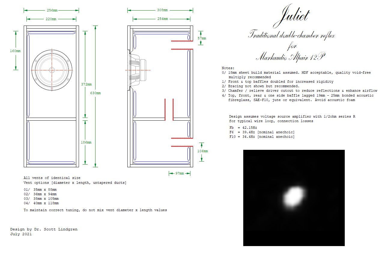

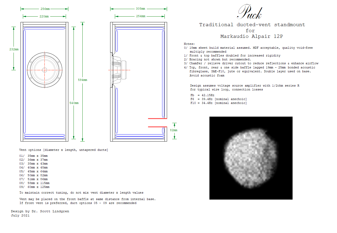

Since we're on the 12P, here are a couple from my Moon series, which I've probably posted elsewhere, but might as well lurk here also, since it's one of my favourite MA units. Probably my personal favourite to be honest -not quite a jack-of-all-trades, but I like the cone area and the fact that it takes off like a stabbed rat (in relative terms).
Traditional alignments which a couple here will probably recognise 😉 but may not be familiar to everybody. To forestall the inevitable queries:
-Yes, it is deliberate, and yes, they work quite well
-Yes, you can use them with a higher output impedance amplifier
-No, it's not necessary to use them with a higher output impedance amplifier if they are boundary-loaded in smaller spaces
-Yes, if you want a box created using pure T/S derivation, there are alternatives. Name your poison, ladies and gentlemen. 😀 Christopher Lee sings "Name Your Poison" - YouTube
