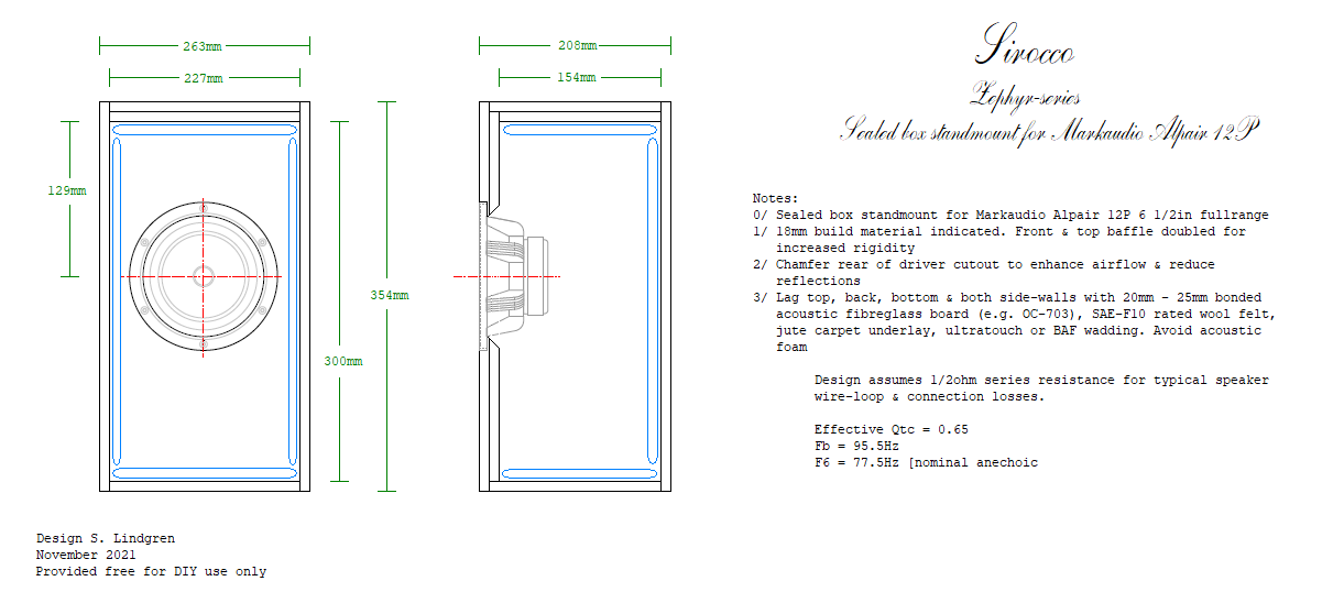

Since there has been some interest in the 12P, I've done a bit of work in my spare time. Nothing 'new' as such, but one of those things that is often stated you should never do. Except it's not really true. So a small series of 3 sealed boxes attached
A few notes:
The Alpair 12P is a lower Q drive unit with an Fs in the low 40Hz regions. So as-is, with a regular voltage-source amplifier, it has relatively limited usable LF extension in a sealed box, as you would expect, even when we account for typical wire-loop & connection resistance. The first of these boxes (Sirocco) below assumes those conditions, with a nominal Qtc of 0.65.

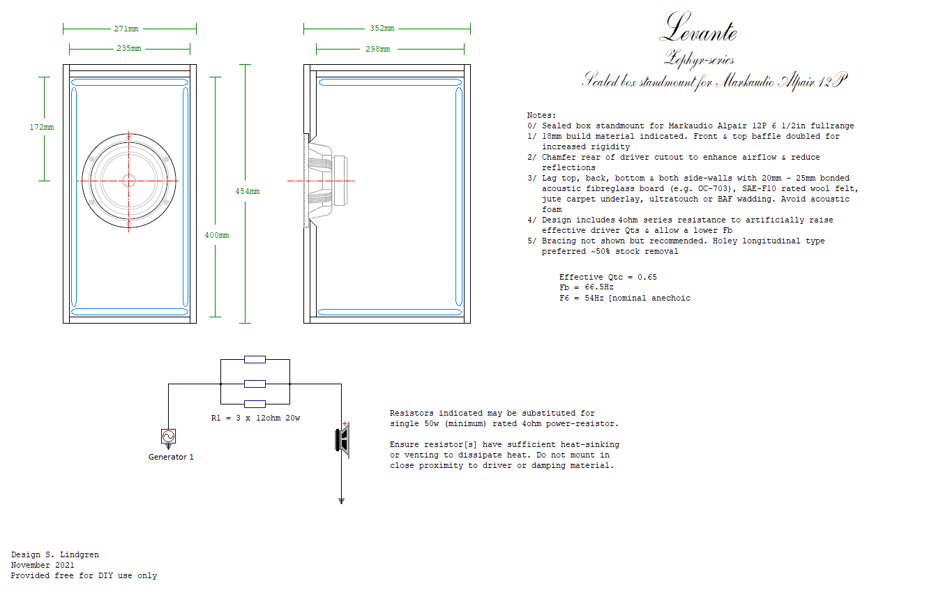

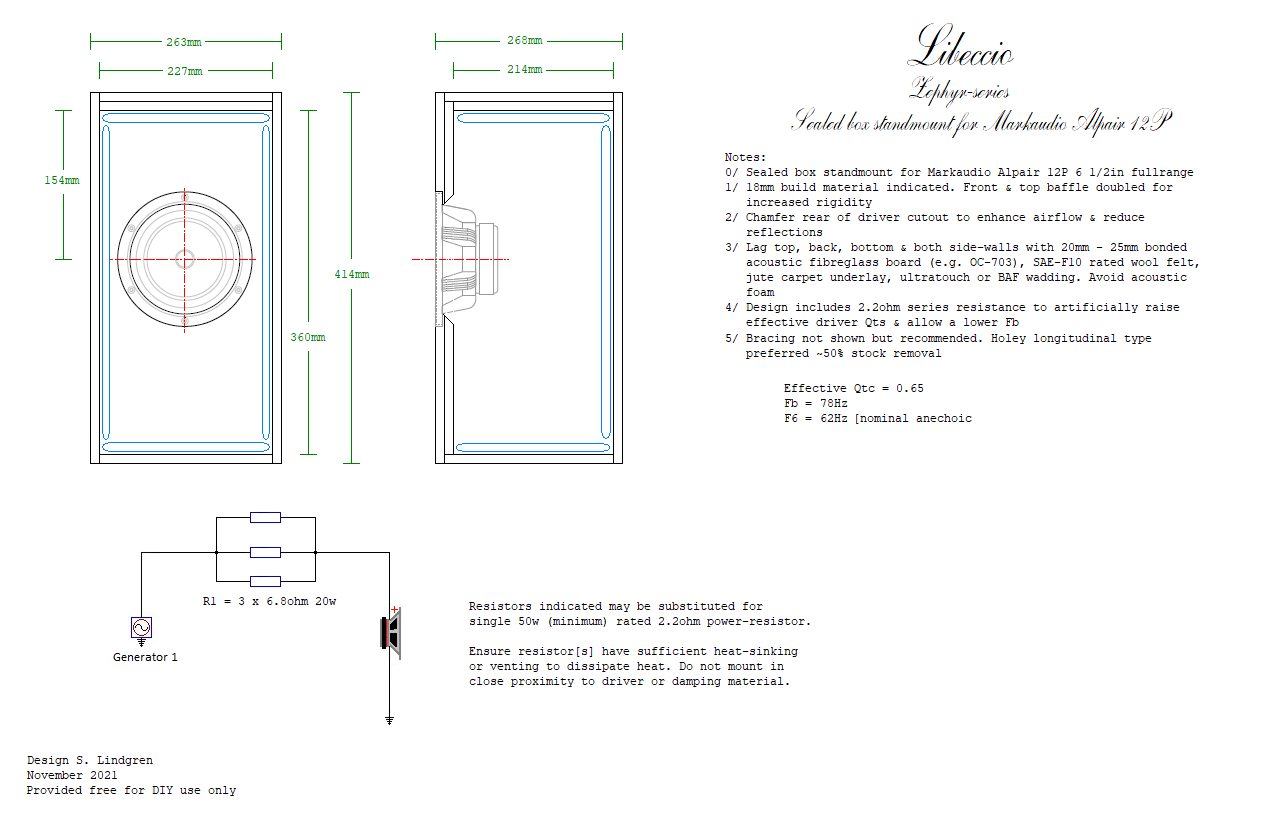

The second and third boxes (Libeccio and Levante) are larger, and aim for the same Qtc. They also assume conventional voltage-source amplification, and use series resistors to artificially raise the effective Qts, and thereby allow the driver to be used in a larger volume to provide a lower Fb. The price of this is reduced system efficiency & sensitivity. The resistors will inevitably get quite hot, so good heat-sinking and / or ventilation is necessary: this is noted in the sketches, and I stress it here.
If you have an amplifier of suitable output impedance (approximately 2.2ohms and 4ohms, respectively, for Libeccio and Levante), then you can dispense with the series resistors, but not otherwise, or the box alignment will be over-damped with little usable LF output.
