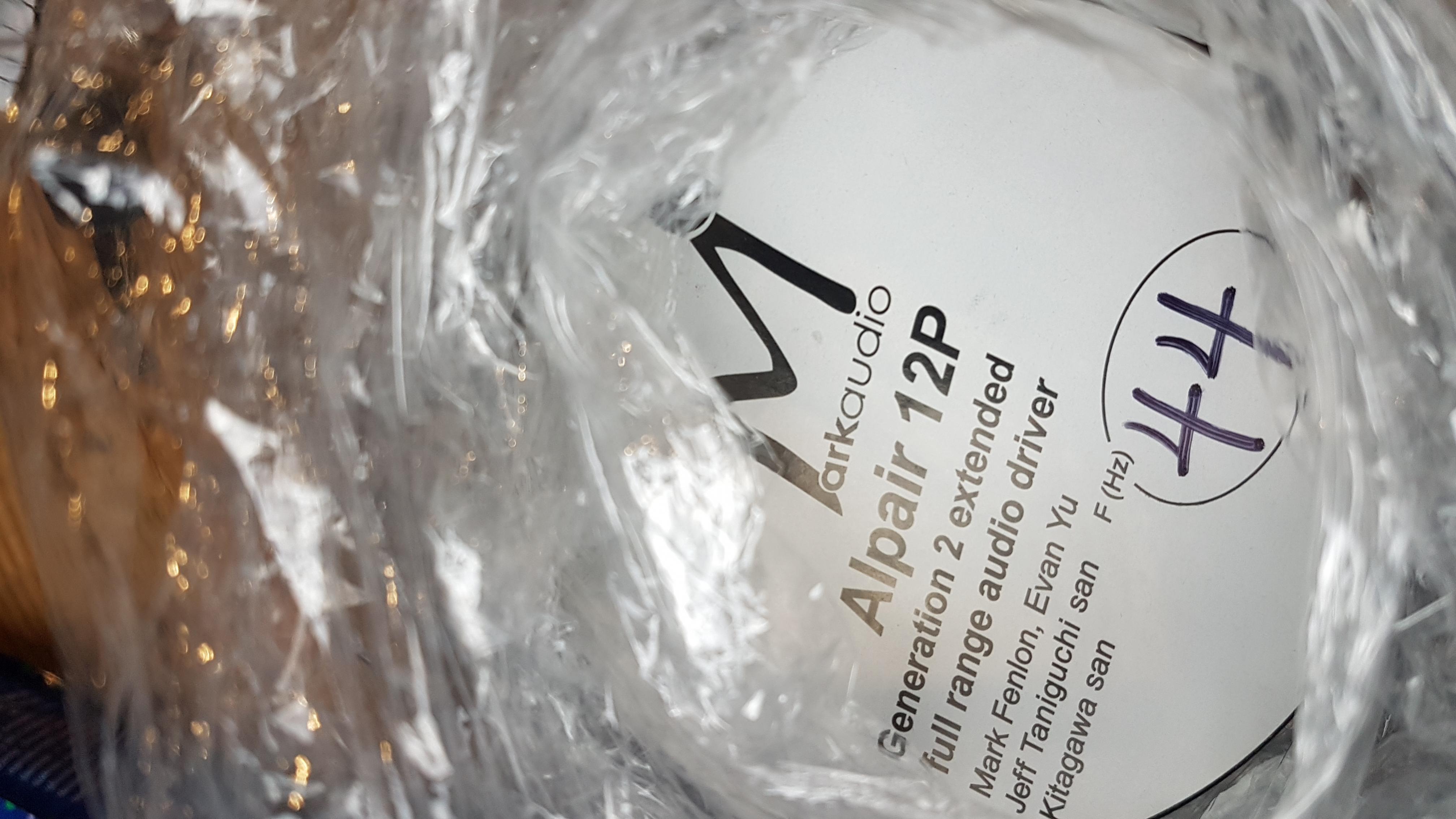

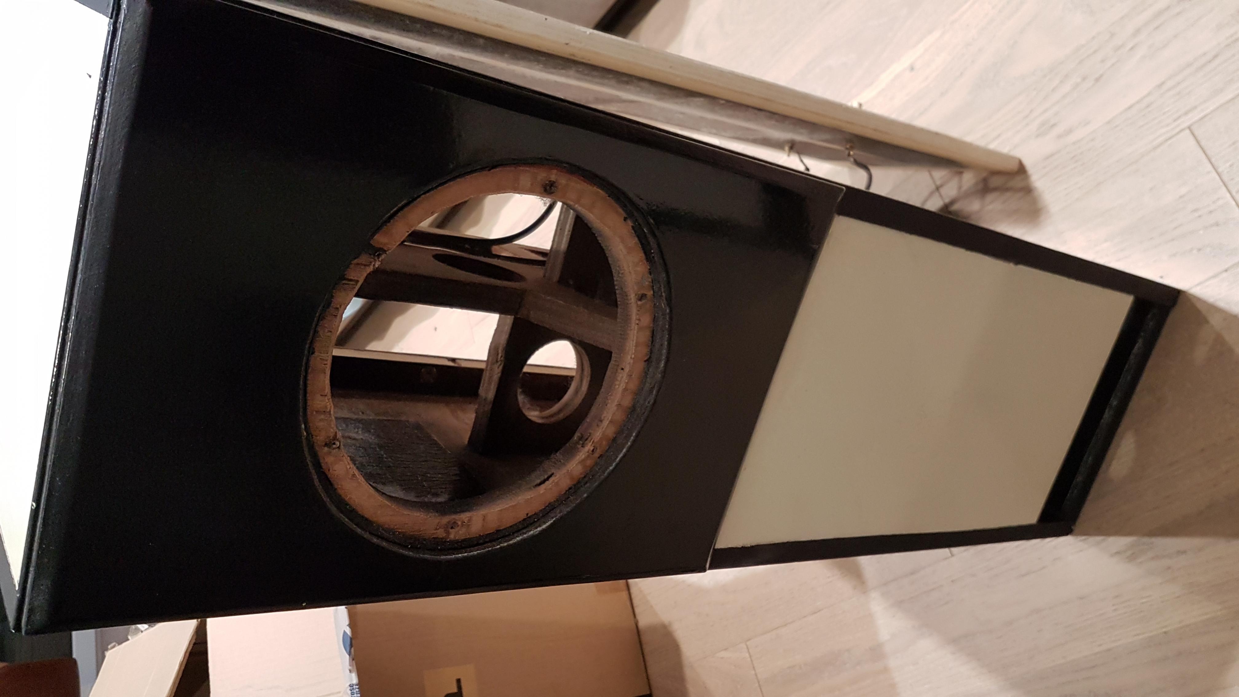

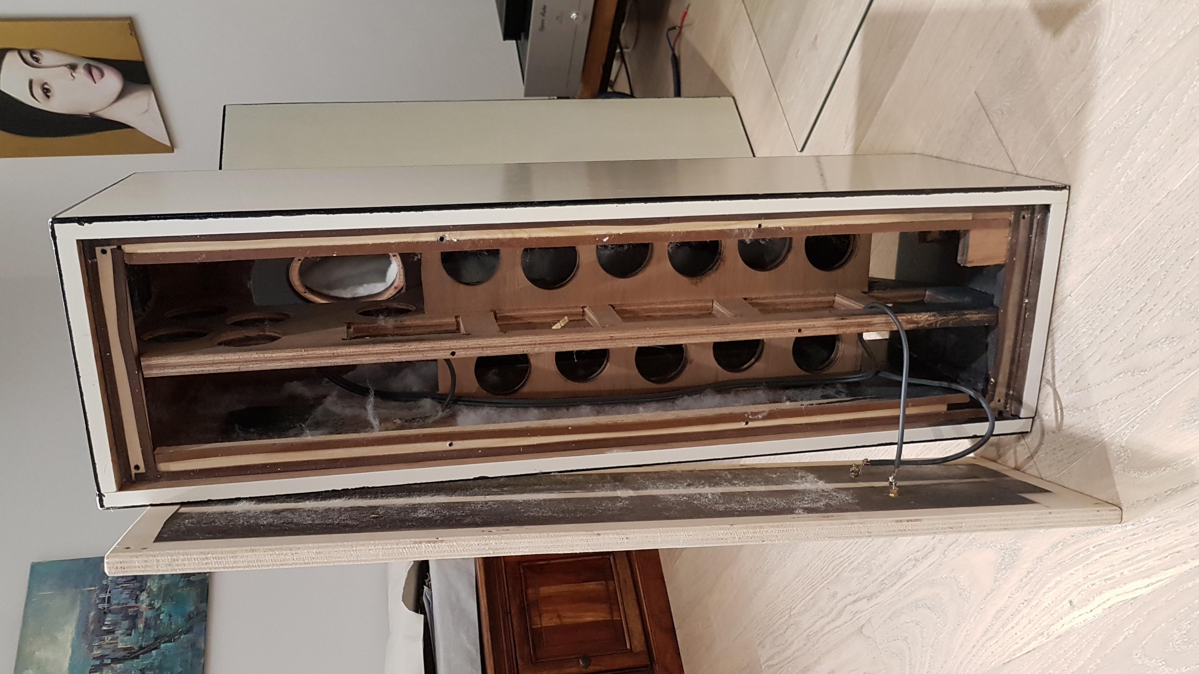

Hello guys, recently I have purchased diy cabinets with Alpair 12P. These are Pensils, the small ones but with extra bracings. Such a great drivers, so many details, however the quality of the cabinets is just so so... so I am wondering about making some new cabs 🙂 it's been 8 years - if I'm not mistaken - since the drivers were manufactured... maybe there is something more interesting than Pensils these days? 🙂

Are there designs out there that - sizewise - are in between the pensil 12.2p and the small 12p bass reflex box?
The A12p like a big box. I have a set of miniOnkens for these, but strongly recommend the small Pensil as a minimum. If you need a smaller box choose the A10p — personally i think a slightly better driver (goes higher, lower, has better DDR and greater versatility).
dave
dave
Ok, thanks Dave. I allready have a pair of small 12.2p screaming for a house (which I am not able to build myself entirely). Will choose between the small BR or smaller Pensil then.
