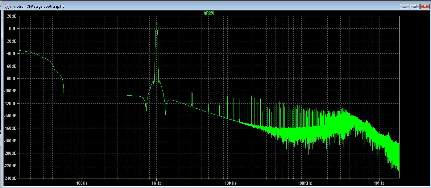

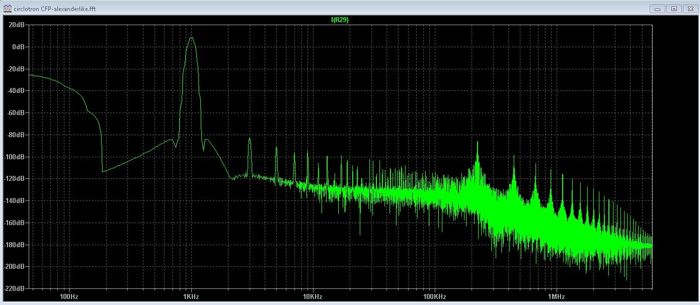

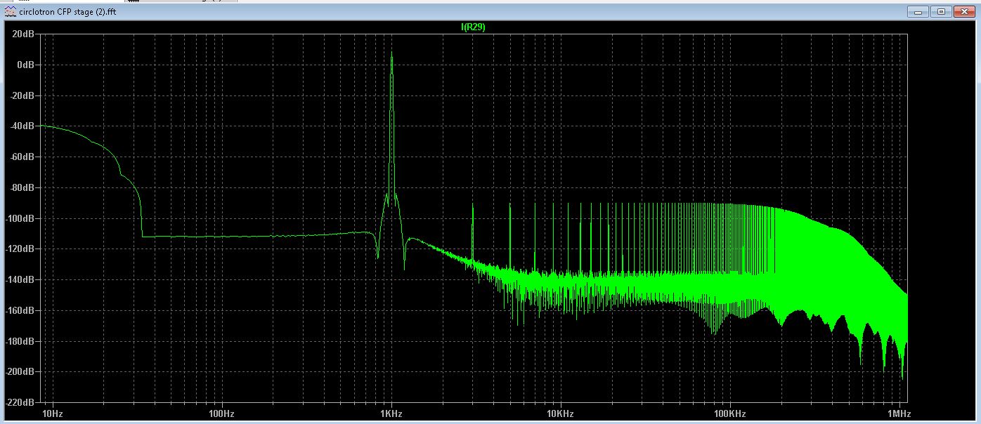

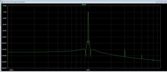

Did some simulations
The schematic in black pic has more distortion.
Did now all types, alexander, bootstrap, only opamps.
pic 1 = alexander current feedback like.
pic 2 = Old X specified design (opamps)
pic 3 = kees bootstrap (I did).
pic 4 = X his bootstrap design.
not much different in hd so far, all output is full power..

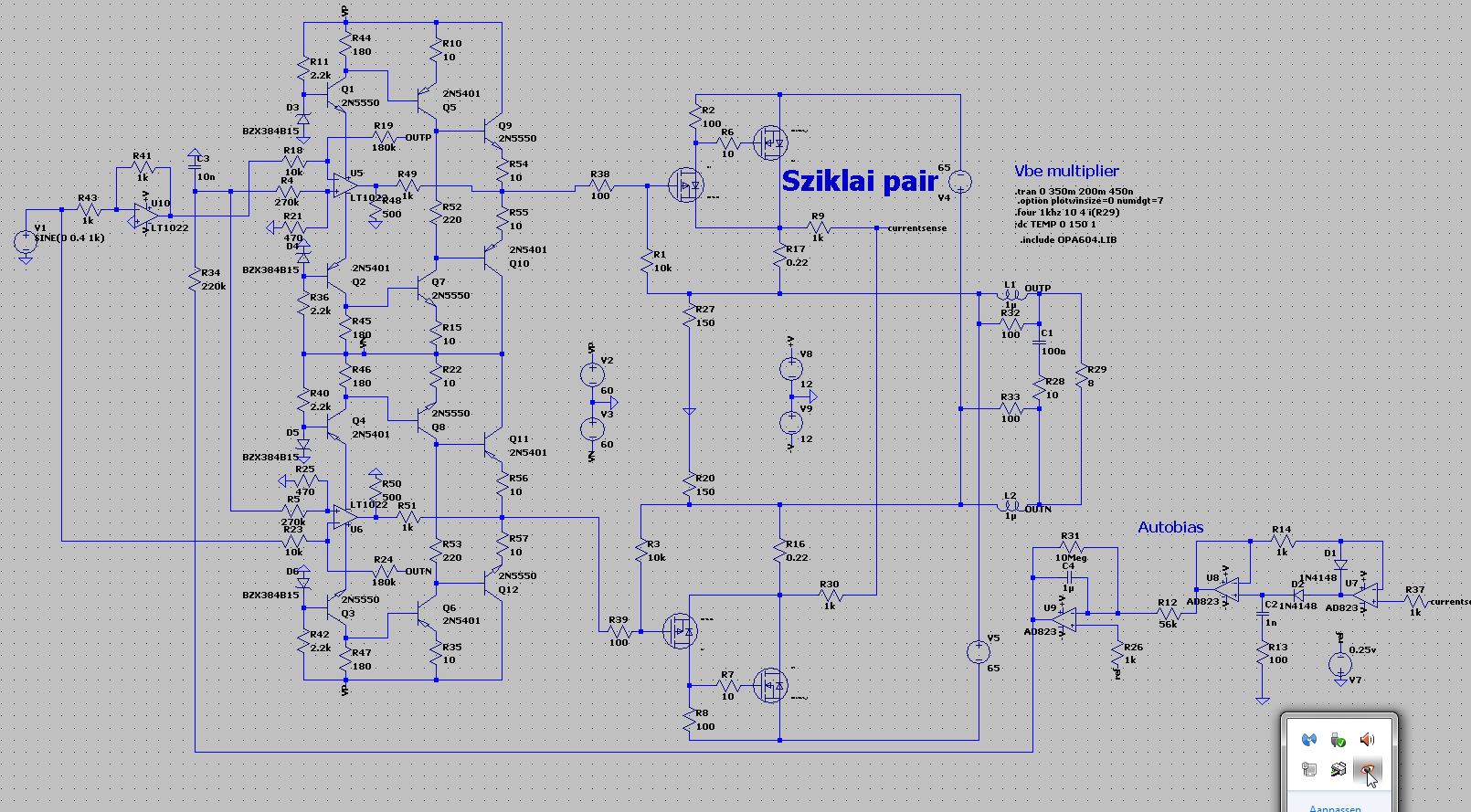

The first design is the one following paper by S Dogran, and the one in black is design by W Kirkwood. None are of my own design. I like the one you did too.
attachment.php
But 5th order is high and that can cause a bit of fatigue. Whereas the Kirkwood one is monotonically decreasing higher order distortion and less fatiguing.
attachment.php

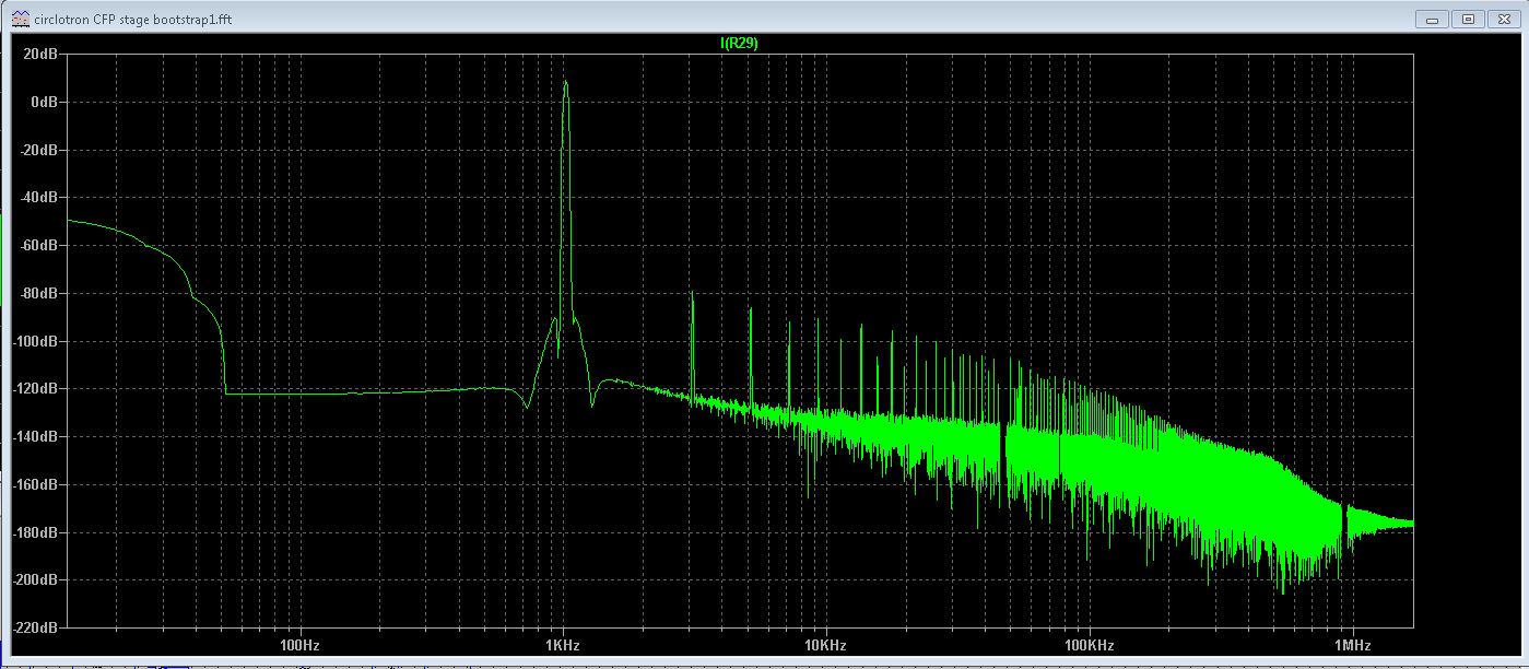

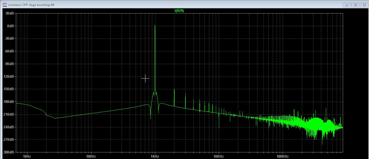

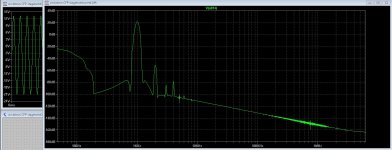

X The distortion is much lower when I let ltspice run later, so the autobias can ramp up first.
Autobias pic you see it does track nicely.
pic 3 is the cfp version also better when ltspice does sim later for ramp up first. CFP has more distortion but looks stil nice.
regards

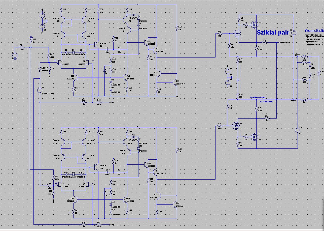

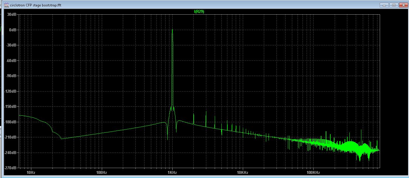

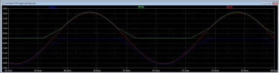

Some corrections in the bootstrap version.
A lot depents of opamp and model, I have now include a follower for low output impedance, see the distortion with 2 amps out, quite low right? the follower is in class A.
regards

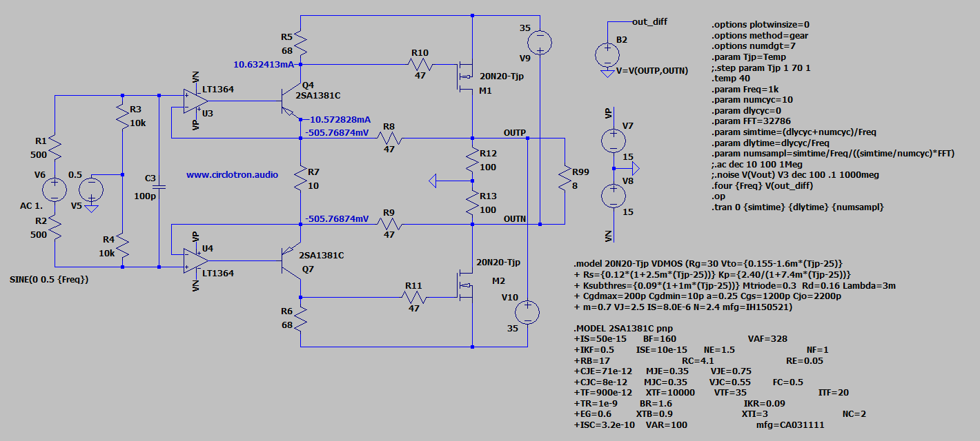

Hi kees
I see that you reuse what I proposed in 2019
OPA604 Circlotron | Circlotron Audio
http://circlotron.audio/data/simulation/img/opa_B.png
how do you bias the output stage? with the voltage source on opamp input ?
Ahh now I read good, do not always do this, I see the proposed amp was not from X but from Ultimate, sorry guys that I did mixed you up.
In the meantime you see that I do use the opamp inputs for the bias (automatic).
I have now extended this idea and it get some more complicated.
regards

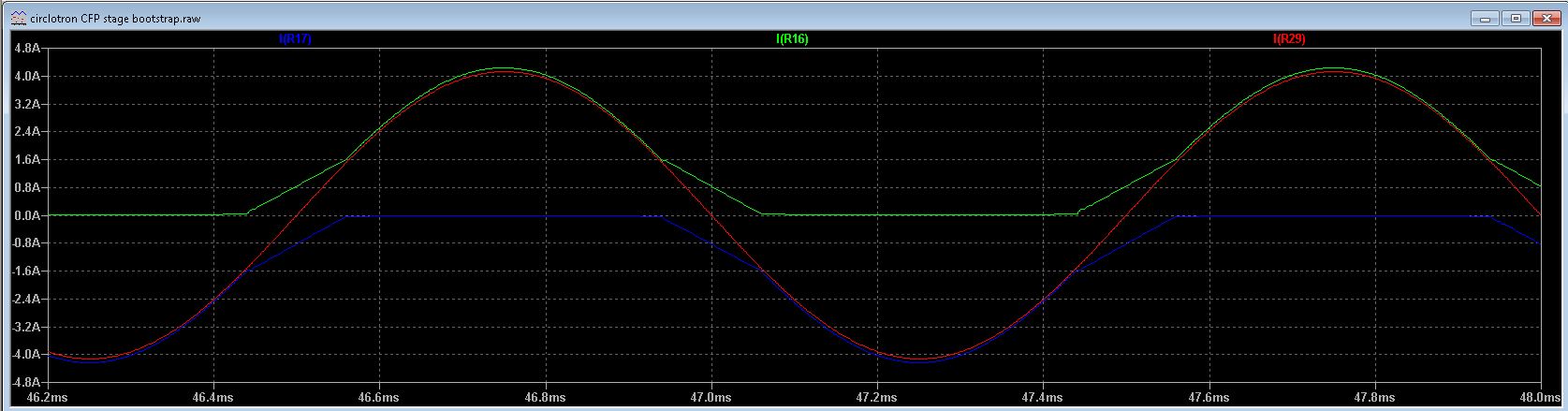

I did make some unballance in the amp but the autobias does not like it, giving uneven idle current because this resistor is made smaller.
but hd is some more friendly but still a formidable -150dB, we need to make the unbalance on a other place for not to provoke the autobias.
regards
Hi Kees,
Let me know when you think the schematic is done - I'll ask JPS64 if he can make us a nice layout. I think this result is quite phenomenal if we can achieve it in practice! -150dB is below what an AP can measure I think. You need specialized equipment like notch filters and high gain amplifiers to boost the distortion to measurable levels.
861549d1595025239-allfet-circlotron-unbalance-jpg
Is it this schematic but with some asymmetry added to the resistors as I suggested?
861510d1595013155-allfet-circlotron-kees-bootstrap-schematic-jpg

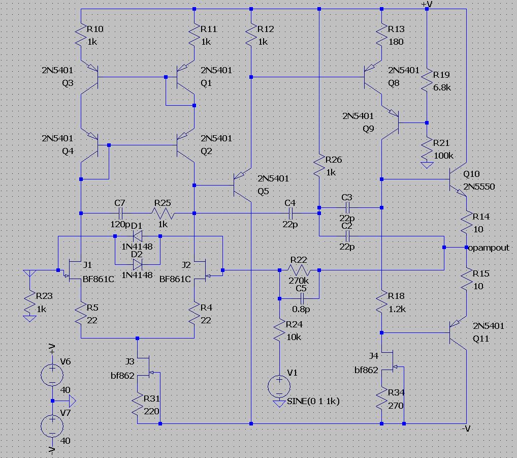

Busy now with a discrete opamp, look what it does and such.
Do now, in practice it will be different afcourse. The version with the two opamps from ultimate does also low, and is quite simple, because this opa604 can withstand 24 volts x 2 you get still 80 watts.
Th discrete version of a opamp, just a example of a modern good sopunding one and have fill in the vaues of resistor etc.
Can on hogher voltages and the respons, like with some more even harmonics is done be playing with the idle current through the transistors.
I have much open loop with the wilson mirrors and cascode.
it can supply easely the output signal for the mosfet stage for high power.
Is somebody see some strange values of resistors or so, just let me now, because recalculating that is not so mine thing.
regards
Een goede avond Piersma, welkom.
Oke yes you are right, I see 10k and 1k originally here are bjt no jfet but get strange things then, I think jfet is more easy for this function.
The big 330k resistor is just for test, later on it get into the circlotron and retest, now it is to adjust things, who is not that easy with these cascodes.
I just play now some with this stuff, unfortaney jfets are not made anymore I do like a allfet more special with jfets like borbelo did.
regards

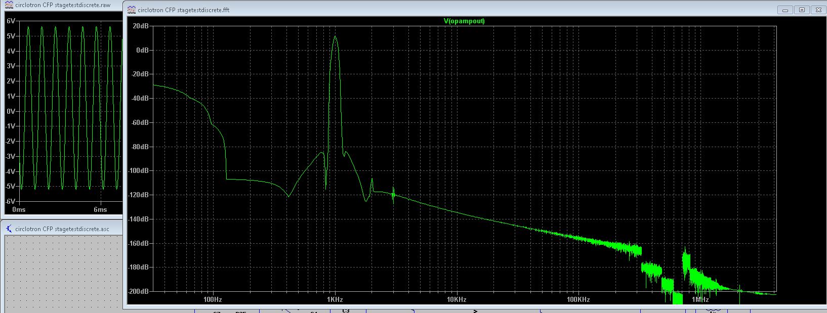

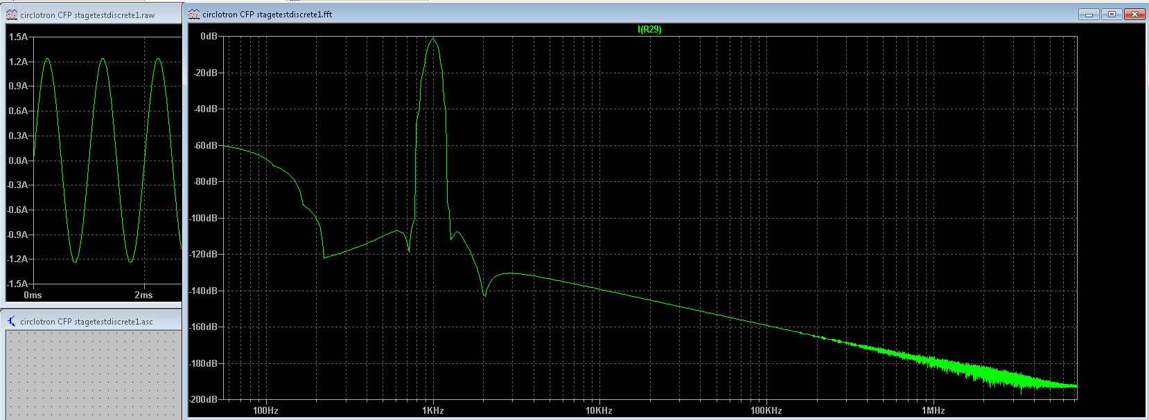

Here is a discrete version, with a discrete opamp, this one is free to use and has single ended current source loaded outputs, the harmonic content is friendly now. the previous discrete version is deleted.
On the output of the circlotron is the harmonic content canceled out, AI do not now how it sounds with such a low distortion, building one will tell.
now the diamond input current feedback as last, if someone will schematic to simulate thereselfs let me now.
second pic is the output opamp before mosfet powerstage, see it has nice harmonic content.
regards
