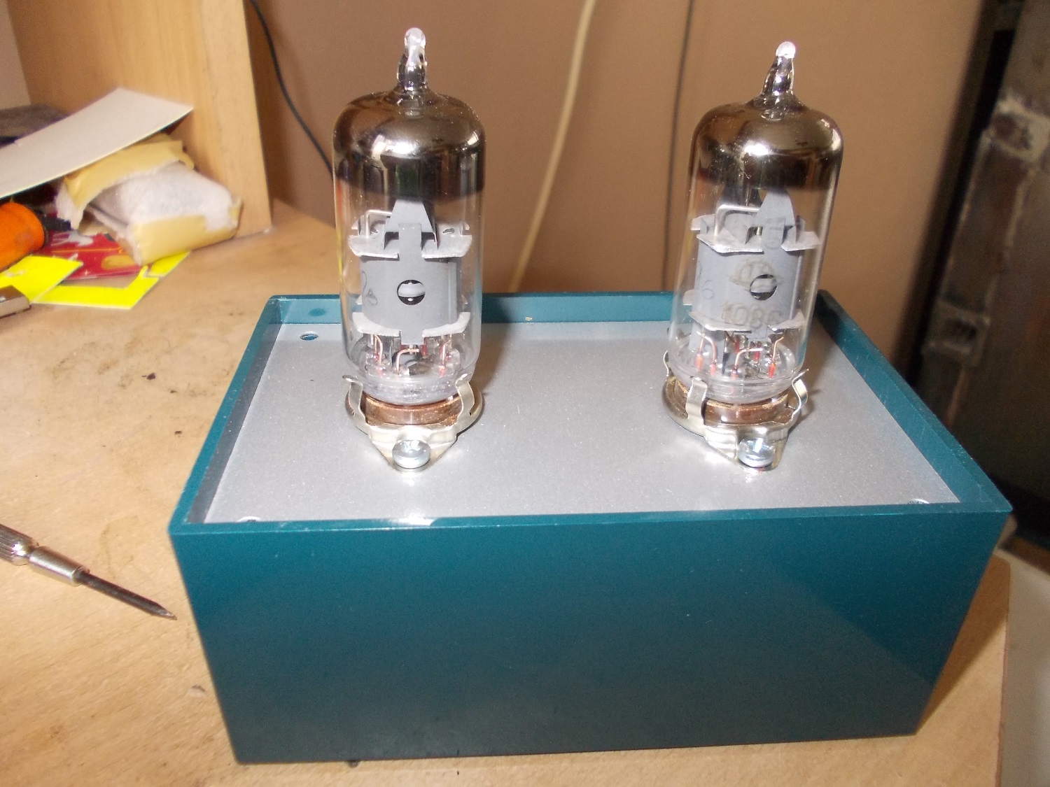

Hi All
I have start making a voltage amplifier to drive the circlotron with autobias, it is just a test to see what happens, I go drive it with two caps, otherwise I get some voltage, not nice.
tubes are good for getting high voltgage output because I need also to drive it to clip, then I can see what it does with the autobias.
regards
regards

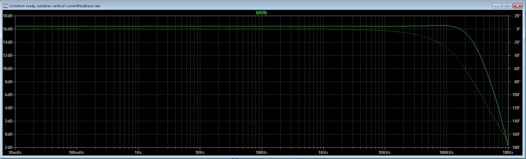

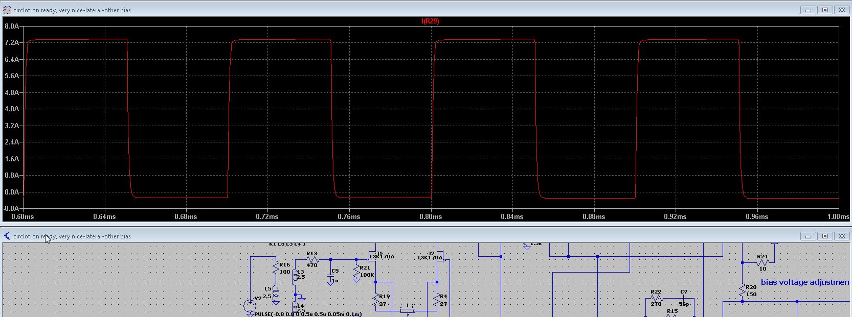

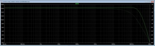

There is still a cap into signal path of the circlotron, and the driving of the mosfets, the vertical ones has quite high nC only the irf460 is lower, and you need a beefy driver for bandwith, that is why I have a extra driver in class A before the verticals, it lowers distortion a lot.
see pics, one with 6.5 amps out in 8 ohms and one with 1.2 amps out on 8 ohms, the autobias works nicely.
last pic is bandwith, oke with a extra driver in class a, but need higher voltage for driver section to get mosfets fully driven.
I now mine is more complicated, but needs are high end.
regards

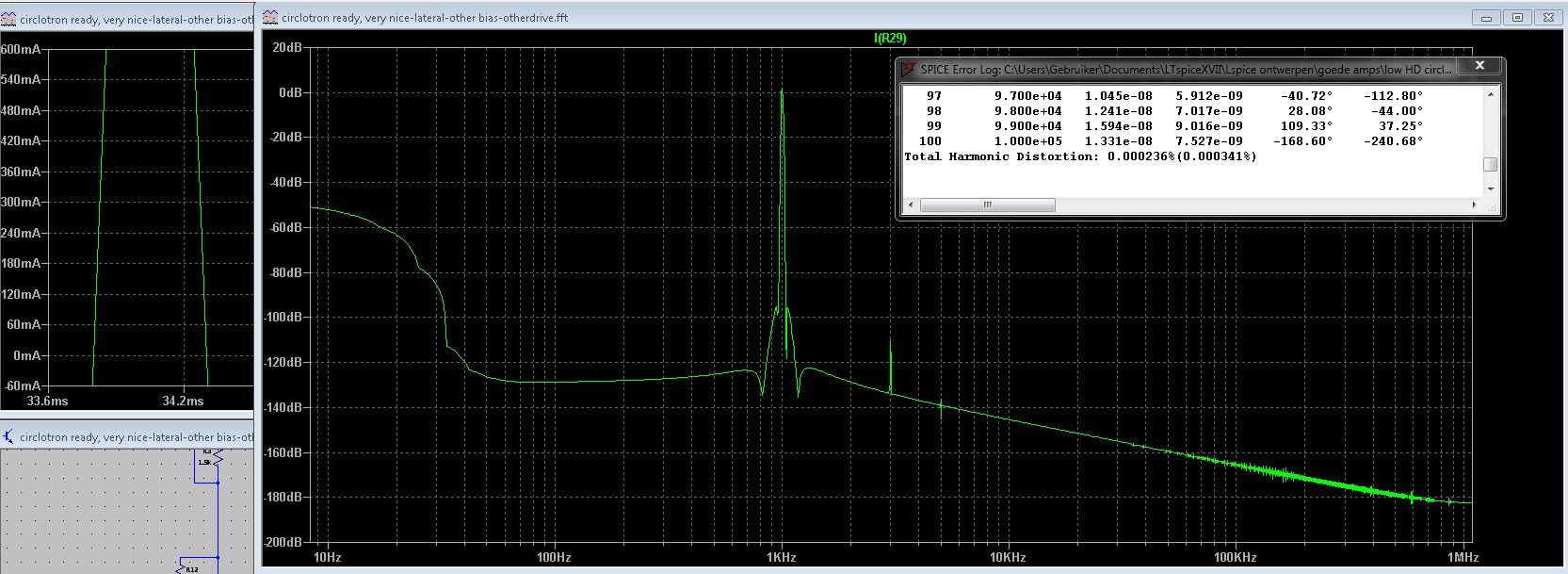

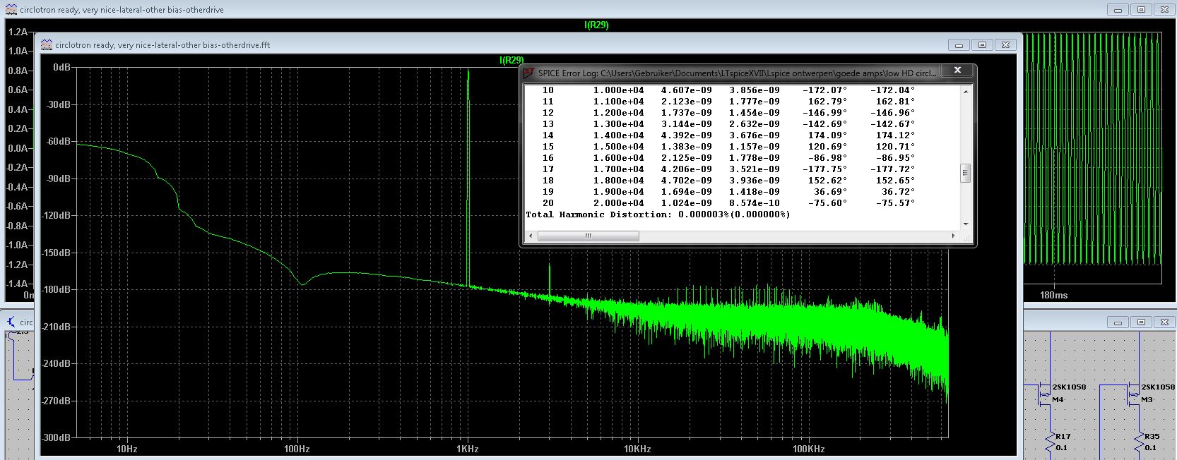

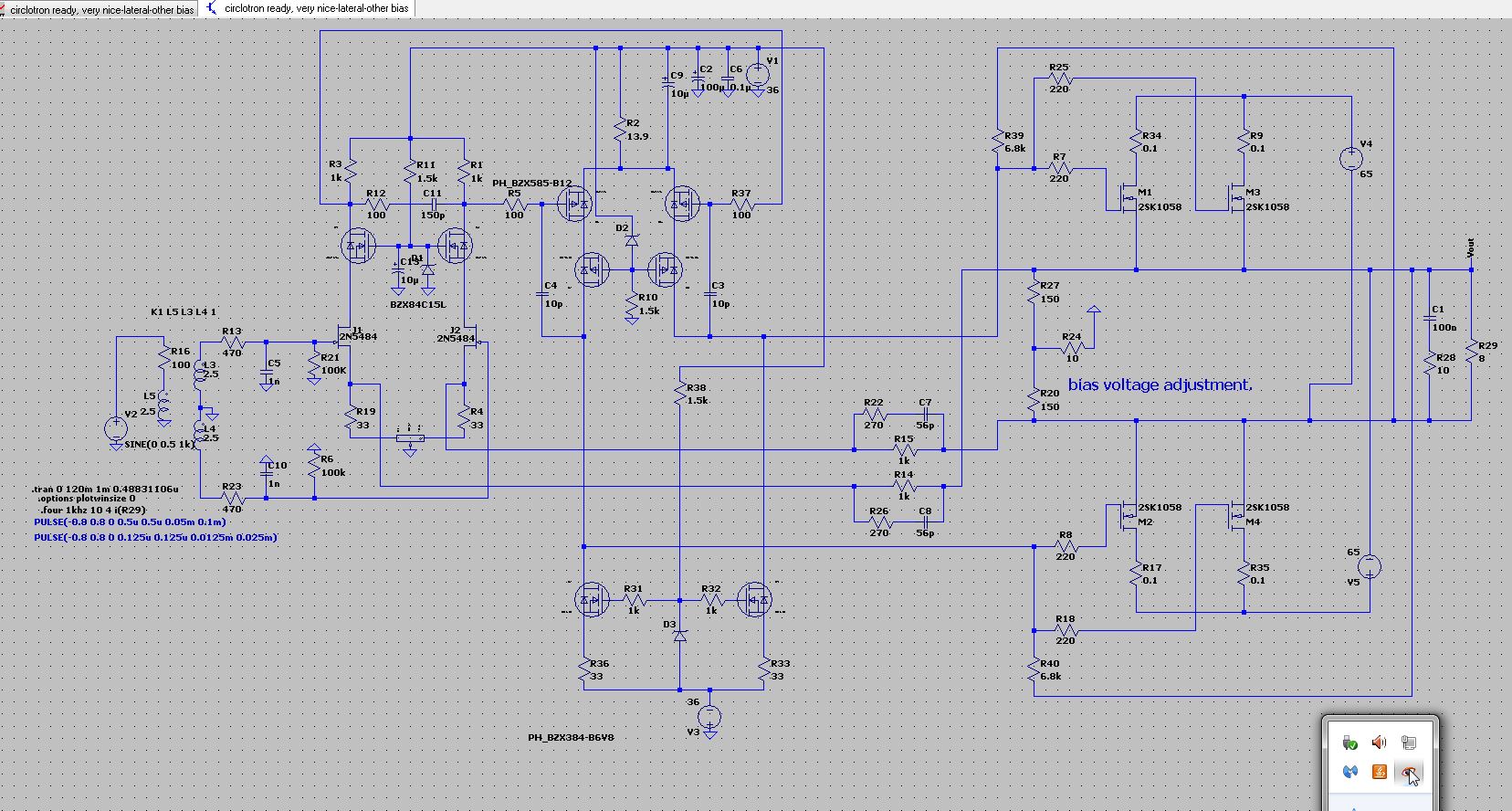

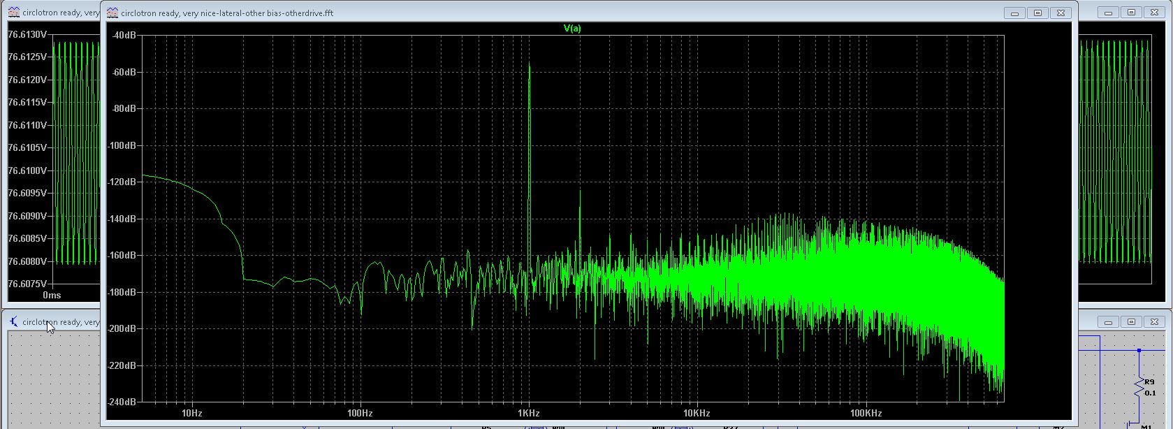

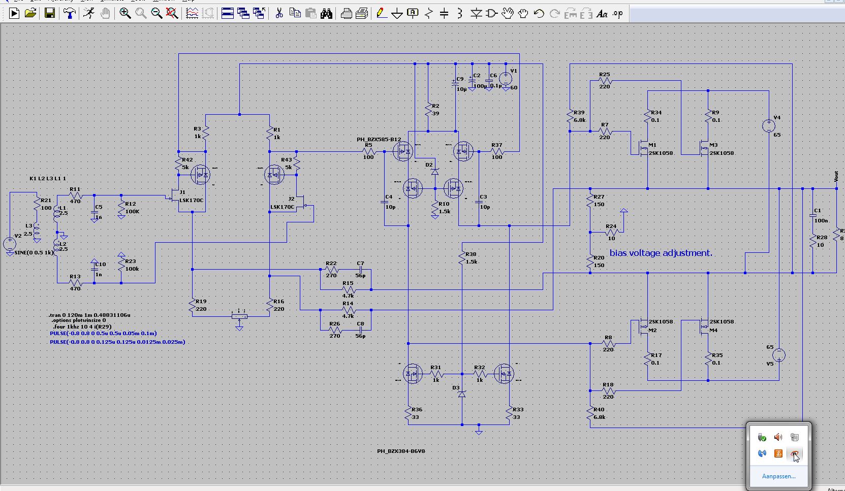

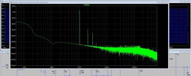

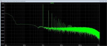

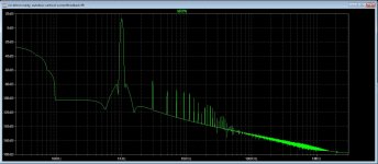

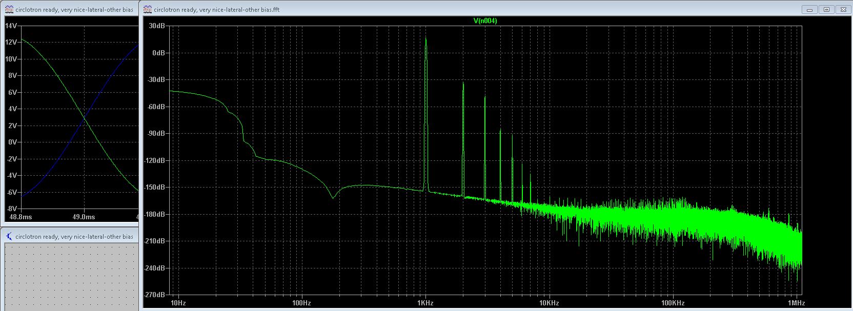

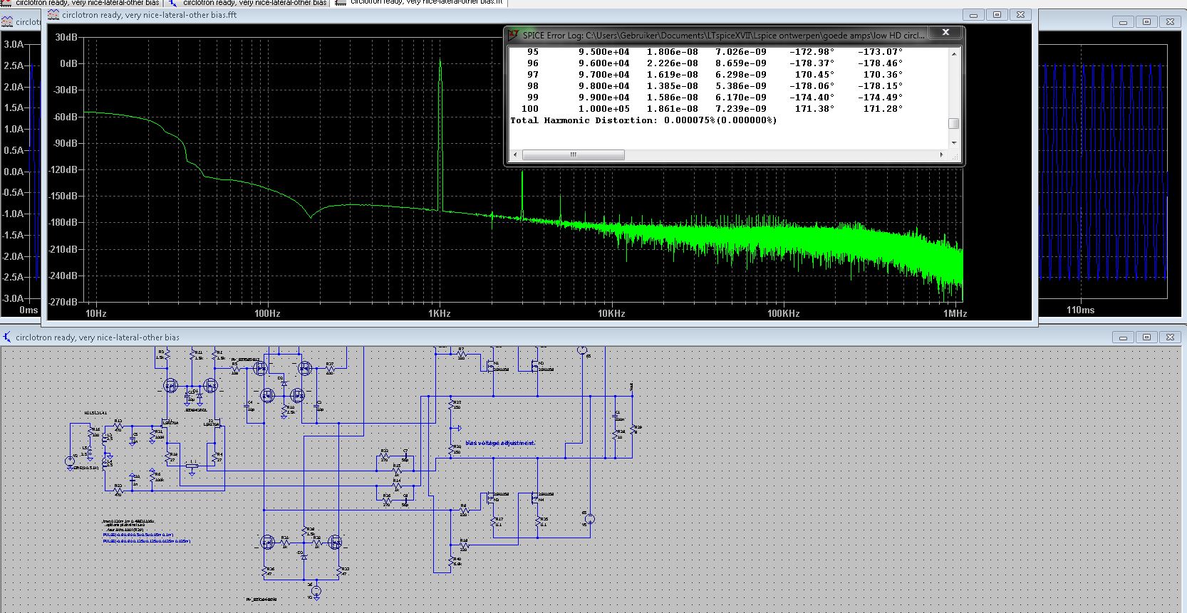

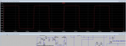

I have a question about distortion in the input stage with the jefet, and the differential vas after.
I get low distortion in the output but see nasty distortion in the vas and input stage, I think the input needs changed, here is that distortion seen.
But maybe somewhone can explane, because unfortanely I do not now everything.
Pic is first input, then vas and output, and schematic.
thanks.
thanks.
I've also seen this behavior in amplifiers using global negative feedback.
You could try changing the amount of feedback and seeing what happens. More feedback (making R14-R15 smaller) should make distortion smaller at the output and larger in the earlier stages. Less feedback (making R14-R15 larger) should do the opposite.
If that's what happens, you are just seeing negative feedback at work.

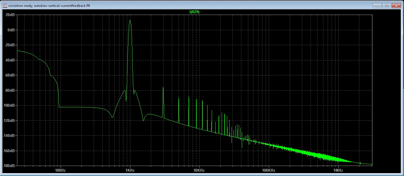

I have try that now, here are the results, did need lower it much to get rising distortion output.
Do see not much differences, maybe I do load the input stage to much because it go directly to a drainfollower who is a cascaded one, still it has inputcapacitances who do get nasty sometimes.
Maybe the setup is bad, I do use current feedback and no current source there as result, otherwise it will give trouble.
I go read some more here.
Input Stage Distortion
regards
Have you tried removing C9?
If I remove that elco, (do not now why it is there killing local feedback) it is some better in higher frequencies.

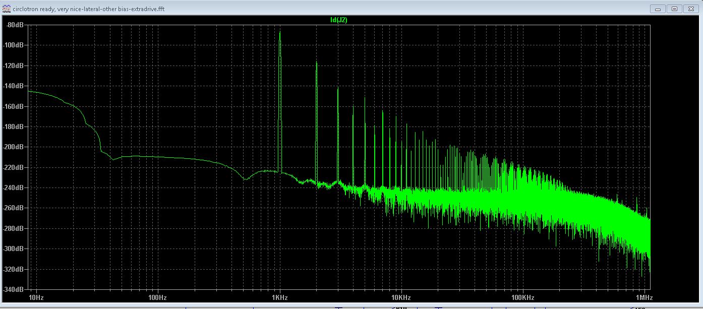

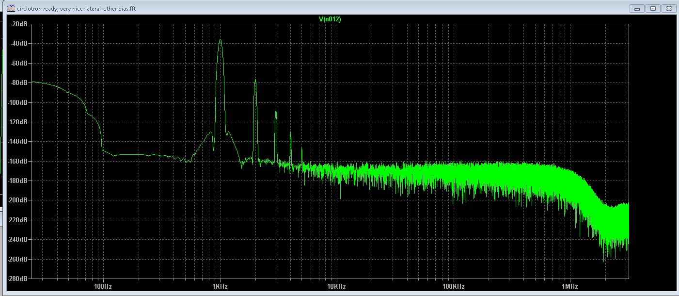

We maybe the error is because of the offset present on each side, this cancel out offset on speaker but does inbalance the differential inputs, special because it is current feedback, I go try a way to cancel out and test.
The new kind of input amp I did use now, it has the same kind, so the feedback in action is really a possibillity, I do not now how much people here did though on that!

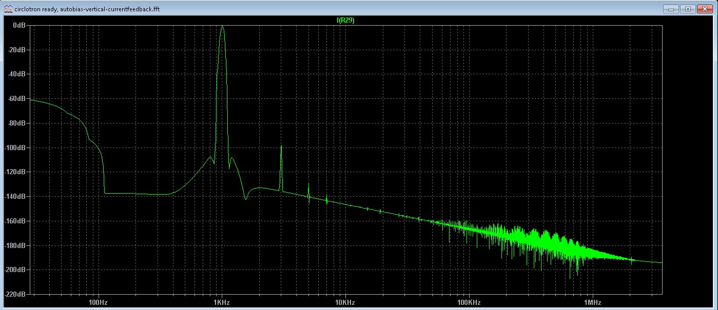

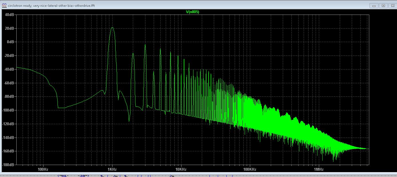

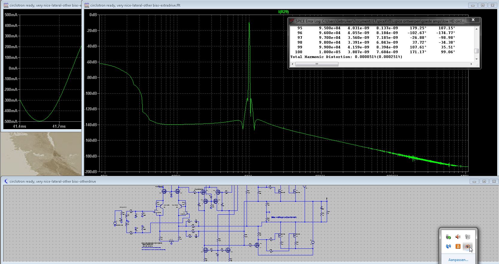

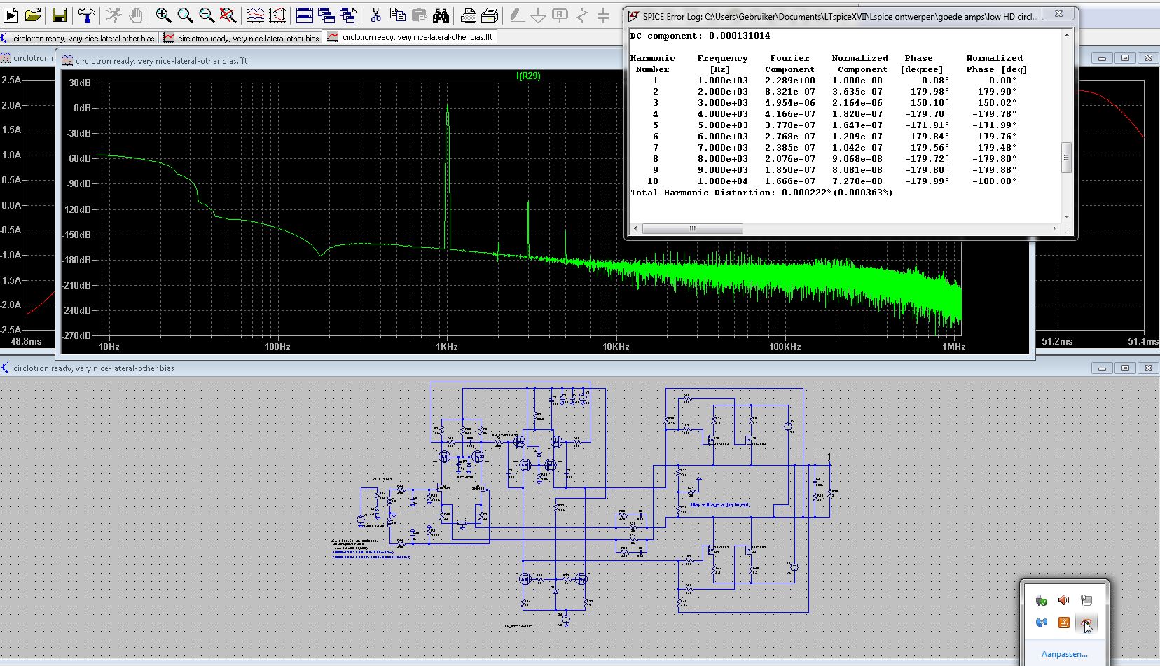

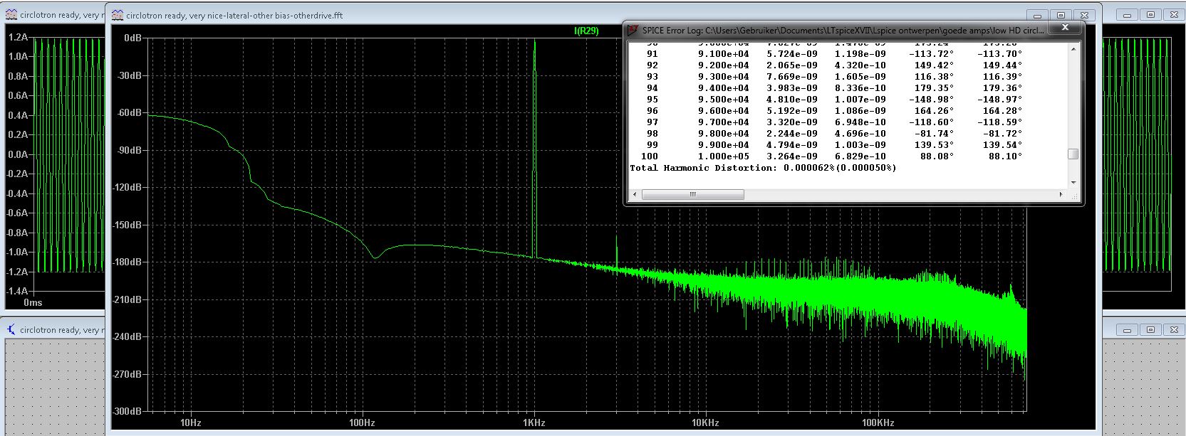

Pics are first is output distortion, second is VAS distortion feedback connected, thirth is output distortion with the new input stage jfet/pnp and fourth is open loop VAS.
We now unbalance in a long tail preamp does go bad. Photo three is with just 120mA idle.
regards
regards
Wel You never gess what was wrong? I say it, the voltage of the preamp circuits need really to be high because of using cascodes, I have rise it to 80 volts x 2 and now things bevavior is much better, we need enough voltages to drive the output mosfets. Because of voltage error I have removed the ltp and put in a cfb circuit who is suitable for current feedback, and it did work.
The lateral version does the best.
Now to the autobias, I need to inject the bias voltage somewhere, like into the lower vas current sources with a opamp or so.

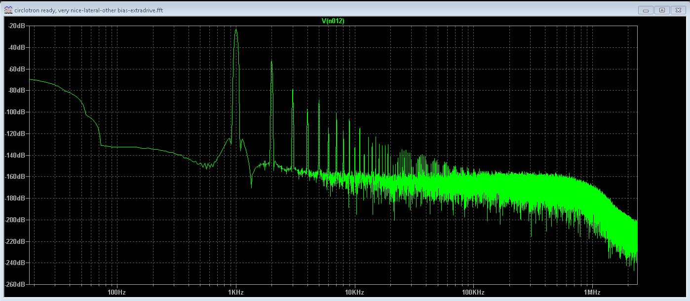

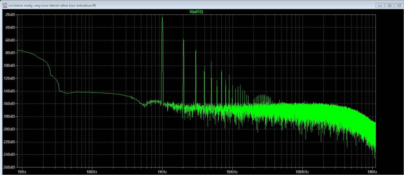

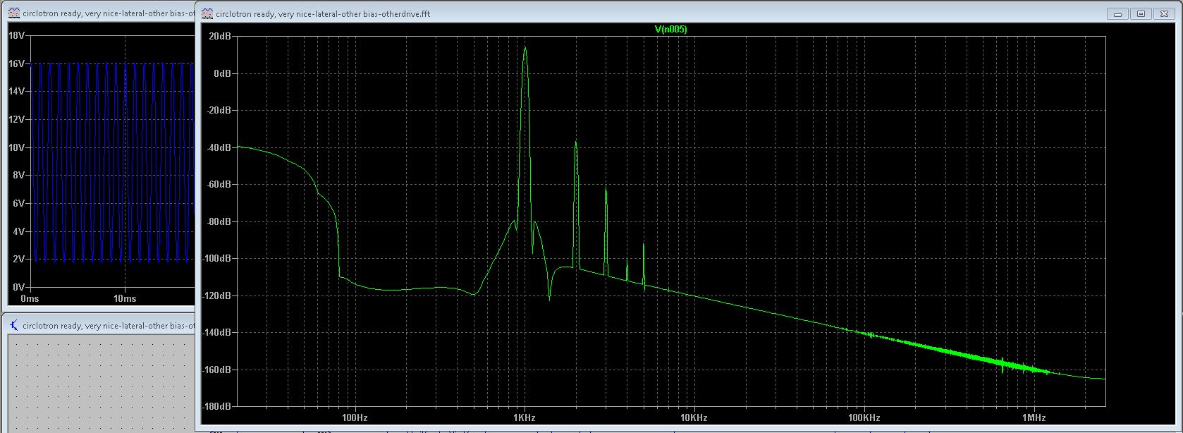

Wel now I have put some sims here, but now i now also disbalans is a big problem, special when using a extra driver fet into the output section who is a source follower does make it unbalanced in driver section, and there comes the trouble from.
using not a extra driver but using a beefy VAS and laterals, I get quite beautifull numbers.
I can post the circuits, for playing with it.
regards
regards

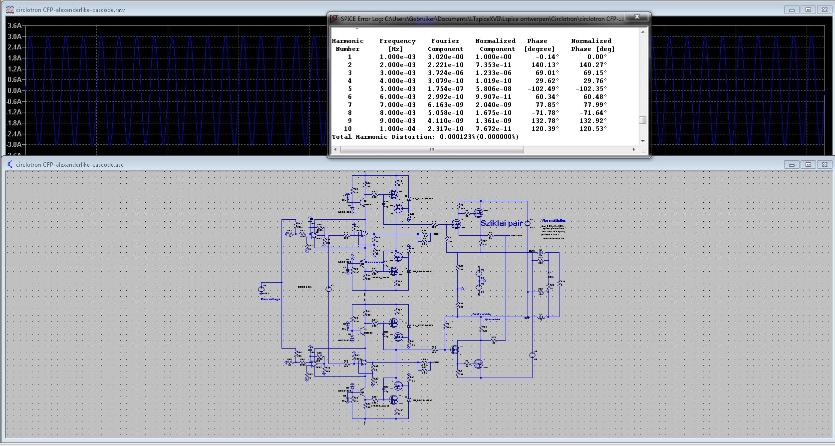

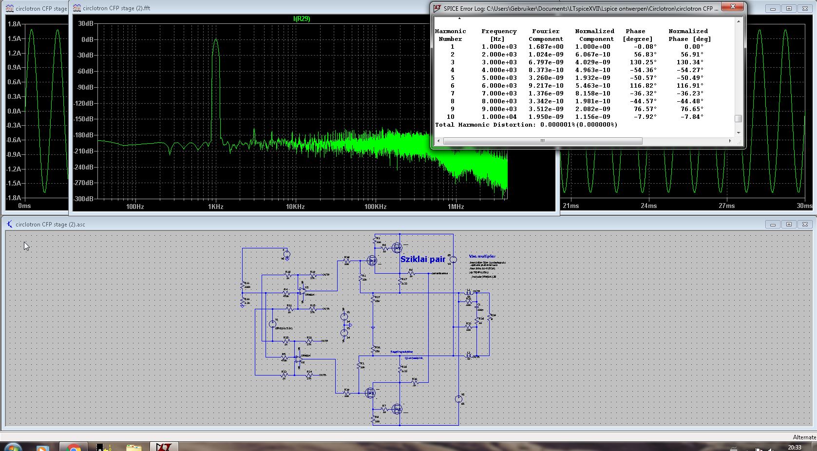

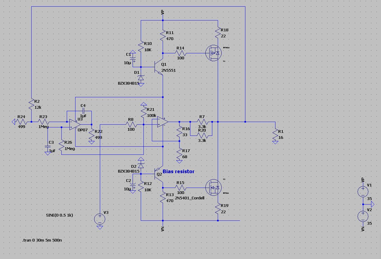

Hi all
I do post here a alexander circlotron haha, i was again driven by combining stuff.
yet low distortions, I did try with opamps does work fine but some limited output, need discrete here.
X I have use the alexander preamp for driving the pair in the outputstage.
see the pic, For you maybe, using only the prestage can be interesting for the headphone, a true current feedback amp and fast, some adjustments needed.
The very low hd version is a voltagefeedback one with opamps, however discrete opamp is better, more headroom.
regards
regards
