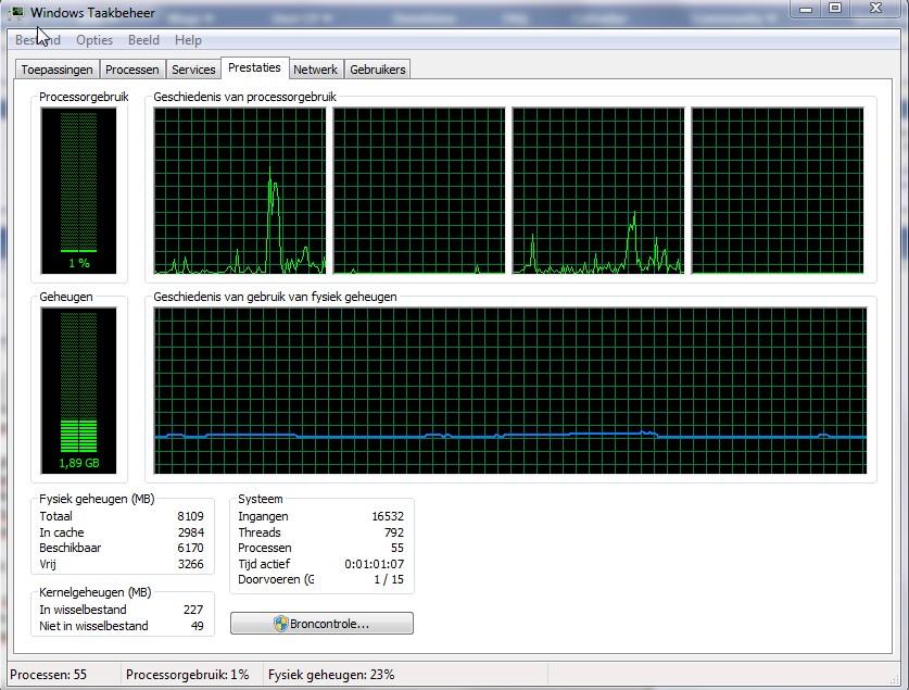

Windows did use 3.5 Gb of ram when updating and 25 to 50% cpu, I have 8 gb memory now and half was consumed. Have slipstream my windows iso with newest updates and when install again things are oke again.
But now it eats again 1.89 Gb memory and I have not yet much on it who have background activity. but cpu use is almost zero. This happens after a update yesterday. For comparison the windows 10 version only eats 900 to 1,2 Gb memory.

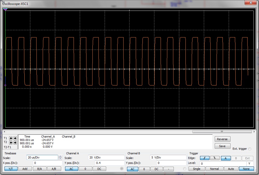

I have play some with Tina, did mange to download it, see scope and such but how you connect this? multisim is much easy to work with and runs continous in this mode.
Did see much differences when use lt spice and multisim, proberly because of models.
regards

For Tina, you need to connect both scope and function generator. On function generator select sine or square wave, amplitude and frequency. Click RUN and the. Go to o-scope and click Normal sync, then RUN. On FFT analyzer similar thing. I admit this part is not that easy but once you see it it works. And it is real time. You can go in and change value on a component and the scope changes right away.

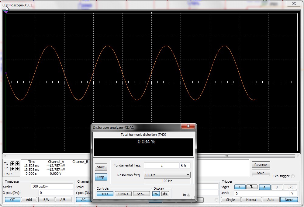

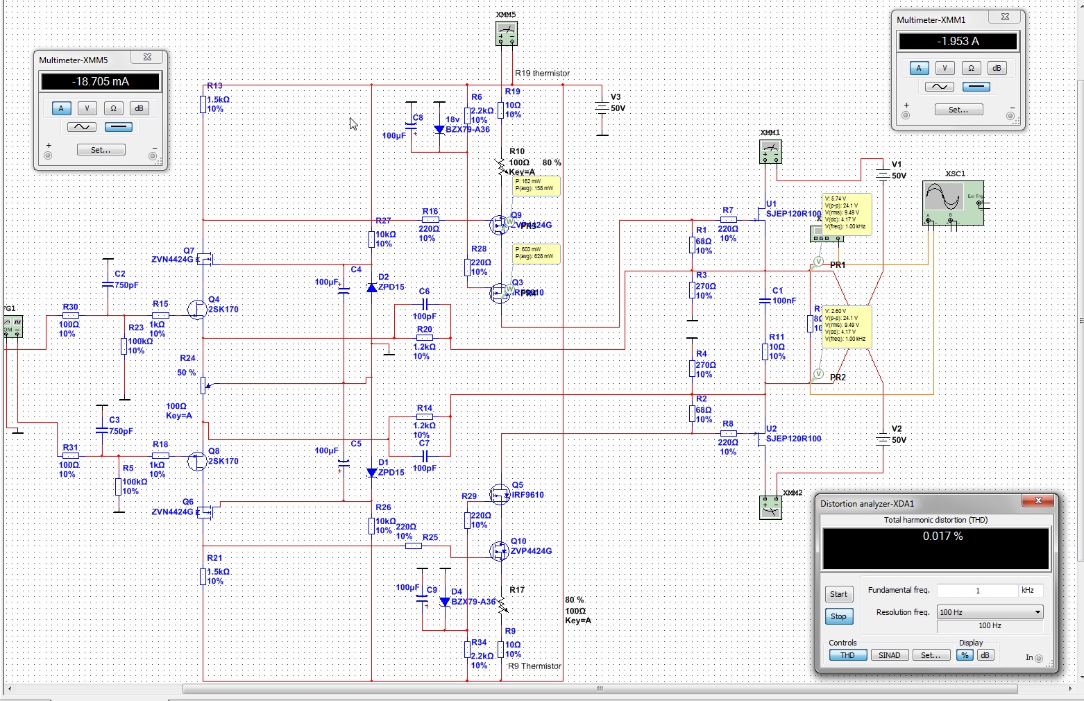

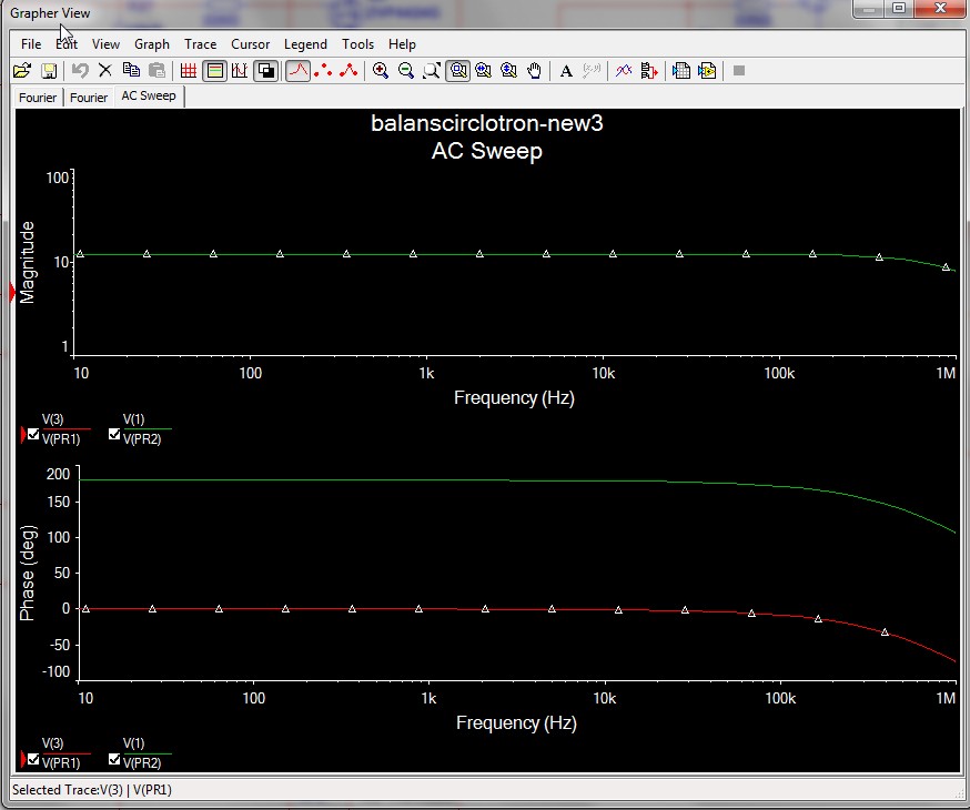

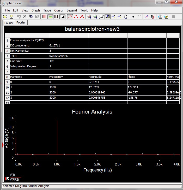

Hi X no it is just the power section, but things go change, resims did let see the first one is different, now you need no negative supply for the high end, only when the jfet idle current is to low I need a way to get some negative, but it seems that it is not needed.
sims on pictures are 100Khz square, distortion, and bandwidth.
kees

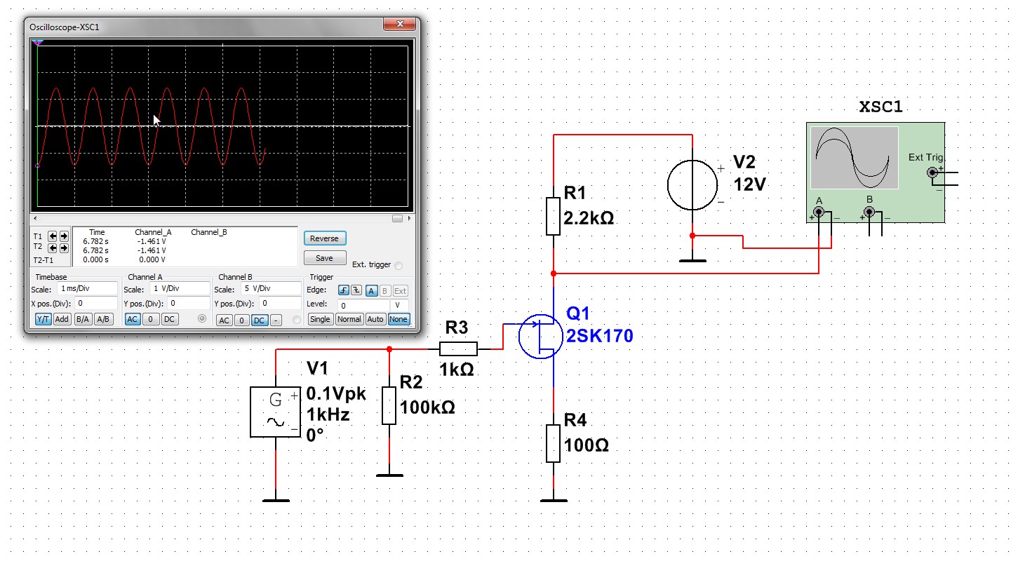

I get this schematic not to work in LTspice, it do very strange, when flip the Jfets 2sk170 things don't change, it is the same while the source and drain is wrong connected,, the sim in multisim is oke, changing there the drain soruce will crash the amp.
so I think it has to do with the models.

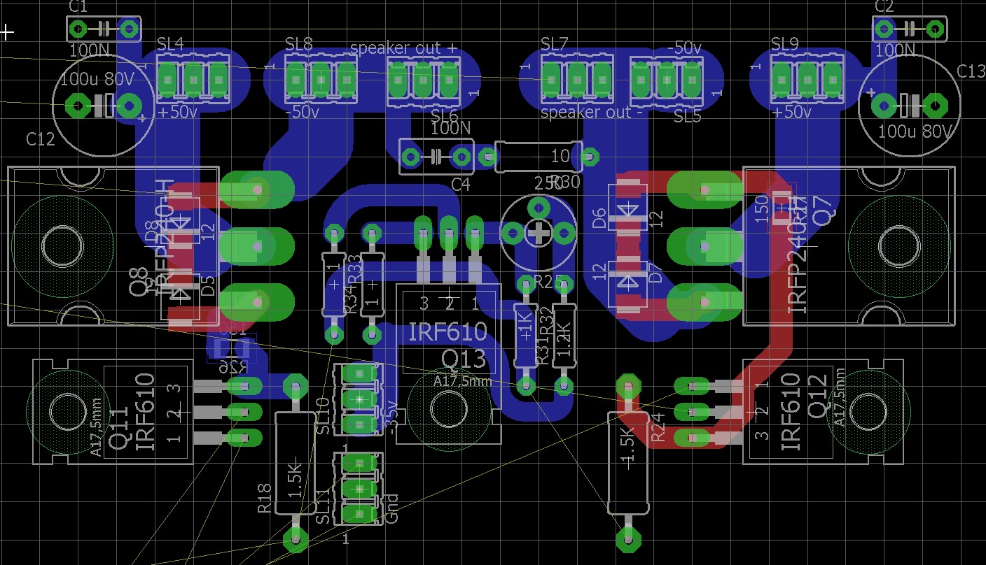

I can try standart ones, I am now simming because I have sometimes to rest with pcb.
O hh right, the jfets needs to stay negative on gates.
regards
I have now look at it in multisim, also here when switch the jfets drain source do give no change both do work the same in output.
We now why, because connecting wrong will give trouble in real live..
Did drawn a quick amp with jfet, also here connecting drain source however side, give same actions, so it is program who see this? special for the J fets or something, can someone clear this>?
I need clear about if before I go on with pcb, because do things for nothing I do not like.
regards
