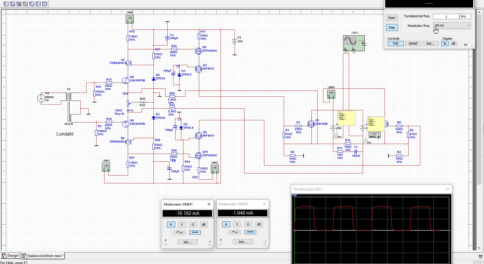

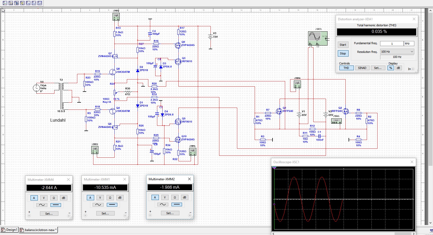

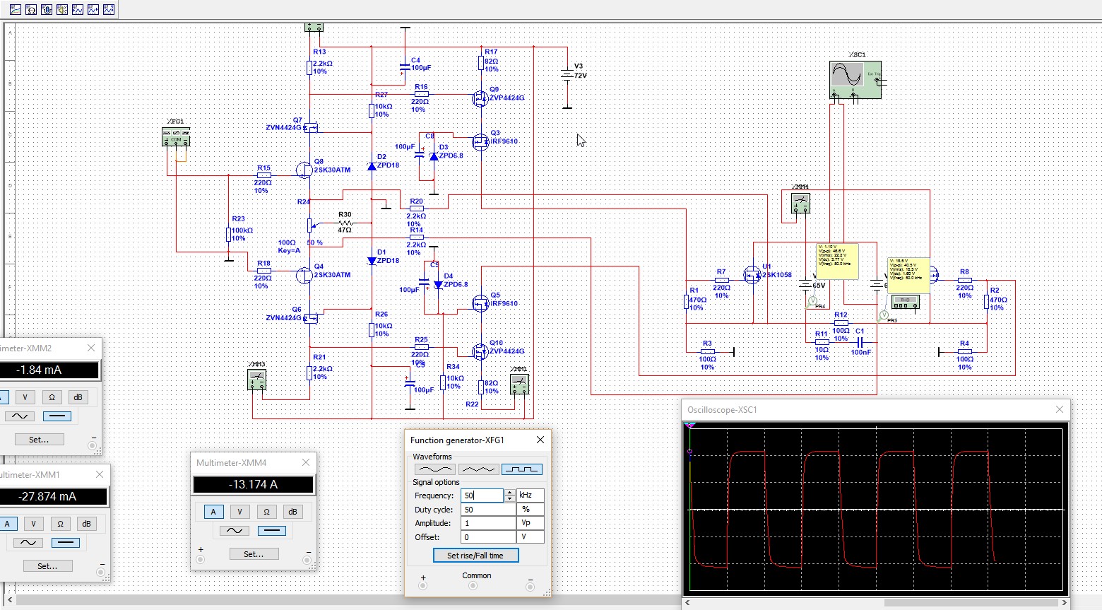

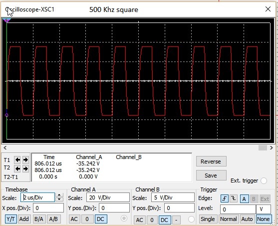

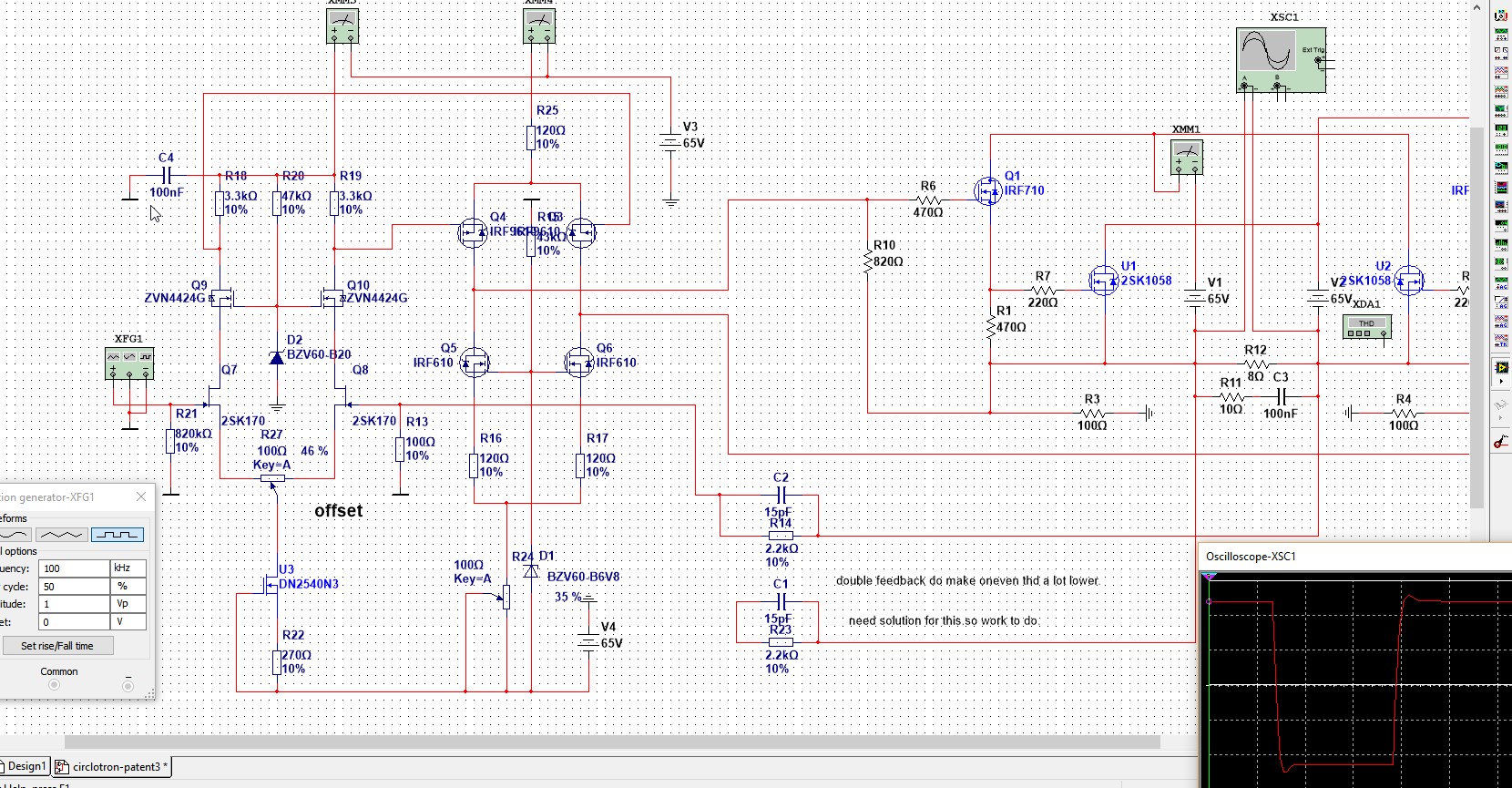

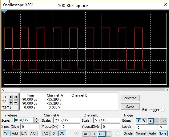

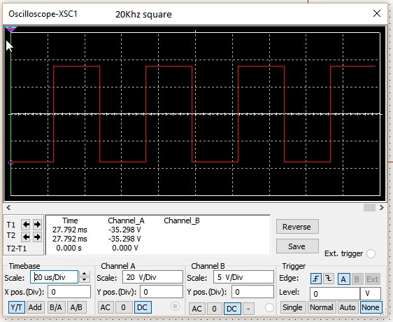

Nice work there Kees. That's a very simple design - I like it. Can you show 20kHz square wave and 100kHz square wave?

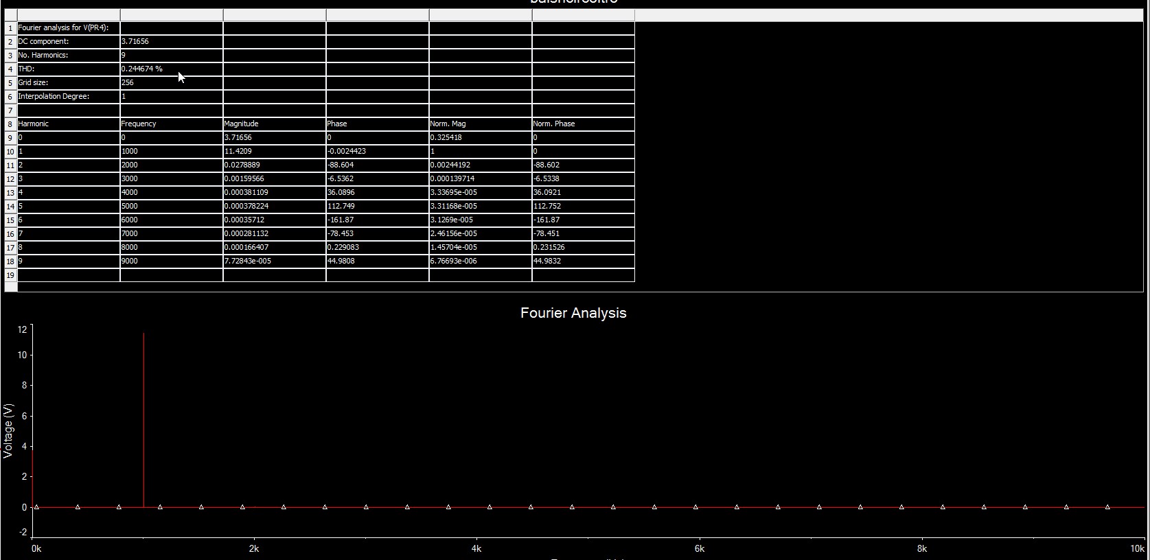

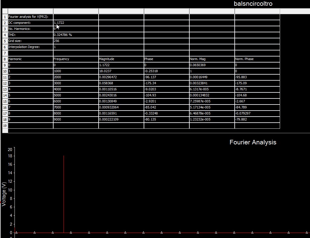

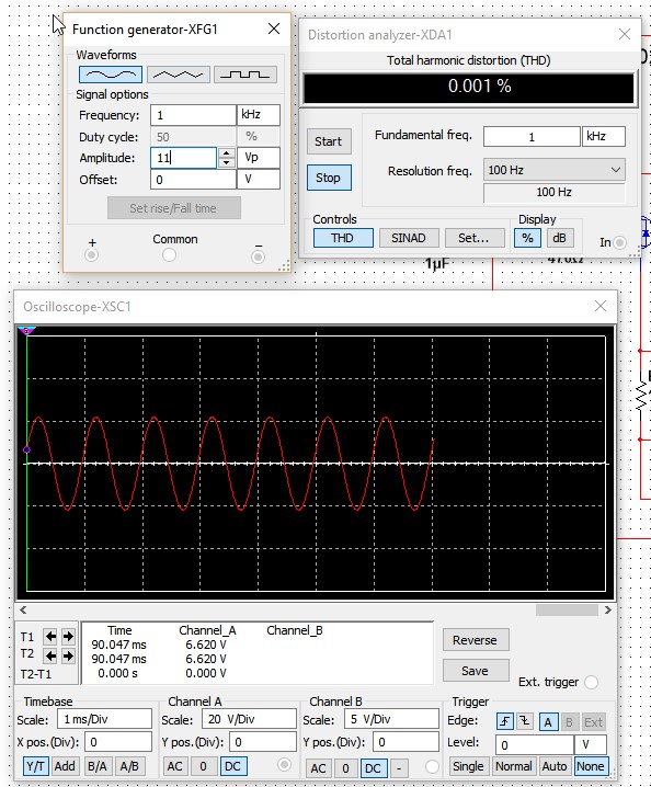

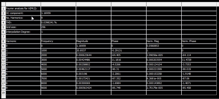

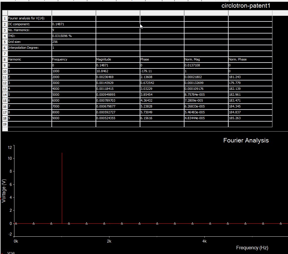

Also what are harmonic distortion components at 22v? (60 watts into 8ohms) for 1kHz sine input?

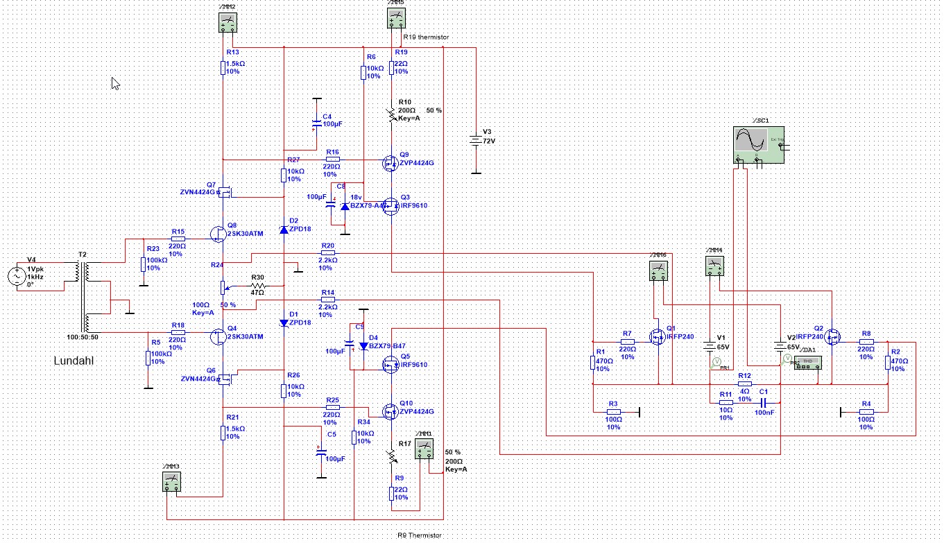

This is the current section only, need a voltage amp who I still need to do, as you did see I put in 20 volts, making 40 out.
input is high impedance for tube driving.
Here some with square wave. distortion components I can not see with sim.

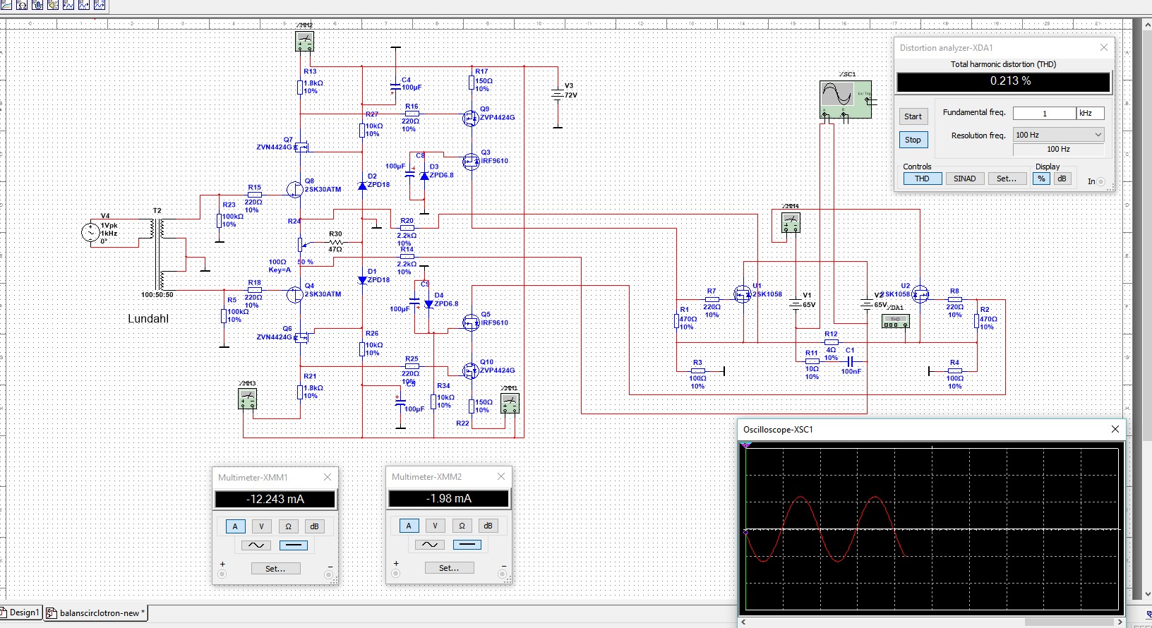

Thanks for the sims, it looks very promising. So you say because of the Circlotron topology, 20v gets 40v at driver?
You need to have log scale in vertical to see HD components. It does look low though this could be one clean sounding amp.

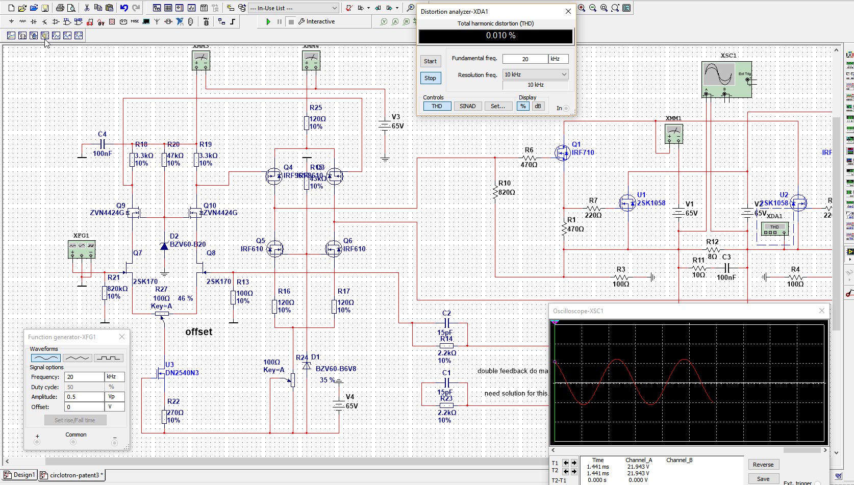

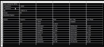

On the picture I have done distortion, jhowever in sim program something is not oke, I do not see a line at all.

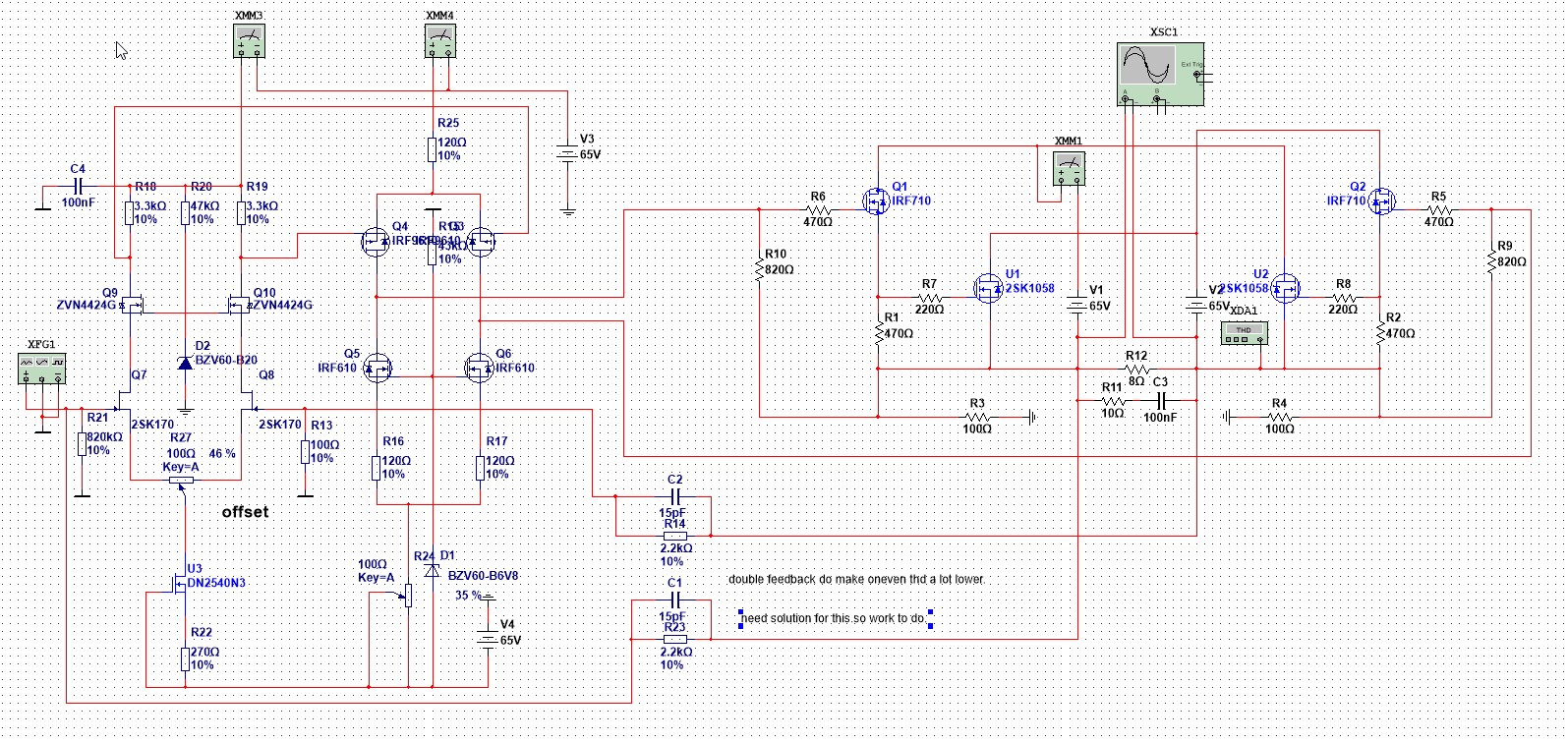

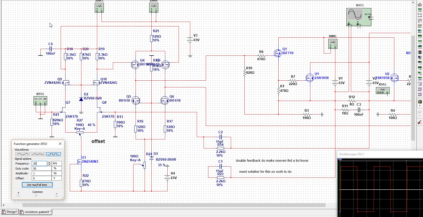

Here I did use the voltage amp part with the circolotron, for compensation of dc the input J fets and the above fets needs tight together. for Idle maybe I can use a Vgs multiplyer below the driver stage? as a constant voltage.

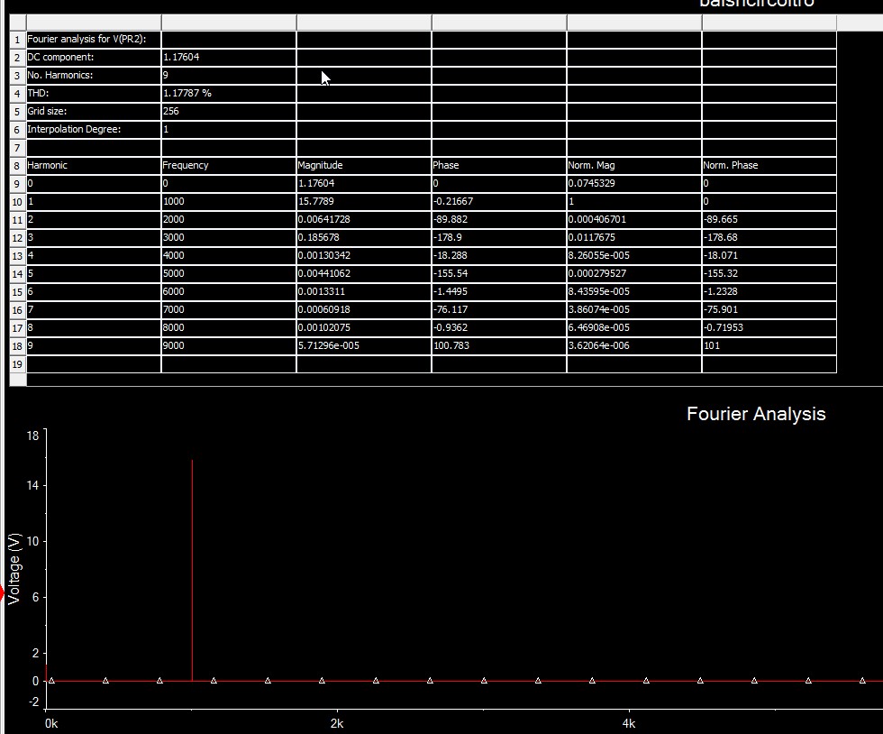

I did make a sim with distortion, Thirth are very dominant when use a single feedback path, however using the other do correct this nicely, looks a lot better. But using this extra feedback line make one input have a very low impedance, so this is not the solution, need here a other way to do this.
Something in multisum is not oke, do let see nothing in distortion. also fourier do strange, sometimes oke then not, I think ltspice is better but have no models for 2sk lat en hexfets and dn25 series.

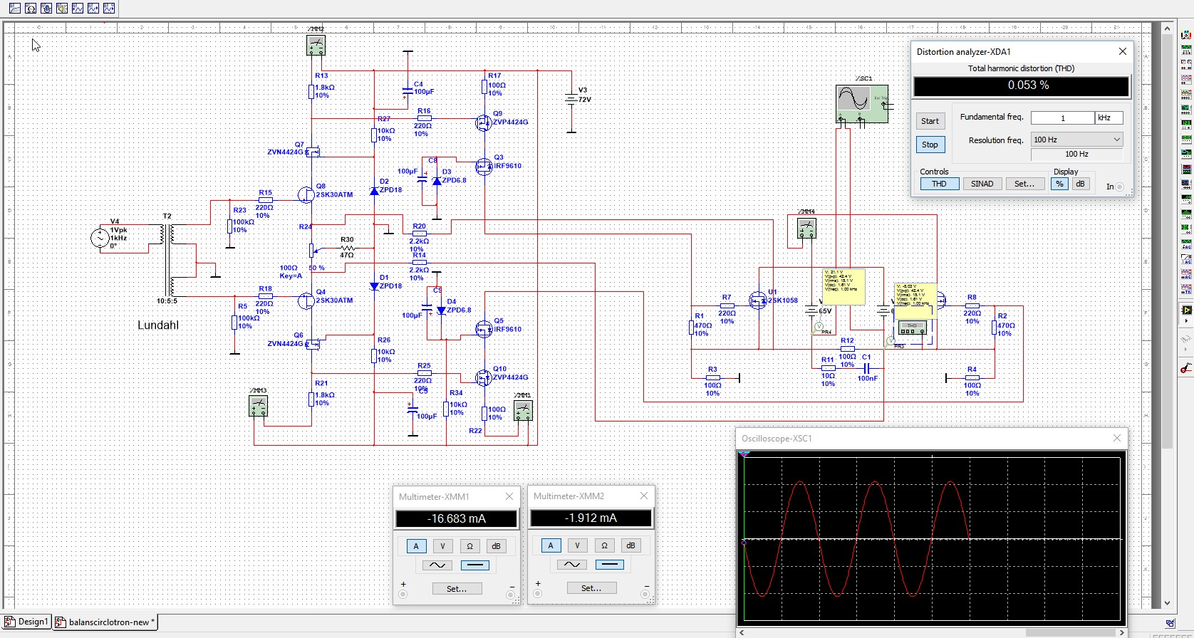

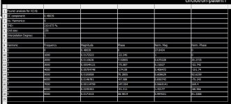

Pictures are from different setups, like laterals, hexfet or J-fet power and double current feedback.
Distortion photo let see that it is quite a friendly amp, the off harmonics are quite below the even harmonics and wil make this a friendly sounding amp.

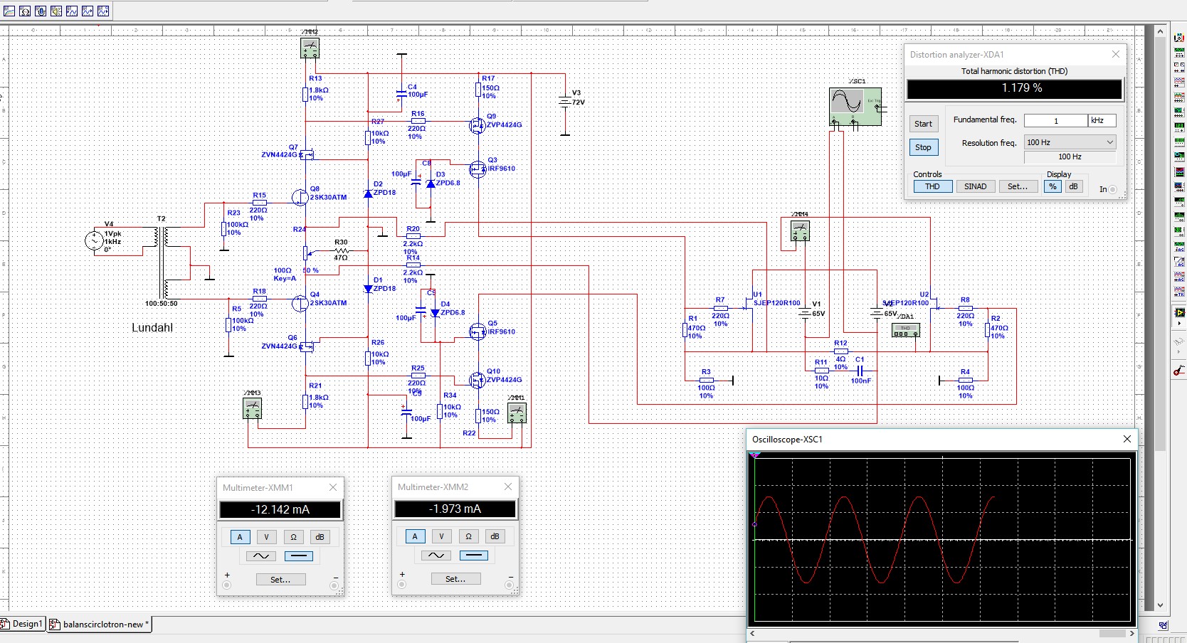

Only here I have trouble with feedback, it is voltage feedback and not double version so one half of the amp is not feedbacked healthy, the speaker is between them.

Thanks for all the nice designs Kees. It is interesting how the vertical FET IRFP240 has lower THD than the lateral FET 2SK1058.

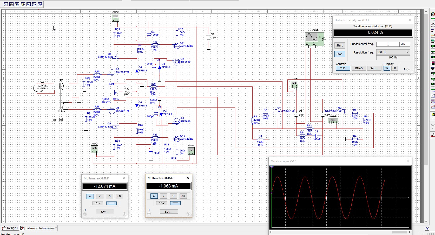

Is there a way to do this without an expensive input trafo? Is there a unbal to bal line driver made of silicon I can use?
If using a Lundahl, would this be an appropriate model - LL1690?
http://www.lundahl.se/wp-content/uploads/datasheets/1690.pdf
Why is the speaker load 100R and not 8R or 4R?

So here is the lower THD design:
I would like to get critiques from other members who are experts. We still need some sort of Vgs or Vbe multiplier so that will increase active parts count to 11 - still not bad.
Could a single-can SK389 matched dual JFET be used on the input stage?
Can you walk us through in words what the various stages do and why they are there?

I think the Vge multiplier can be made by substituting the two zener diodes that supply the voltage to the bias control on the driver stage. Put the Vge across both zeners and combine to one Vge multiplier with Q3 and Q5 gate connections. I don't know if it will work but maybe similar to how I did it to turn the FX8 into an FH9:
Look at the block around T7, R15, R18, and P1.
Replace MPSA42 with an appropriate FET mounted to same heatsink. Maybe IRF540?

The amp has some corrections, the zvn mosfets has quite a lot voltage and are just little plastic ones who can torse 200 mA, I have change the zeners so the voltage is not more then 20 volts and the rest go over the bigger irf9610 fets who are mucho bigger, I did use the small mosfets because of the capacitance who needs to be low, therefore I do uses cascodes, these also half the capacitance on his own.
I think what concerns run aways, maybe we have to build it and test, a temp sensitive resistor can do wonders.
Making a multiplyer on this one, you need a double one, a constant voltage source between the two driver halfs?, but even not needed when using laterals.
the sim does exectly what I want, it do very well react on the adjust pots, but need two idle adjust points because as I say it is a balanced one, using it as class ab will however rise the oneven harmonics, something I gess nobody wants.
