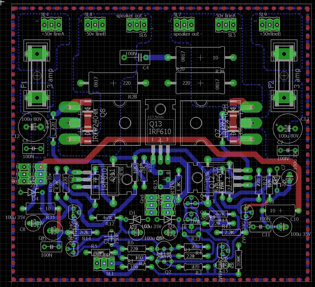

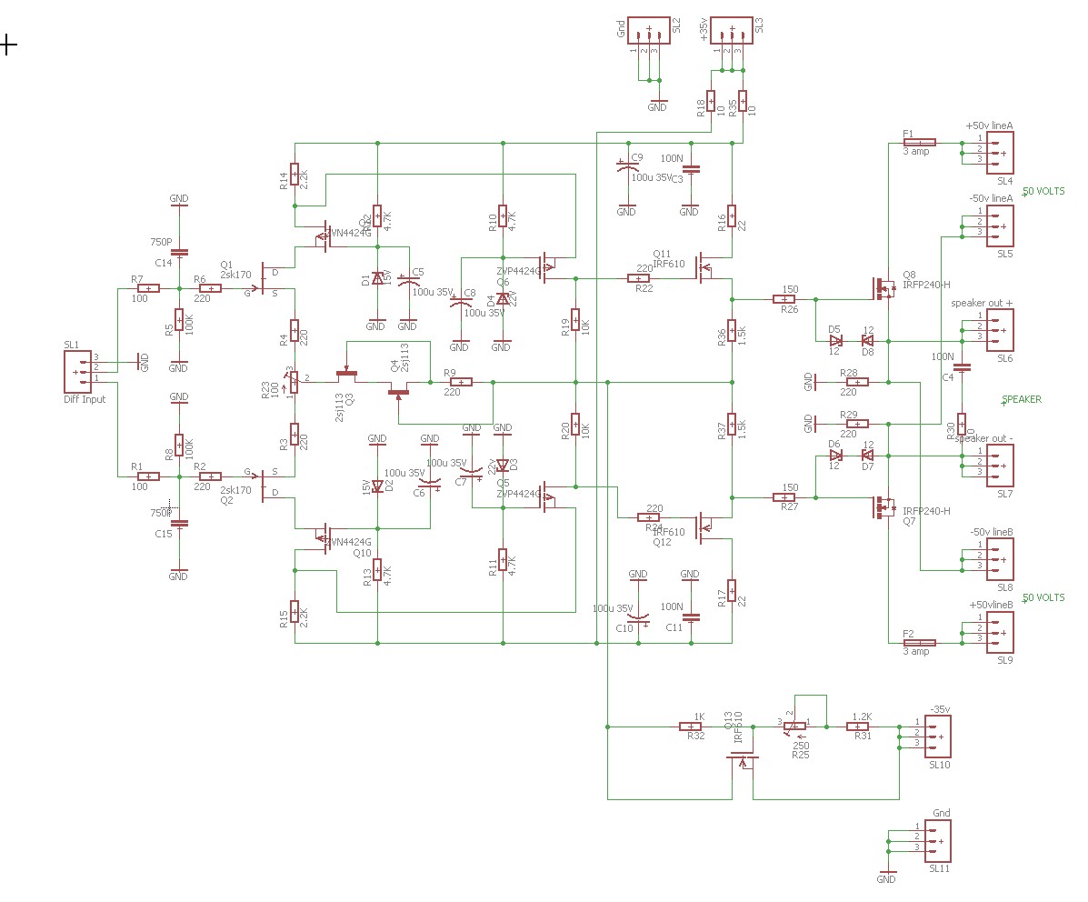

It is nice to see progress !
If you remove cascode part and add current mirrors be sure that K170 Vds is not so high ,
yes I see now why those two 680R(1K) resistors have to remain , in between they add some level of bootstrap to driver stage ,
DC offset is usually very small by circlotron OPS , but check for OPS-IQ stability with those power IRP`s ,

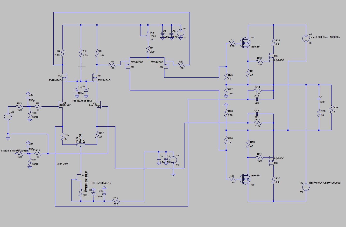

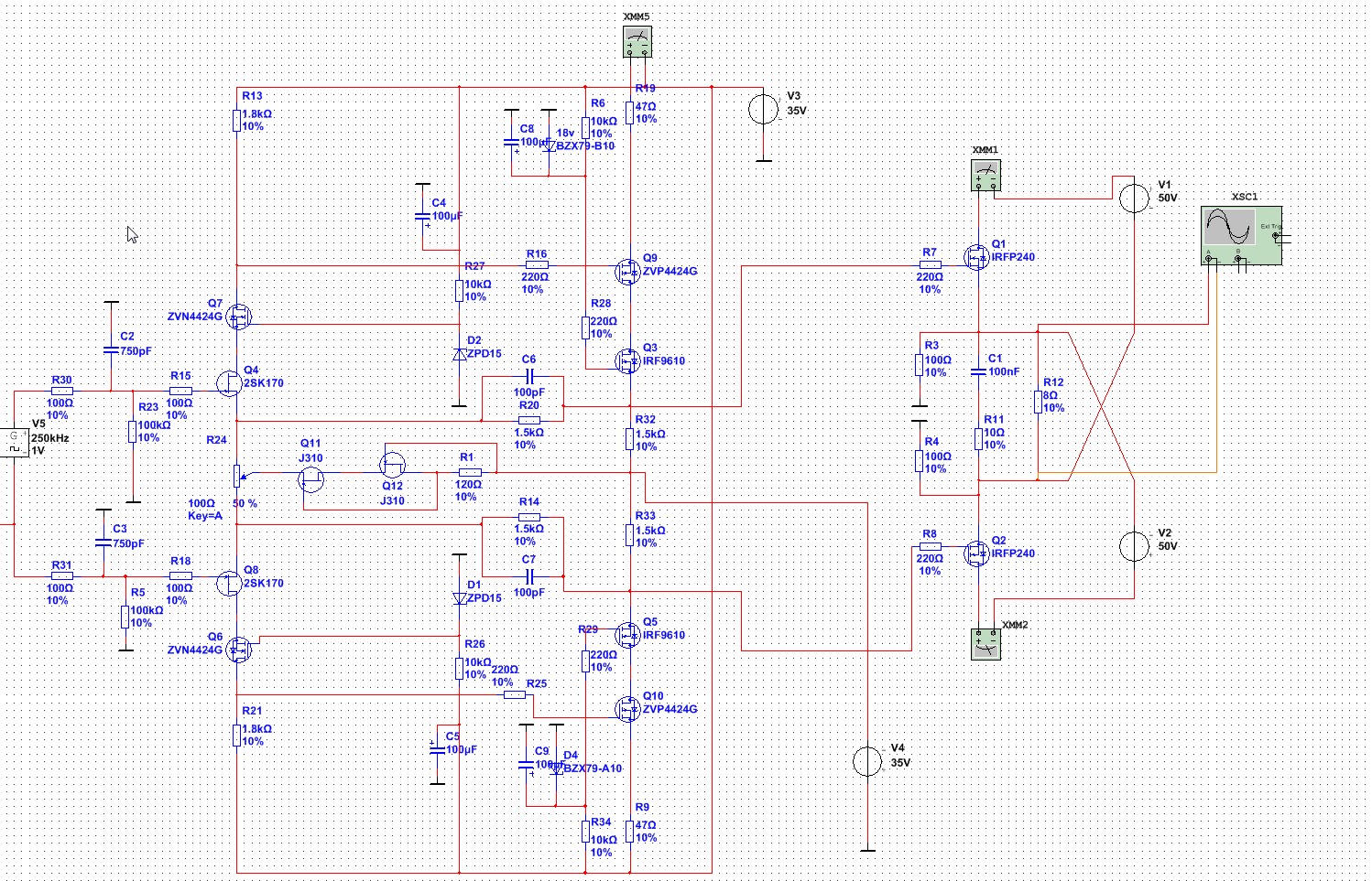

This is quite different Kees. No more P channel IRF9610. You are back to the J113 which was giving us such problems with not enough current. Are you sure it's enough his time?
You have 4 stages of amplification almost what is used for current driven BJT outputs here. 2sk170/j74 to ZVN to ZVP to IRF then to IRFP outputs. Does t need that many stages?
Impedance transforming and source follower need here some amplification, but it has no feedback, source degeneration is done here.
Yes we need this stages to be use of a source follower to drive irfp, the j113 is only in simulation, in real world we need change.
But this amp is for later care in winter maybe, making some pcb and test it.
This amp is balanced, I have even a cascoded one somewhere.
Ahh here it is, it has feedback now because it has high open loop because of cascodes..
Also long term project.
Anad the amp with one supply is only possible with balanced driver, mine is a single ended driver and when need 4 volts from ground to get the circlotron on give just 3 volts swing before hits ground, so I need negative supply 35 volts also.

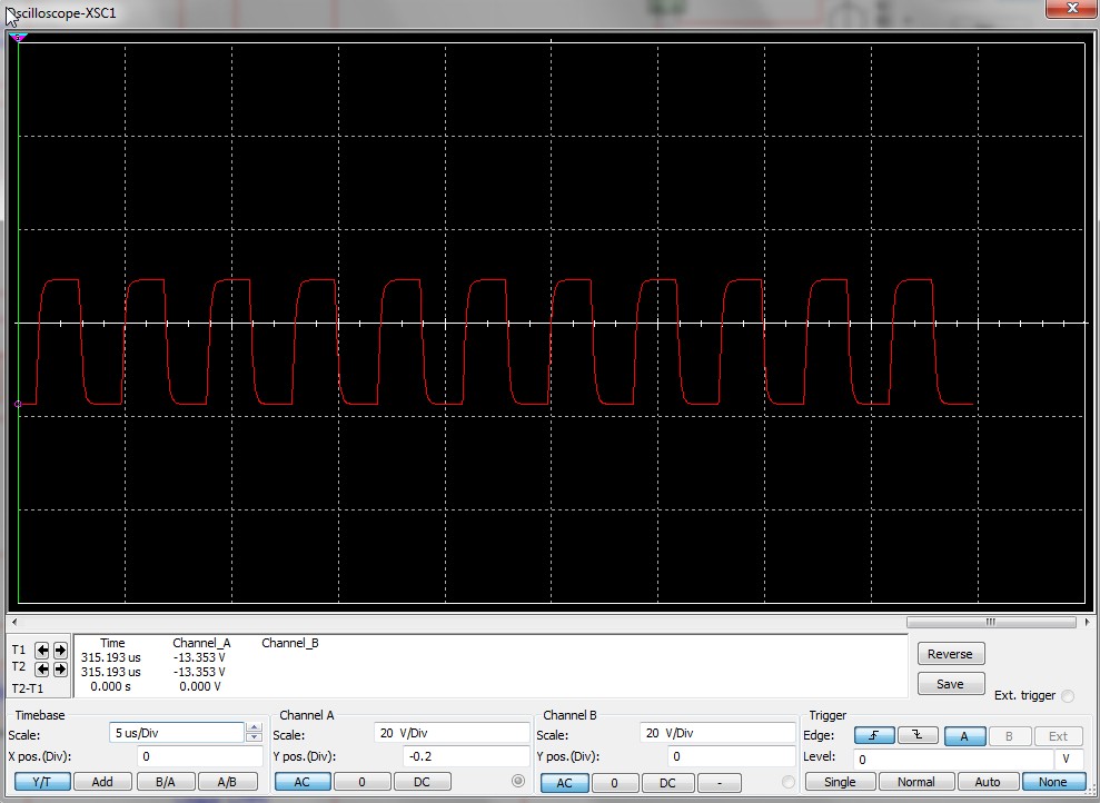

For the irfp 240 mosfets the joules yoyu need for driver them capacitances, and then special the switch of of the mosfets require in 20Khz already 1,5 amps driver capability, so our amp who has a drain follower needs to be biased miminal on 60 mA each.
Using HEXFETs in High Fidelity Audio
For slew rate to much is not oke, a good square on 20 Khz is way enough, most amps go higher tough, but worth to see how sound is affected.
I go look or to change the circlotron with a extra driver stage wh can deliver some amps can help, like the irf610 in soruce follower mode on the output.
Had somewhere also a compound circlotron design, this do amplifie on itself already 3 times with local feedback.
regards

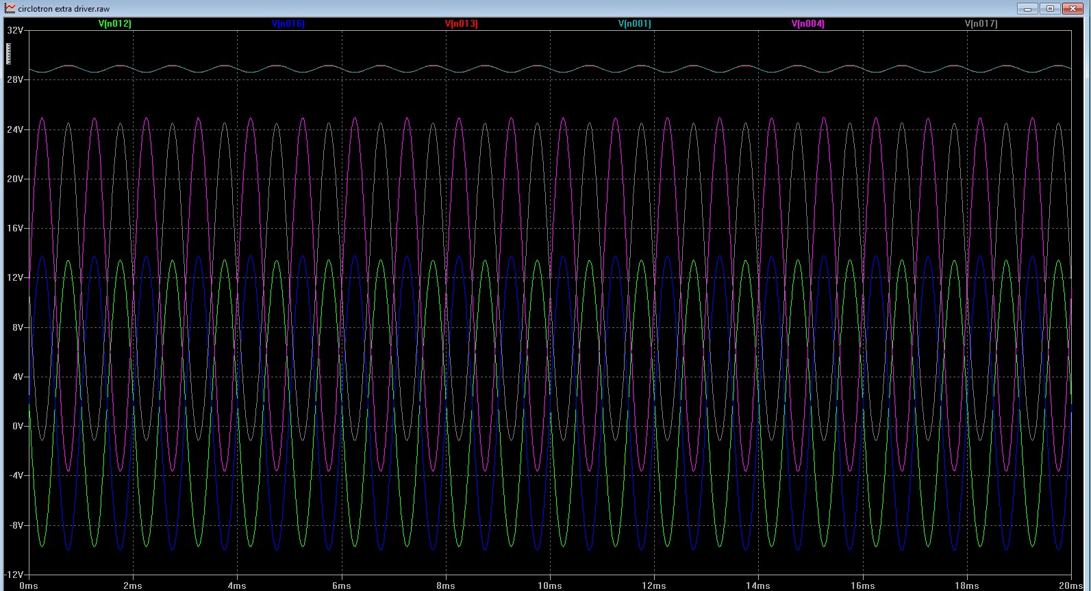

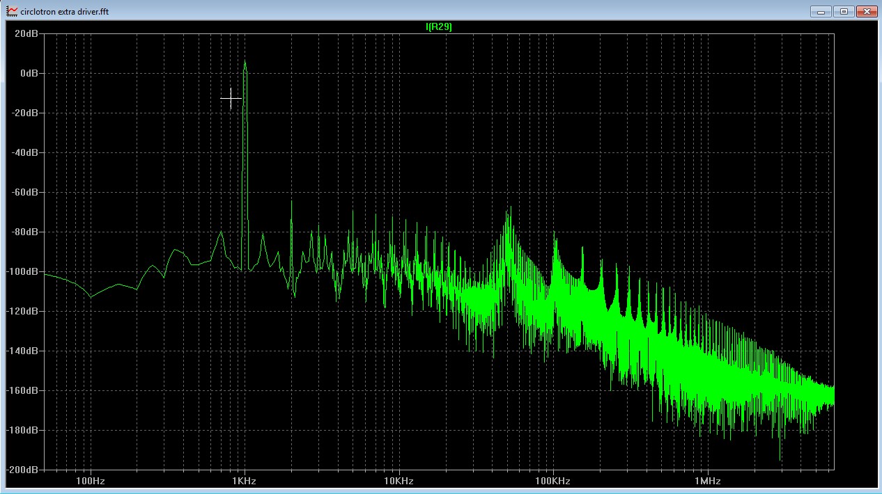

Oke Mister X
The extra driver section in the circlotron who idles in class A did really put down HD.
onder the -80dB and can drive the irfp240 properly with current and is low impdedance.
regards
regards
Nice work. I assume all sections are class A?
For the output stage, if you set high idle you get class A automatically, for some extent afcouse.
The circlotron section with the extra driver this is clas A setup, the driver in the voltage amp
do not, but maybe a good idea to do also, except the LTP who get trouble with temperature.
Now with the extra stage we have for all stages a nice sinusoidal respons.
But when do this we need a new pcb.
I do not understand how a j170 can drive a hexfet properly in the pass amps seen the high Cn of them..

btw , why don`t you try same amp but with OPS consisting of multiple pairs of standard K1058 device ? , they are relative easy do be driven in comparison with those power HEX`s .

seems to me that those power Hex`s are pretty difficult to be driven and is thermally also unstable ,well at least in this fully balanced amp configuration ,

I have not had problems driving heFETs in my other amps. I can get nice square waves and low harmonic distortion. Thermal compensation with BD149 Vbe multiplier had worked well too. CFH7 amp, FH9 amp, and FH11 amp.

But something else, I did see with the simulation that the amp swings also negative I do ask is this a disaster for the idle current causing harsing sound.
With the extra driver in circlotron I did see it swings from +1 to +20 and vica versa.

that harsh sound is caused probably from clipping of driver stage combined with OPS crossover switching , scope which can measure output balanced signal will reveal all those signals malfunctions ,
