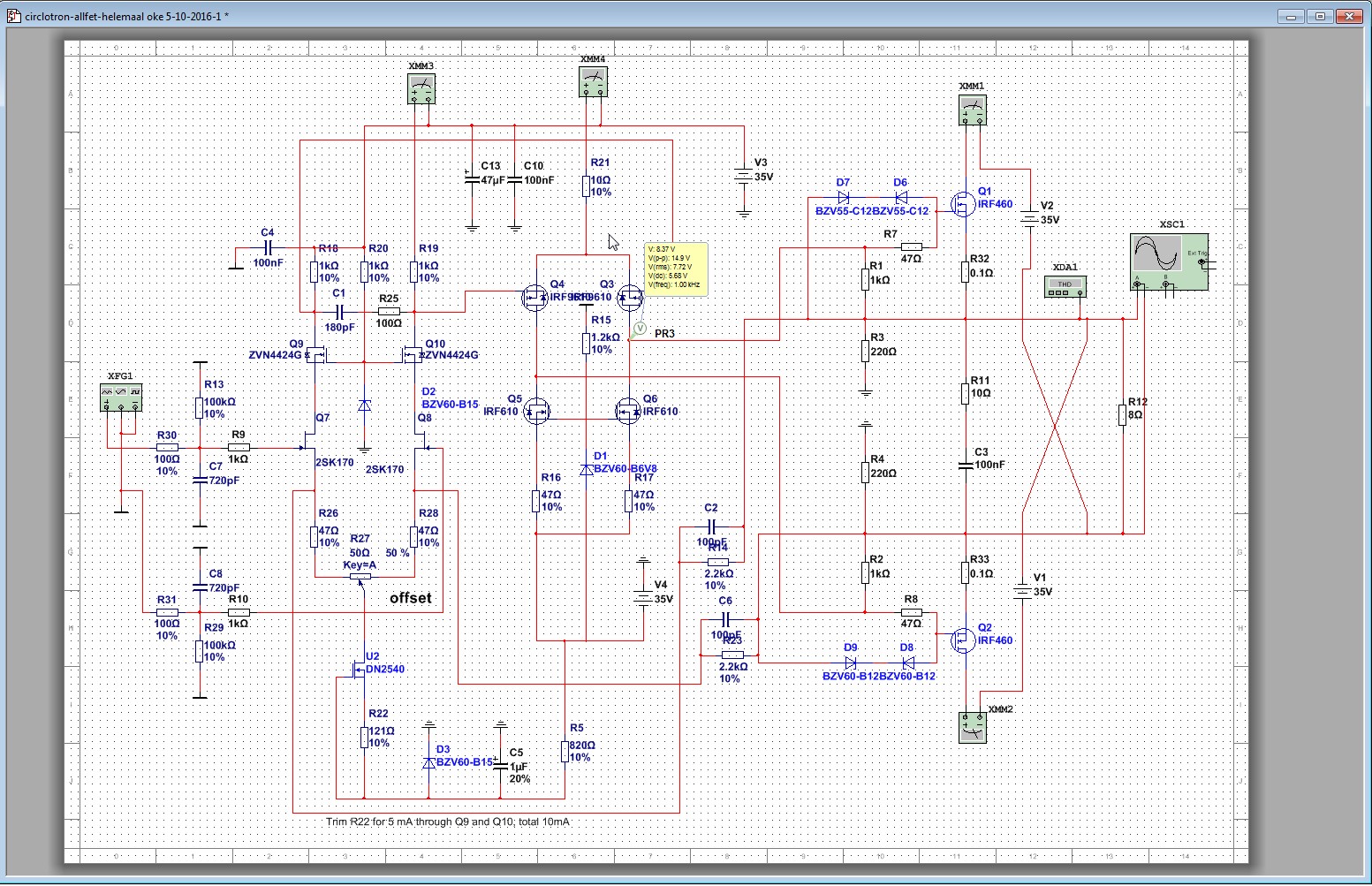

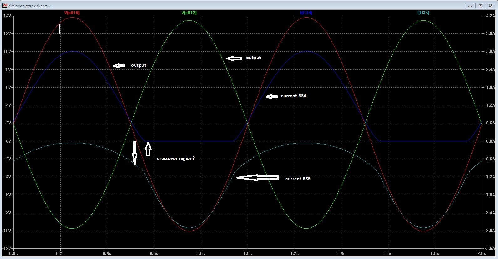

Oke
I have sim now after the dentist did a root canal who however was painless.
The amp I have go negative, as I see good when the circlotron do 500 mA at +3.8 volts gate voltage what happens as we drive the amp and the sinusoidal signal go negative for some volts when drive it some harder.?
I think on that point it has no idle left? see the pictures. Maybe I miss something here, can I drive a circlotron negative? because it is two singe ended amps in balans.

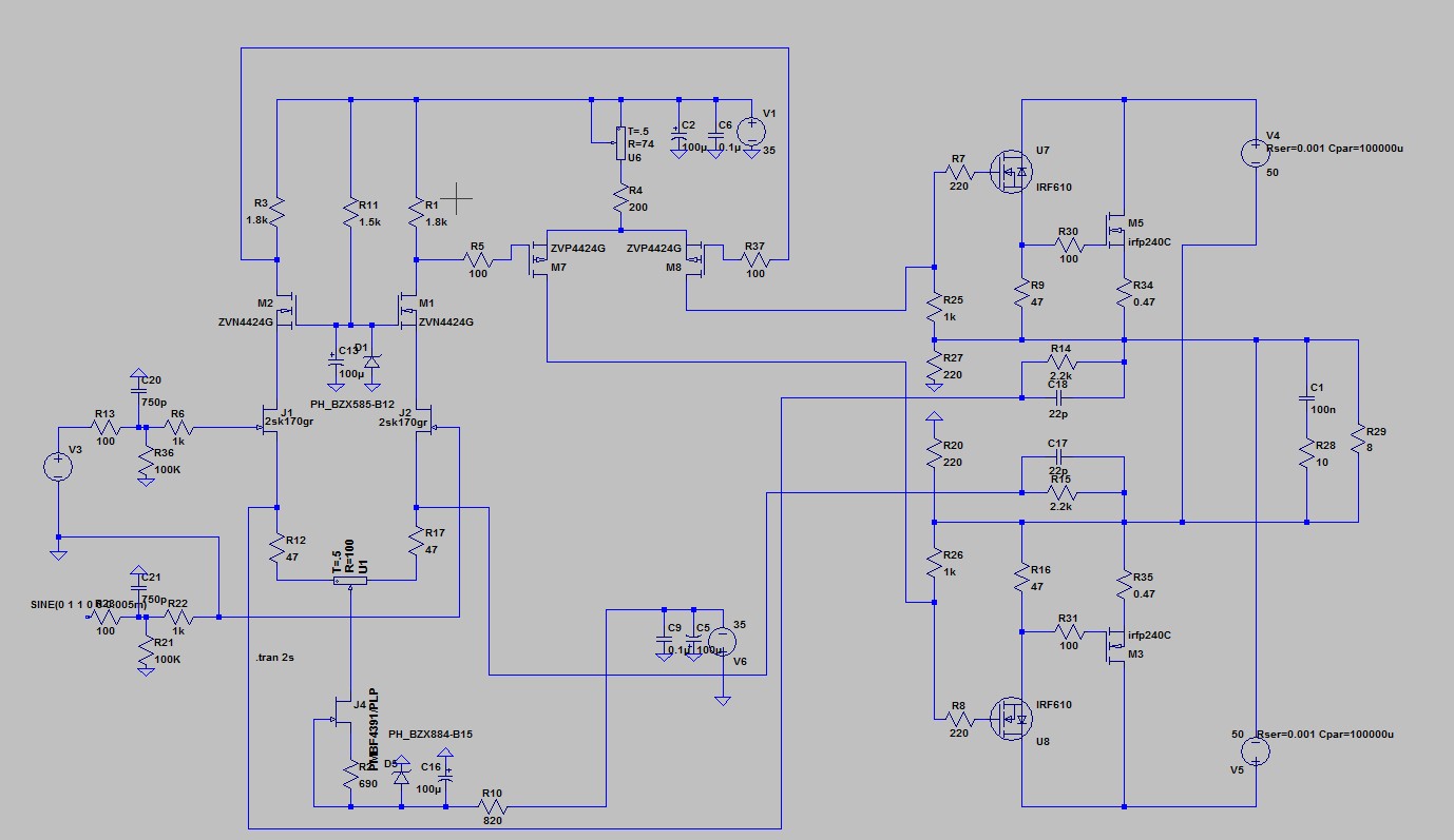

I try afcouse make a own amp from scratch.
And I learn of it also, wel after some simulation, it seems that the voltage from the drivers go negative some volts, and this go to the circlotron amp, what happens then is the sinusoidal signal get distorted on one side, because it pass then o amps, the other side go up and have no problems, this also is a fect with the other designs, we need to remove the negative voltages, only some 15 volts negative resides for the LTP.
if I idle the circlotron to 500 mA it still distorts whe I idle aboe 1 amp it stays above the o amp border, leaving a minimum of 200 mA left still to low.
see the pictures where I did low idle giving the flatten bottom tops of the sinusoidal and with 1 amp giving a better signal.
When I do set amp on low volume tthen it is not that problem.
We need a higher Plus voltage and a lower min voltage, when we change the mosfet circlotron to drian follower things are reversed, so we did pinpoint the problems I hope.
This is also why tha amp sound hars as we play loud, and very good if I do play low I did discover, so the sound of the youtube movie is low volume and sound not bad, but still some hars.

Kees,
I think you are right, the Circlotron on Pass DIY has single rail supplies... (their schematic is drawn showing P-channel on IRFP240 where it is actually N-channel as arrow should point in.), but SJ74 is P-channel JFET. I set up my PSU the same way - two independent 18vAC secondaries generating 25v. +ve and -ve is 0v both A and B supplies. So the -A and -B were in fact 0V but not connected to each other or ground. You will notice here, again that Pass drives an IRFP240 gate directly with a 2SJ74 JFET.
Furthermore, the article says it needs to run in class A otherwise there will be XO distortion and to do this requires minimum 1.2amps bias.

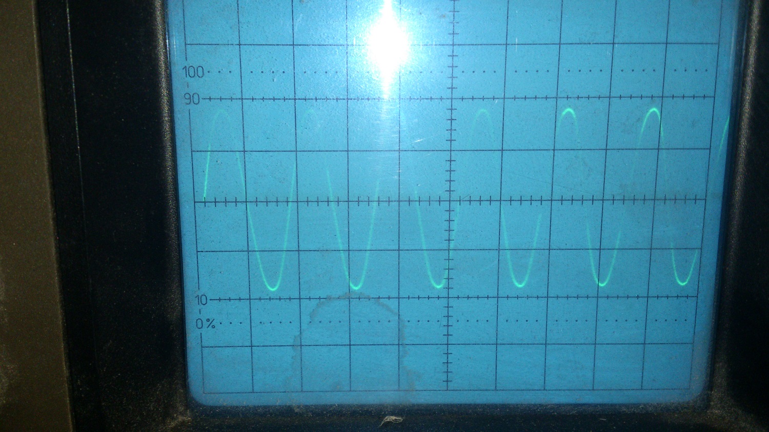

X

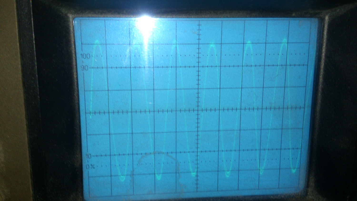

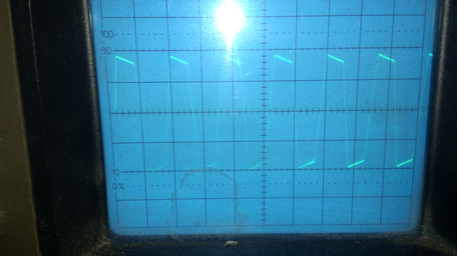

I have measure some things because of tooth pain so so I have some things to set mine mind on and forget the pain.
I have measure in 4 ohms, 2 x 35 volts driver voltage and 2 x 35 volts circlotron voltage.
Photo 1 = 20 mV
Photo 2 = 35 volts
photo 3 = clipping ( and smoking ballast resistor😱
On no parts I did see crossover distortions.
Still, I go now try lateral mosfets, current mirror in the LTP.
regards

X it can be used indeed, I have used 0.22 in mine and have correct schematic for it, further the biaspot is removed and the CCS is now the idle adjust place, it do much better and I can set the drivers in pure class a with 60 mA each.

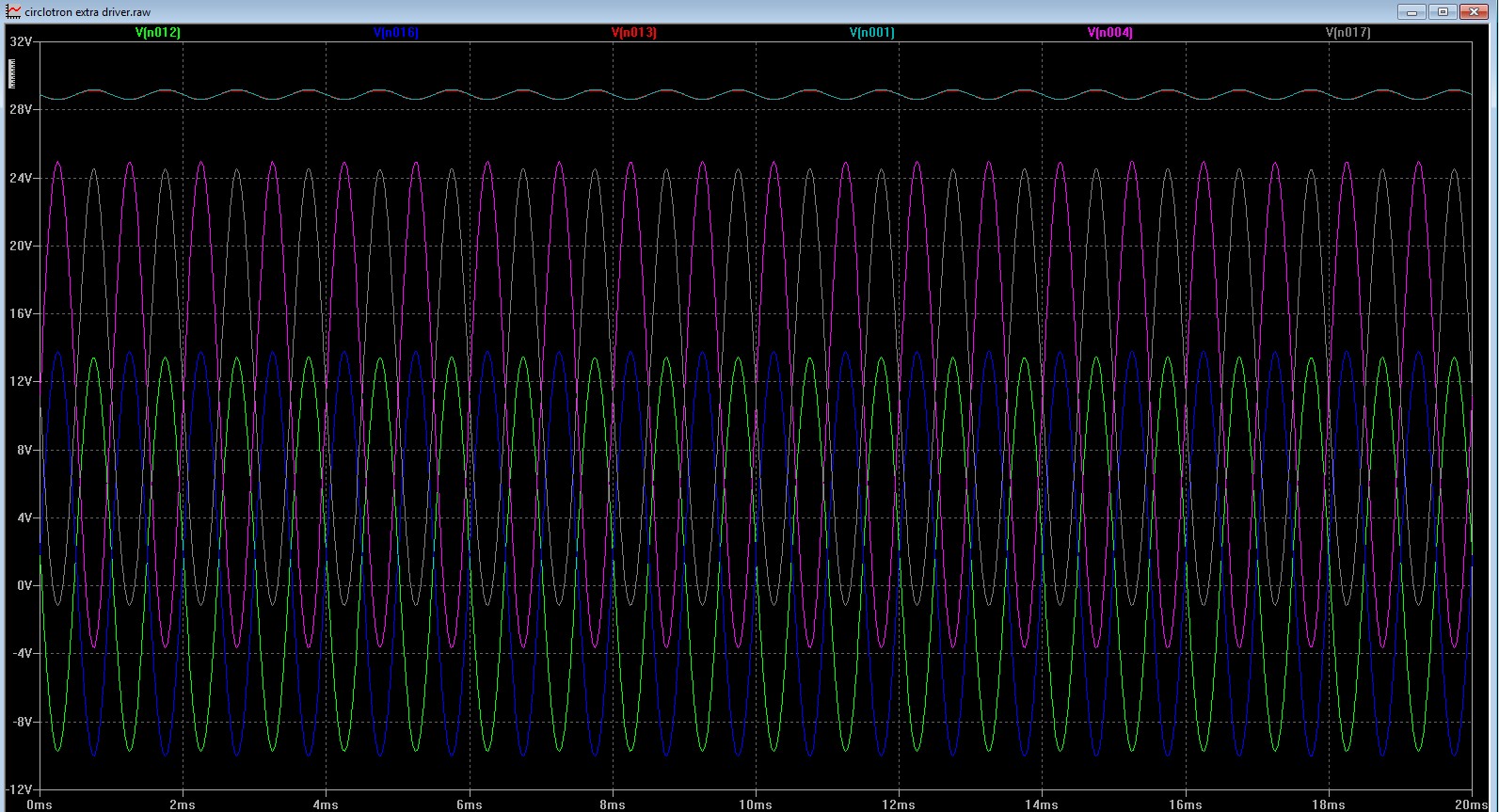

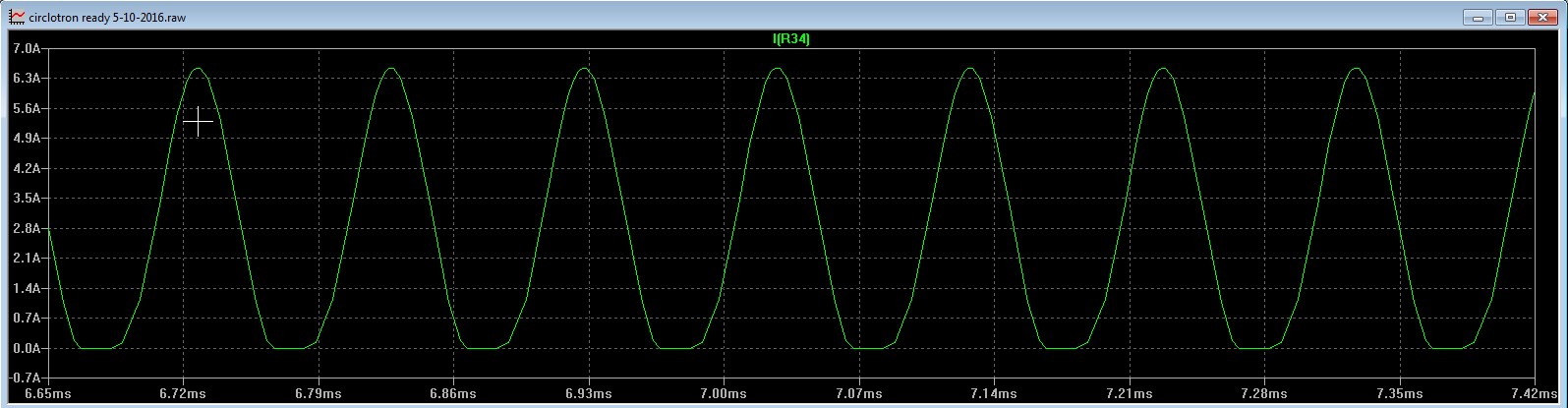

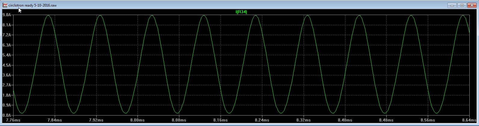

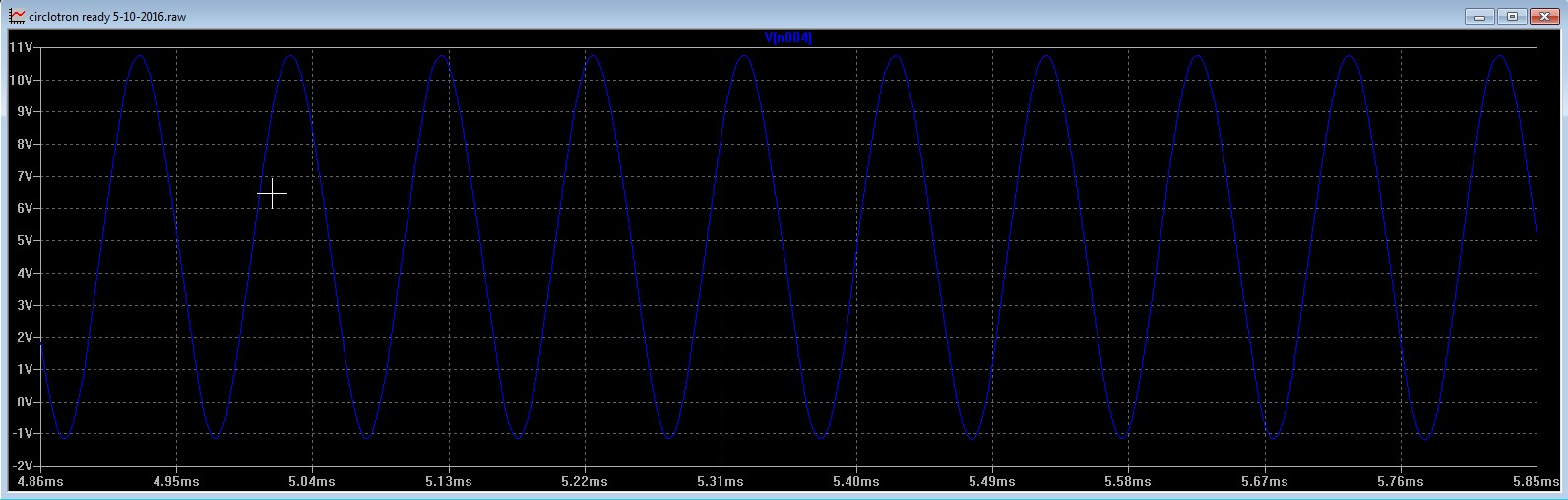

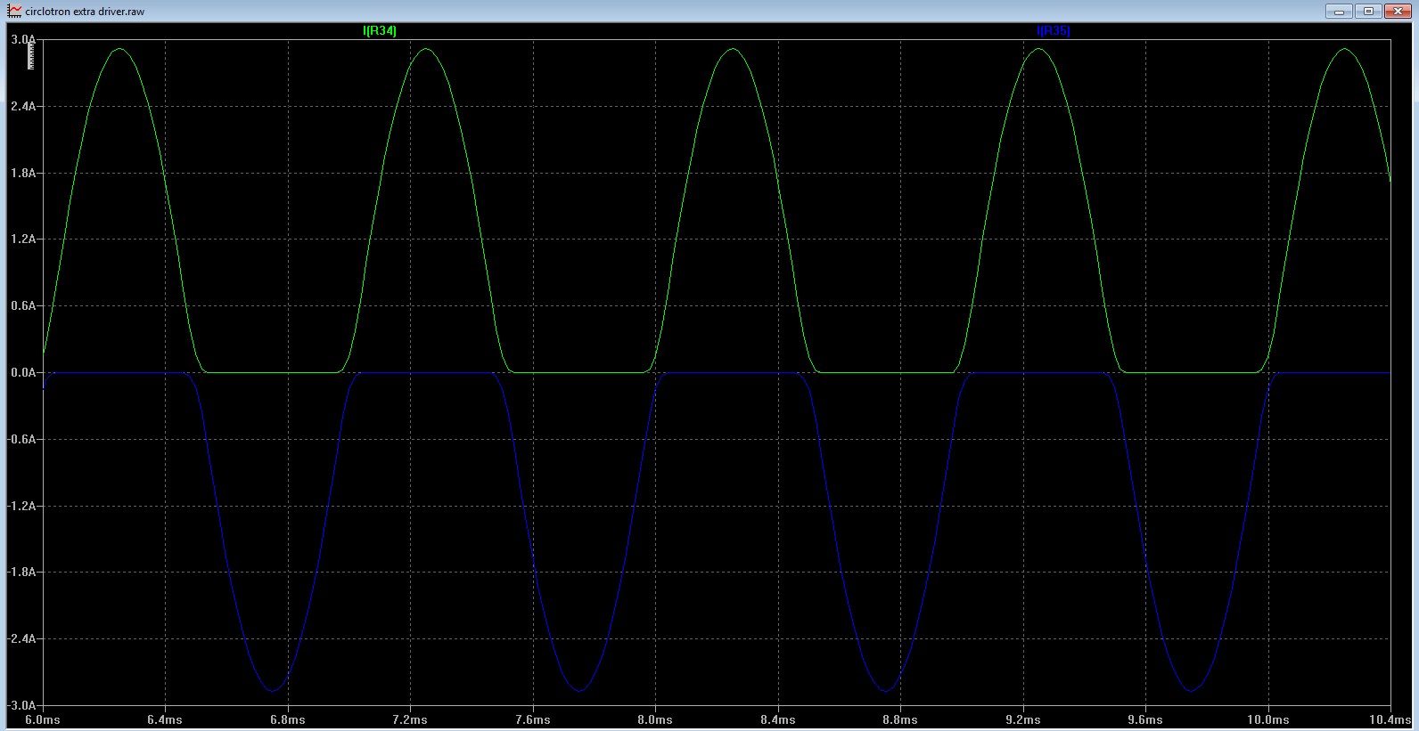

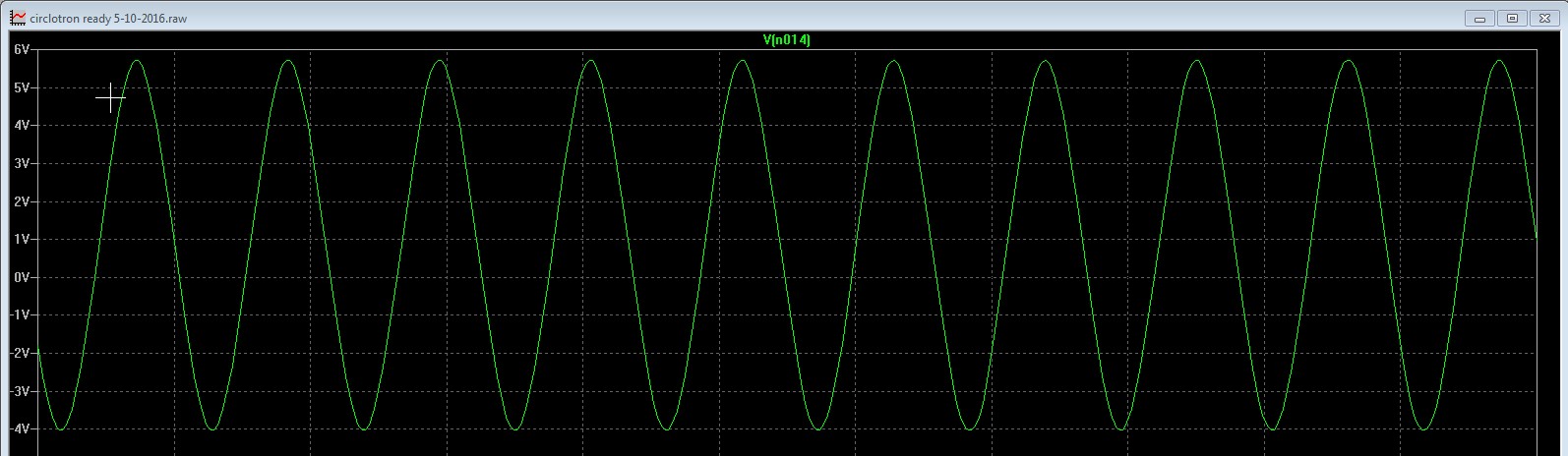

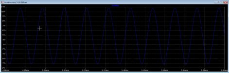

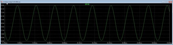

Still some confusion about the signal output who clip to supply in cirlcotron, this happens because the drivers get some volts negative and I do not now what is impact because of crossover, we had, in the new setup I have 80 dB or more HD suppression special the even harmonics the oneven are less supressed and is because the circlotro is a balanced output amp cancels out the even harmonic, that is why people like single ended amps and has Pass Labs also a single ended amp with on one side a high power current source,
uneven harmonics make amp less smooth sounding but afcouse it is all taste for different ears.

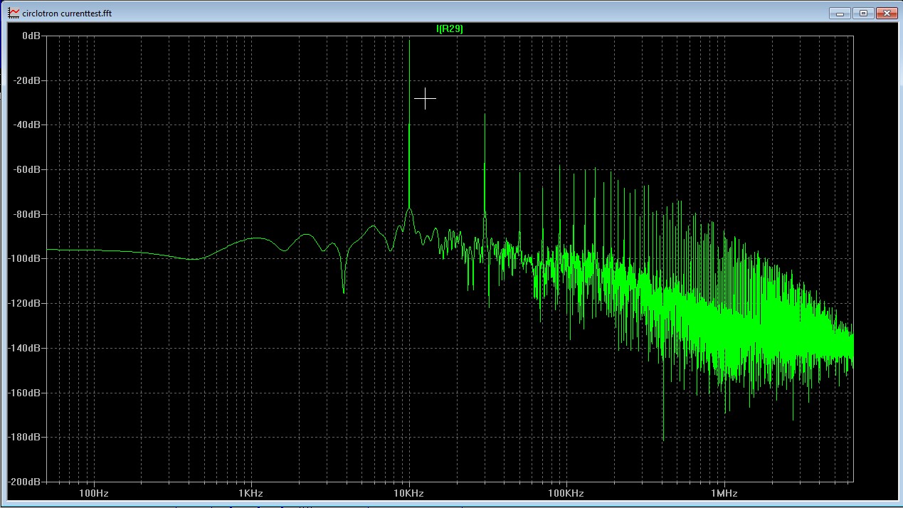

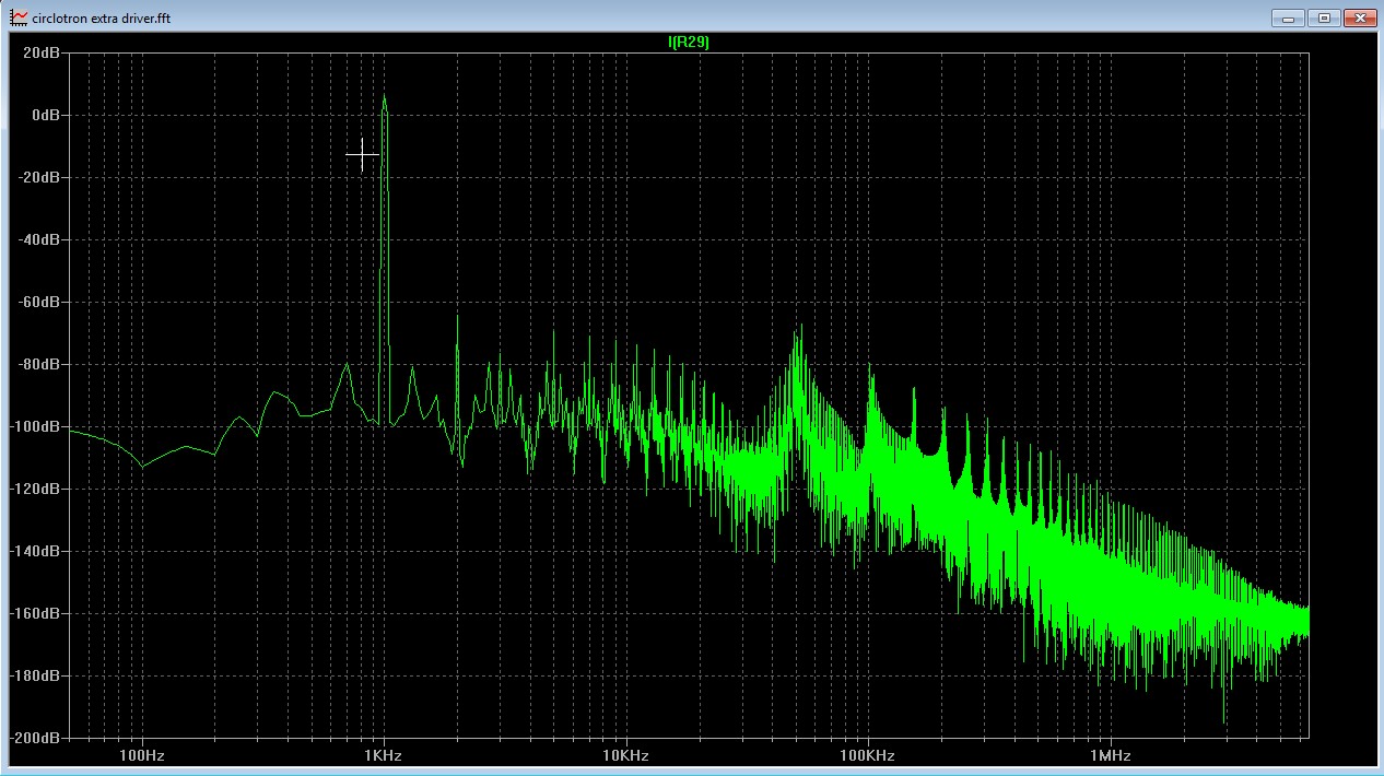

On picture two you can see that the output clips to the supply because of low idle current of 250 mA. picture one is idle current of 2 amps in sim, thirth
photo you can see the drivers get negative in lower part, who take the circlotron also negative, and I do not now id this has impact on the crossover, I can not measure crossover whith the scope, so it has to be fine and only in sim it is confusing.
first picture we have low distortion. and the two last pictures is how it performs after set drivers in real class A , this means the lower two irf610 do dissipate 2 watts and the above do 1.6 watts but it is way within specs.
