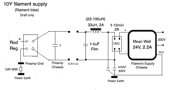

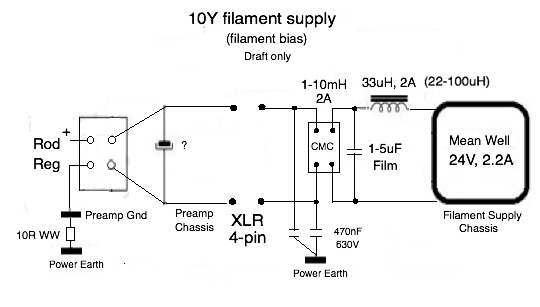

I've made a draft diagram - is this correct or what needs to be altered?
I have a friend who will be using a SMPS supply for a 10Y stage, and he will be interested to see this and may comment.

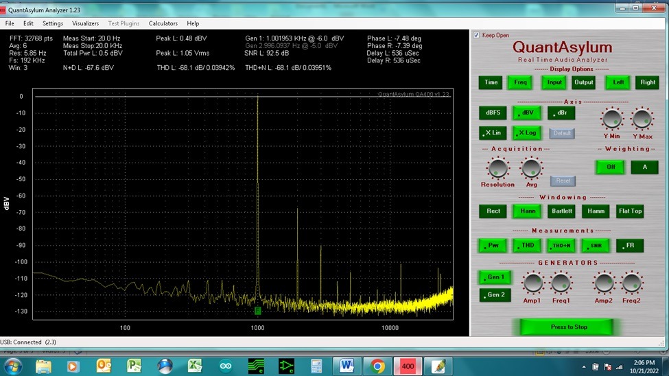

FWIW I used smps for B+ and filament bias and got pretty good results with a 71a. I did have some issue with the rca unit ground as there may have been some leakage, but after adding some input transformers for isolation and so I can have balanced in, noise was pretty much gone. I had some spurious noise at 11k and 20k+ but eventually got that sorted

Andy, please put the 33uH and 5uF on the RC regulator side; CMC directly on the converter output. CMCs usually have some usable differential mode inductance, anyway.
BTW, Avoid adding any electrolytic caps to the converter output: even 470uF can send them out of the stable region.
Take care when drawing PE symbols. The filter PE connexions go back to the converter input PE (short loops reduce impedance, and radiated emissions).
The chassis PE will need to have a longer cable, but should not be carrying much current, thanks to the diverting filters. Ideally it will connect fairly near to the converter PE but not directly to it.
Yes, the circuit in #245 is correct.
The 470nF pair of caps are diverting any noise current to PE (the EMC reference); the CMC increases the series impedance. Remember, there is a cap from output + to PE internal to the converter module.
Yes, 33uH-5uF is also near the converter.
No need for a cap at the input of V9, but with V4, a 470nF Mkp helps.

What value CM choke? I have some Epcos 18mH, 2A. Is that in the ballpark for a 10Y or what do you suggest? Is the CM choke followed by a cap or does it go straight into the filaments or straight into Rod's reg?
Your Epcos choke should be OK, although you may get much higher L to R ratio with a gapless core. For CM choke, the more inductance the better, but you wouldn't want the choke to be too large or have too much DCR.
Output capacitor - NO! That kills the whole purpose of chokes isolating power supply from filament. Capacitor across filament doesn't sound good. But this only applies if you don't use a regulator. Rod's regulator provides very good isolation, which makes chokes between supply and filament unnecessary.
