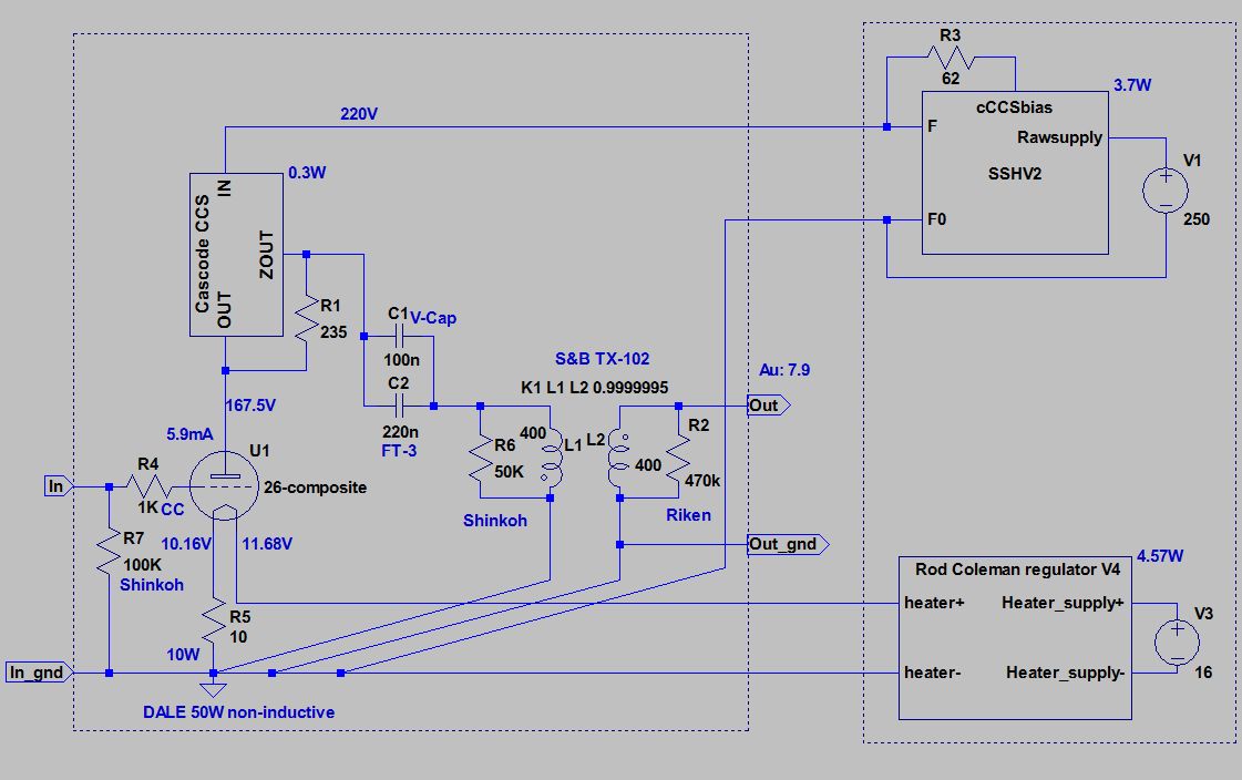

I attach my #26 preamp schematic (built a decade ago).My question was really aimed at your take on the penalty in transparency as a consequence of the resistors (divider). I have used the 01a without it and w/o AVC. Ale Moglia does advise to use the best resistors possible (of course!): "I will not repeat and say it only once. put the best quality resistor in R5 you can find. That’s my only advice as the impact on sound is significant."
As you can see, it's -almost- "cost no object" version for critical components (my daily used #801 preamp use similar -costly- parts).
If you want to build good, reliable tone audio equipment, the -final- components would be smaller part of the overall cost: designing, building, testing, measuring, iteration, iteration, iteration .... and -maybe- final state.

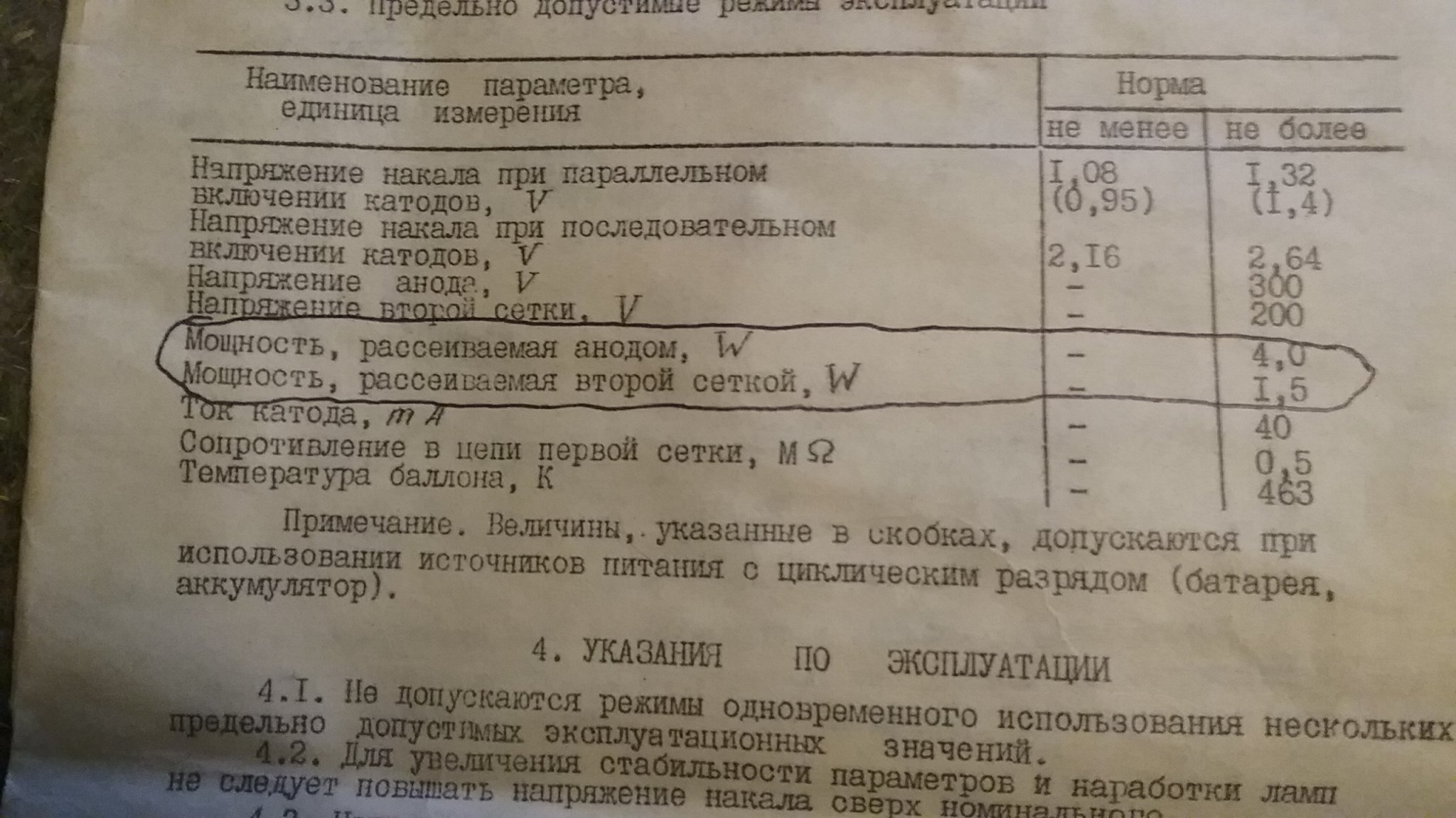

There are some data sheets that rate plate power at 2.5 W. But I have Russian data sheet showing 4 W plate and 1.5 W screen. I believe 2.5 W is for use in tight enclosures, like in aerospace equipment and missiles.

Not that this is terribly important, but instead of confusing someone I want correct myself and say that he was writing about the cathode resistor (R5), not the resistors for the divider. I was thinking about them (the needed quality and impact of those) while reading his post.🙄Ale Moglia does advise to use the best resistors possible (of course!): "I will not repeat and say it only once. put the best quality resistor in R5 you can find. That’s my only advice as the impact on sound is significant."
Thank you for sharing that. I see your attention to several resistors there, I have never really known which are more critical.I attach my #26 preamp schematic (built a decade ago).

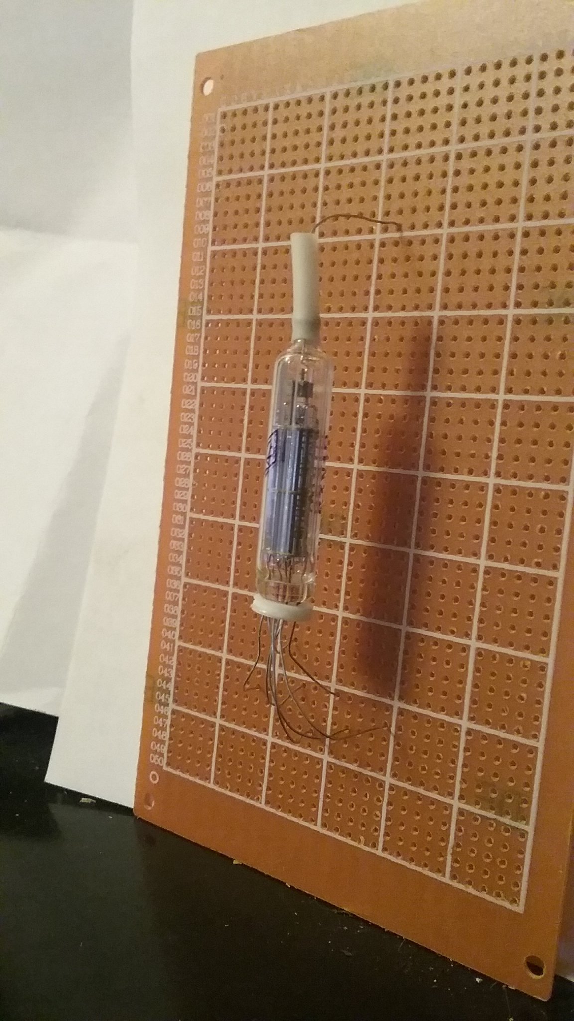

Tried 1p24b 260v / 15 mA triode connected fixed bias but 4 out of 6 showed thermal runaway, didn't stop increasing current; don' t know whether or when they'd have melted down. Had to cut back to 9 mA; anything over 2.5 W was unstable;... tried it at 280 V 18 mA with 1:1 bifilar interstage transformer. It was better than 46. The tube has very efficient filament that can ran on NiCd battery ...
maybe not with battery heaters and cathode bias ...?
Cathode bias should be more stable than fixed bias.1p24b 260v / 15 mA triode connected fixed bias but 4 out of 6 showed thermal runaway, didn't stop increasing current;
But first, what is the value of your grid leak resistor? Try using 100kΩ; measure the voltage across this 100k, to see if the grid is leaking current. If you get more than 0.3V (Ua = 260V), the valve may be gassy, and this will make runaway much more likely. That's quite often found with unused valves, >20 years old; if it's all-glass envelope, you can bake them for a while to reduce the gas.

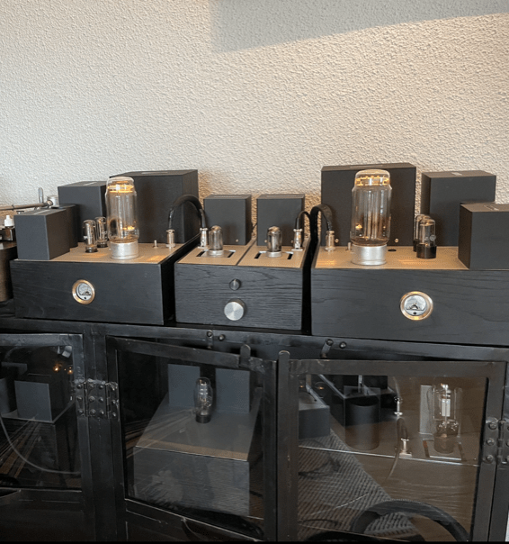

It looks super. The "Stove" style of the transformer enclosures is tough and impressive too. I need to get a new welding set!
I used 1P24B at 5 W dissipation for many hours, and there wasn't thermal runaway. g2, g3 and internal screen tied to plate. Fixed bias from battery, g1 circuit resistance 65 Ohms (input transformer). Tubes mounted vertically on prototyping boards for free air circulation, like this:
Here is part of 1P24B data sheet with maximum Pa and Pg2 circled:
hmm, maybe its because of your very low g1 resistance ...
I have between 150k and 250k depending on the position of the bias pots;
vertically free standing tubes as well.
