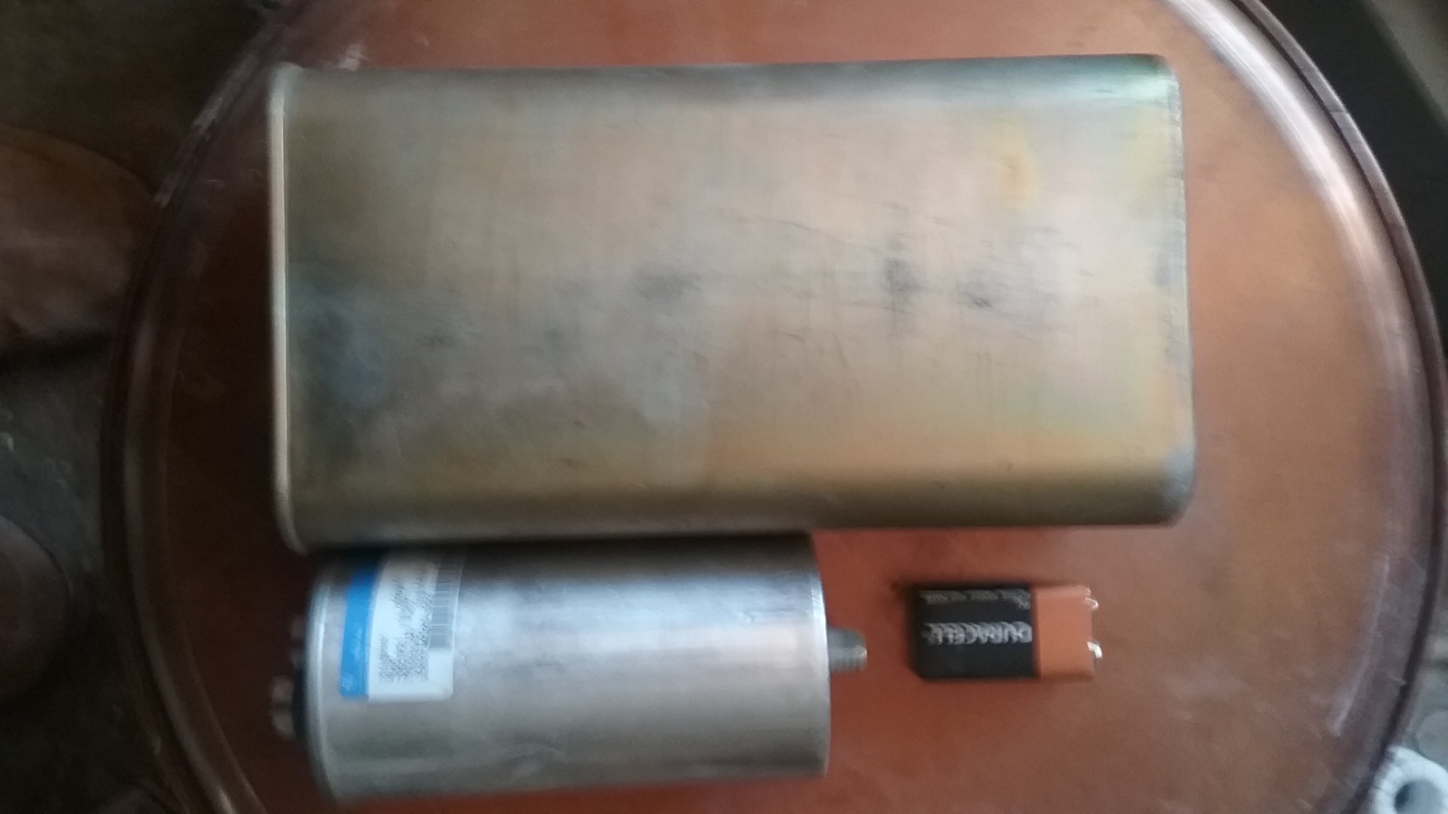

Size comparison of foil and metallized capacitors:
Top: 50 uF 440 VAC foil.
Bottom: 45 uF 660 VAC metallized.
9 V battery for size.

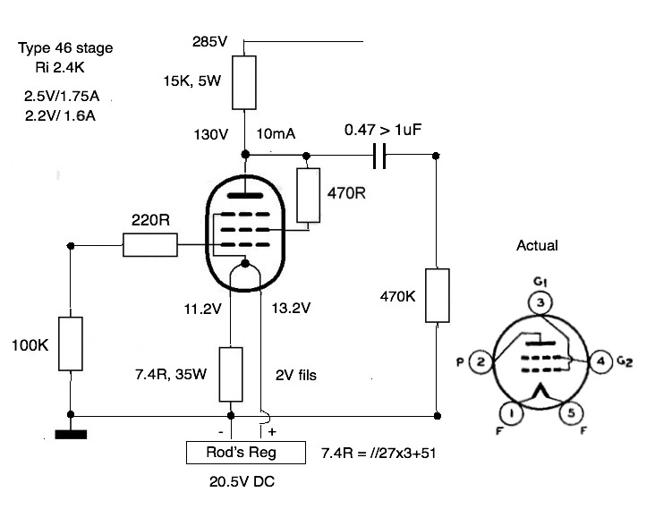

Here's the 46 input stage I'm currently using. I really like it. SUT is Hammond 1140-LN-C, 1:4, which replaces the 100K grid resistor.
Sound is very fast and clear with good treble. Particularly lifelike on jazz recordings. I was a jazz musician for 40 years and it really takes me back to being on the bandstand.
Mu of the 46 is 5.6 rather than 8 for the 10Y and 112A I've also built. Just enough for me with not much to spare. But worth it for the sound.
Coupling cap in this case is 0.1uF teflon FT-2 since it goes straight into my 2a3 outputs.
