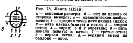

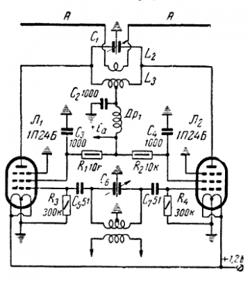

While going through those russian datasheets I discovered a strange inconsistency:
All rod tubes with dual filaments (1j29b, 1p24b, 1p22b) list the CT as "plus" and both outer terminals as "minus" in russian ds.
However, russian schematics and app notes have it the other way round, namely CT at GND and outer terminals "plus".
Don't know whether it matters ...

Sorrento - I know that cathode current significantly contributes to filament heating only in rod tubes with very low filament current, like 1J24B, which has 1,2 V 13 mA filament. 1P24B has 1.2 V 240 mA filament, so extra 16 mA of cathode current should not contribute much to heating. Data sheet says 0.95 to 1.4 V filament voltage is OK.
I use parallel connection of filaments.
Yes, all rod pentodes have two identical sections connected in parallel, but only in 1J37B the two first grids are connected to separate outlet wires.
I think it doesn't matter which filament end is negative and which is positive, as long as the negative end is on the ground side.

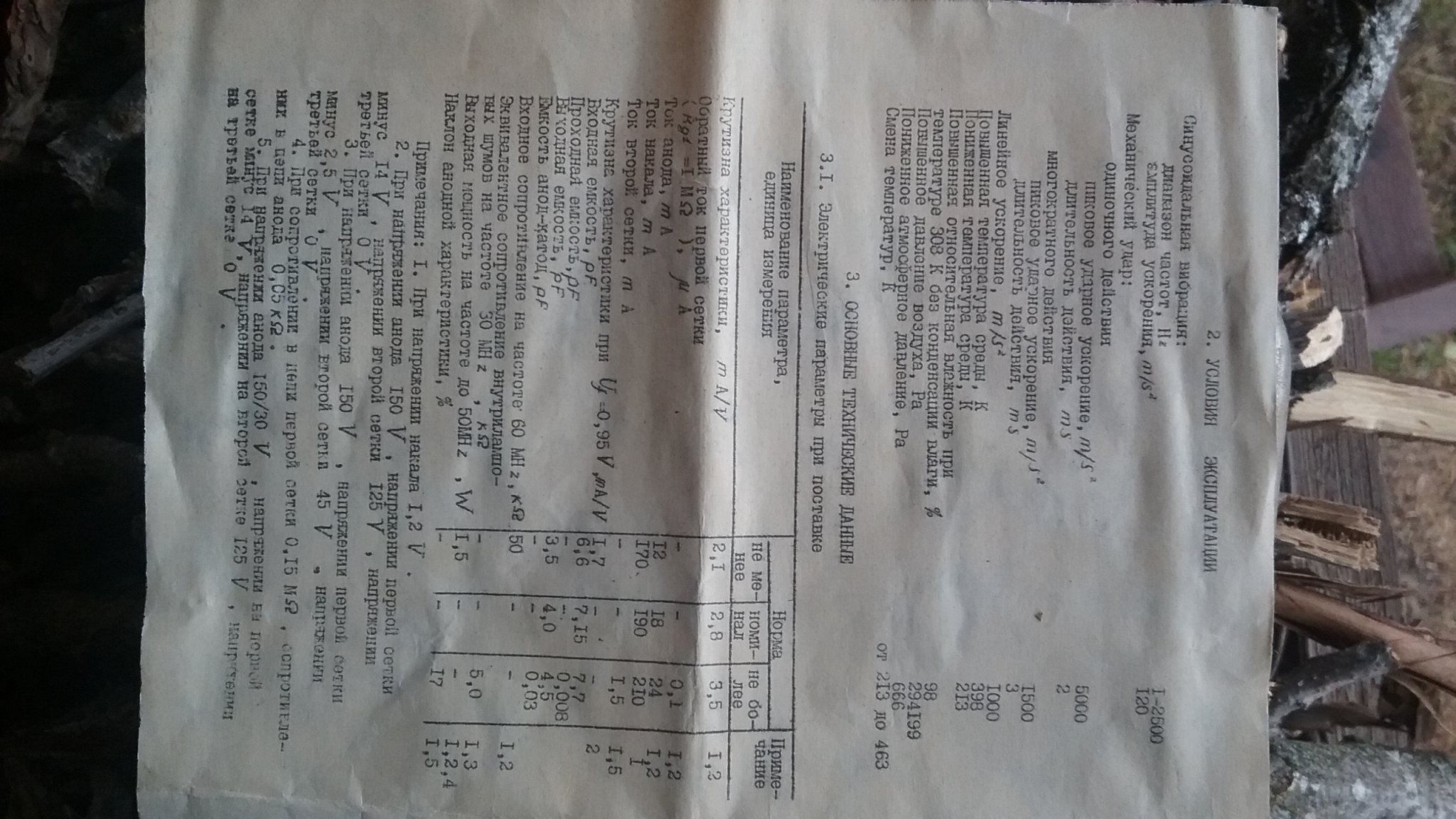

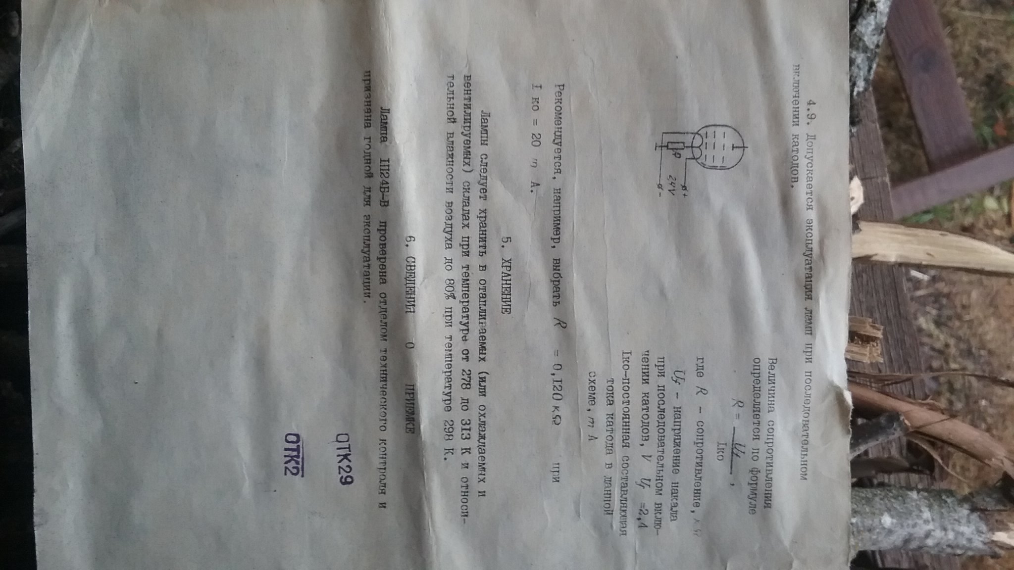

Will post full data sheet shortly.
1P24B-V data sheet
Page 1
Page 2
Page 3
Page 4

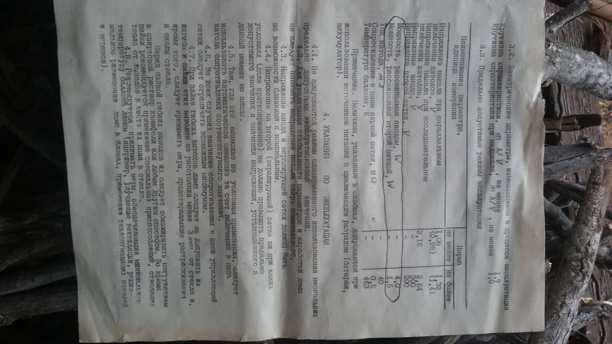

I noticed in the data sheet that Ug2 should not exceed 200 V and should never, even for a short time, exceed plate voltage. So, from this warning, it would be sensible to connect screen and plate with a resistor whose value is chosen so that Ug2 is about 180-190 V. This should not change triode characteristics significantly.
Also, maximum bulb temperature is 190 C, which is pretty high.

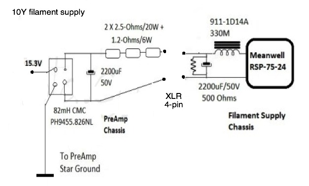

Here's Sridhar's circuit. Any comments or suggestions for improvement? Will this ever rival a linear supply?

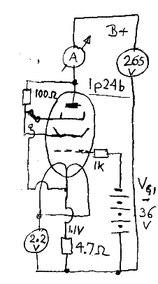

In the meantime I have done some more experiments to solve the thermal behavior issue I am having.
Disregarding the UG2 max ratings of course ...
The breadboard setup is like this:
All powersupplies are from a stabilized Lab PS, adjustable.
The setup is as in my application, except that G3 can be tied to either cathode or plate and G1 voltage is applied low impedance to grid, giving grid current no chance to change bias.
1 st case: G3 tied to cathode:
that seems to be the worst case, runaway whenever dissipation exceeds 2.5W.
Unfortunately that is what I did...
2nd case: G3 tied to plate:
Much more stable; I can now carefully and slowly tune bias to some 18mA or 5W and it seems to stay there.
It seems so ... until I turn off plate voltage and let the tube cool down.
After re-applying power to the now cold tube, plate current is down at 11mA ... and stays there ! With a much cooler tube .
Of course I can bring current up again by either more plate voltage or less grid bias and it will again look stable.
Until the next thermal / power cycle.
It seems that tube temperature as a whole has a big influence on tube current.
With G3 tied to plate it now seems to find a stable thermal equilibrium.
But ... this equilibrium depends on temperature ... !
The problem with this is:
If I tune bias to a dissipation of - say - 5W then its fine and pseudo stable at a high bulb temperature.
But on the next cold start dissipation is down to 2.5W and because temperature at lower dissipation stays lower it never returns to the higher.
Unless it is forced to do so by re-biasing ...
Now one might think that's easy to solve: tune bias when tube is cold.
But unfortunately this tube is small and heats up quickly. By the time I am through with tuning its already hot ...😉

Andy, you need -at least- 19V DC (rather 20V) before R.C. V4, so must to use Ohm's law:
24V - Ifilament * (DCR of first choke+series resistors between caps+DCR of CMC)= 19...20V
Yes, I know. I really want 24V - that's what I planned for. The V4 regs need 6V headroom, though the V9 needs only around 3.5V. The adjustment on the Mean Well goes up to around 28V. So hopefully should get there somehow. Haven't done the exact calcs yet - depends on the parts. Don't worry - I use Ohms law and many other calcs all the time, I have all the calcs in a huge Excel spreadsheet which I'm always adding to. I'm a psychologist so I'm used to spreadsheets and calculations.

Thanks for sharing your experience. I am still puzzled with the power discrepancy between different data sheets. I have seen original Russian data sheets with 2.5 W plate and 1 W screen limiting dissipation. What to believe?
One possibility is that there was an up-rated version of 1P24B. The data sheet that I posted came with a factory-packed batch of 50 tubes. I only used tubes from this batch.
One thing sure is that 5 W power may be too optimistic for a generic 1P24B - in the absence of data sheet for a specific batch.

Why using SMPS if you can make a perfect (or almost perfect) linear supply?
SMPS use capacitor input filter in front of the oscillator. In addition to RF noise, they also produce broadband audio rectification noise. From the engineering point, it is better not to make noise, in the first place, than trying to suppress it. Noise suppression is a non-trivial task.
My favorite approach to DC filament is center-tap transformer secondary, two slow-switching diodes with as low forward voltage as possible, choke input filter with large smoothing capacitors, and CM+DM chokes between filter and filament. No regulators.
Your ds is for the -dash-v ... the 1st I've seen, maybe that makes the difference ?
The common ones all have the lower rating as attached.

I also use choke input filter + choke between positive supply and DHT filament. But only DM chokes. Any CM choke recommendation for tubes such as 01a? Thanks!
CM choke is very simple to make. It is bifilar wound, with wire of appropriate thickness for the current, on any gapless core, EI alternate stack, or (preferably) toroid. Forward and return wires to filament are connected in a way that DC runs opposite directions through winding halves, thus cancelling DC magnetization. I particularly like o-cores (round cross-section) from AlphaCore, which is now part of Goertz Audio. Low prices, and they do small orders.
Same here - large DM choke for my 10Y stage in filament bias, 128mH, 2.7A, plus 10,000uF capacitor. So is the right place for the CM choke after the cap?
What value CM choke? I have some Epcos 18mH, 2A. Is that in the ballpark for a 10Y or what do you suggest? Is the CM choke followed by a cap or does it go straight into the filaments or straight into Rod's reg?
