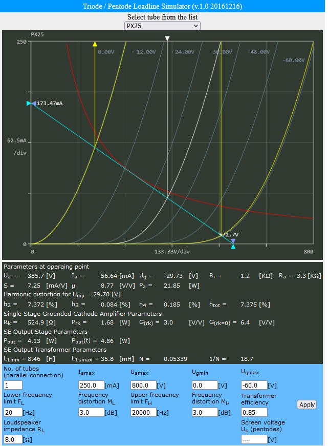

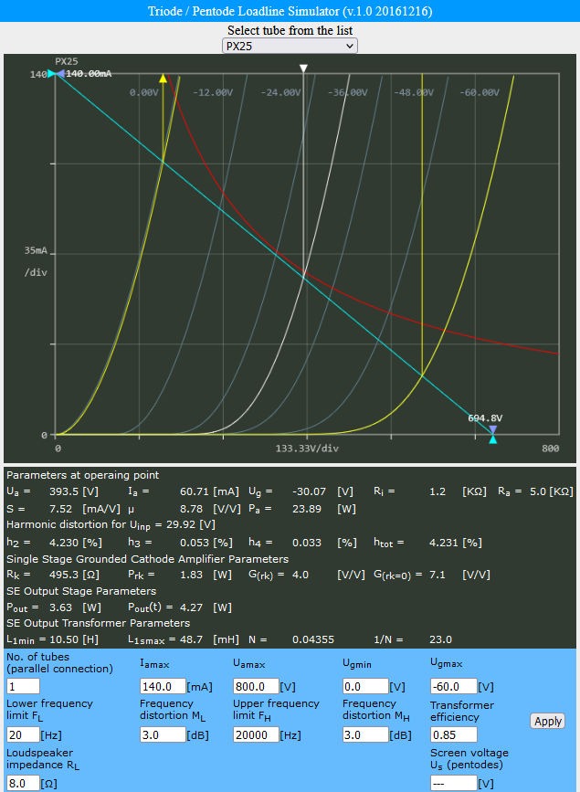

Hmm..what would the source need to be capable of swinging to drive a PX25 at input via a 1:2 SUT, and for full output power?
Around 2v if you use a decent CCS to load the first tube. If you look at the data sheet you will see that the maximum recommended bias setting is at 400v and -31v on the grid. So to we know we are going to need to swing twice the bias voltage in order to drive the tube to max output or 62v peak to peak.
We also know that the px25 has a gain of 9.5 and you can get reasonably close to that figure if you load the peamp px25 with a ccs. But lets say that you are using a used nos tube and it can only get a gain of 8. So if we divide 62 by 8 we would need an input voltage of 7.75 peak to peak. Divide this number by half to account for a 1:2 step up transformer and we get 3.875v peak to peak. If you convert this number to RMS, the input voltage needs to be about 1.37v rms.
So I figure if you have a standard 2v rms dac output, it should be able to drive the amp with a little bit of headroom to spare.
The only real gotcha is that your dac has to have a reasonably low output impedance so that you don't roll off your highs. Preferably the output impedance should be 2K or less.

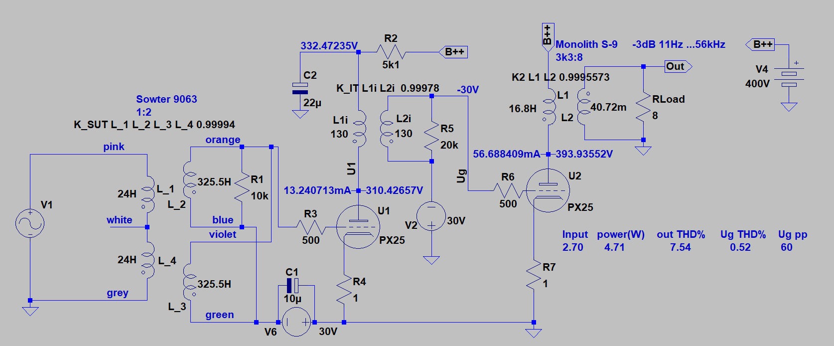

@daanve: from a simulation point of view, this is irrelevant. If that bothers anyone, change the secondary outputs.
This schematic origin was a pure transformer loaded preamplifier, where input signal and output signal was "in phase". I reused it to model this amplifier.
BTW if you want to make -in reality- "phase correct" tube amplifier, usually one phase switching needed. The most critical is the OPT, so it must be done in previous stages.
When using dots to indicate transformer phase, draw correctly, or don't use dots.
You specify Sowter input transformer and Monolit Magnetics output transformer, but I don't see which IT is suggested.
It depends on the IT properties. With a 1:1 bifilar wound IT you must connect phases correctly.
In a two stage SE amplifier, input/driver tube and output tube switch phase. When phase correct transformers are used, no switching is needed to get "absolute phase correct" signal at output.

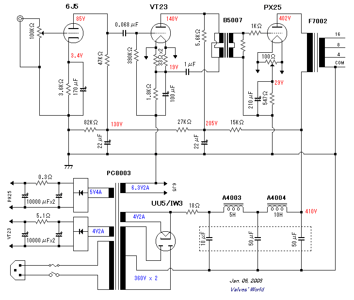

Anyone got a schematic for a 2-stage px25 amp and dht driver? I’ve always wanted to try such an amp out.
I only have 3 schematics for that tube, this is the closest:

It's one of my Slagle 1:1 IT, but it's indifferent. Any 1:1 appropriate IT usable... but I don't see which IT is suggested.

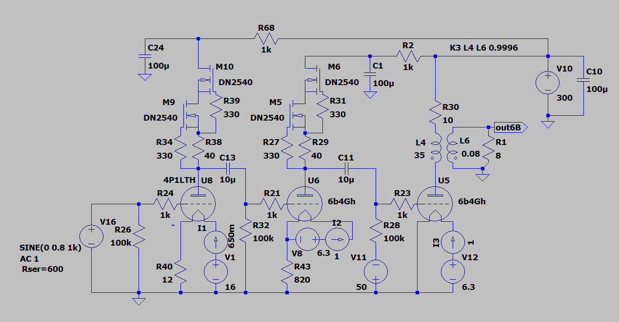

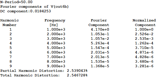

Jumping into this old thread, that is about what I want to achieve. As it is a low budget build, no chokes or IT´s are possible.
Having read a lot about 4P1L having a nice price, it will surely work for the front end. As I have a good stock of 6B4G, I can use it both as driver and output. Have to decide on the heater regulators though. The simmed .four indicates acceptable figures at 1W. This is the sketch:
