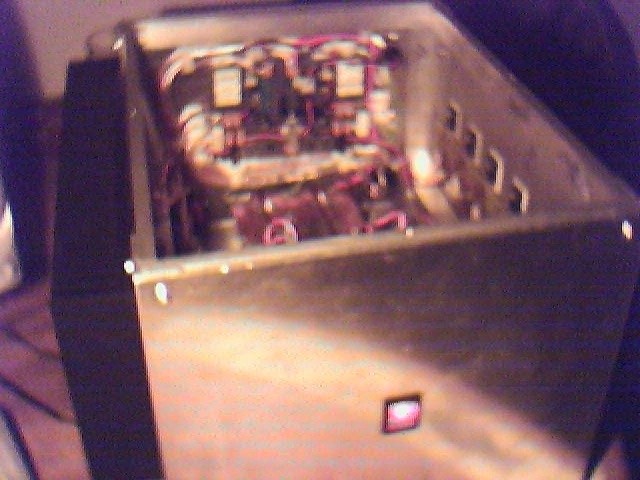

Despite my silly fictional antics, things do get done around here:

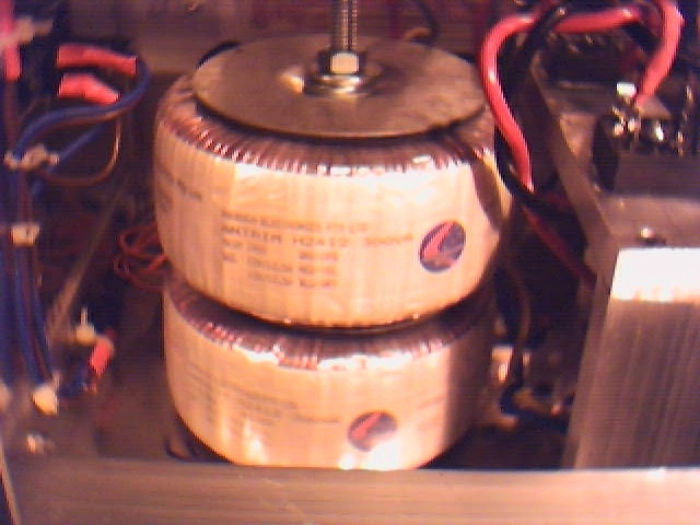

Here is the the power supply taking shape.
After considering various options I decided to stack the 2 300 va Toroidals so as to minimise disruption to the existing chassis.
macka

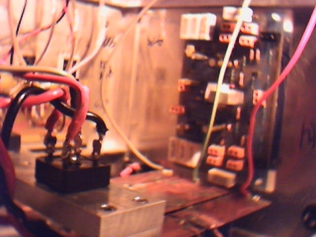

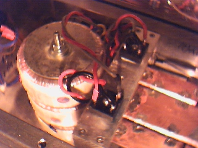

A more detailed view showing the 2 bridge recifiers on the aluminium bridge of the filter capacitors.
This eased the layout of the original amp and makes for a handy heatsink.
I understand dual bridge rectifiers does a better job, but I used 2 for sharing the work load as twice the current flows with the X Aleph, and it would eleviate any mis match between the transformers.
This was actually quite a difficult job, tryng to loom those 14 gauge secondaries and getting a nice clean shiny solder joint with a big %$#@ hot Iron is not easy.
macka 😎

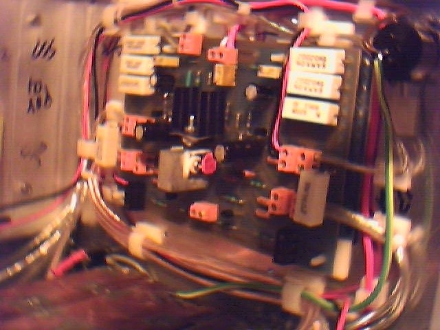

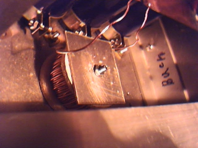

Here is another view, this time of the chokes.
I sandwiched the chokes between to circles of heavy duty felt and a clamped them with an aliuminium bracket to the floor of the box.
macka

The main wiring from the boards will be next....another night.
I am still not sure about the orientation of the driver board yet.
I used stick on board stand offs get an idea of the cable looming.
The problem is its a bit cramped this way, but it avoids wires crossing the board too often. I'm not sure if this really matters much but its nice to make it neat job if you can.
If I was building it from the ground up I would have the complimentry output fets on either side, but this is of course not the case with the normal Aleph where you match the CCS and active side seperately.
macka🙂

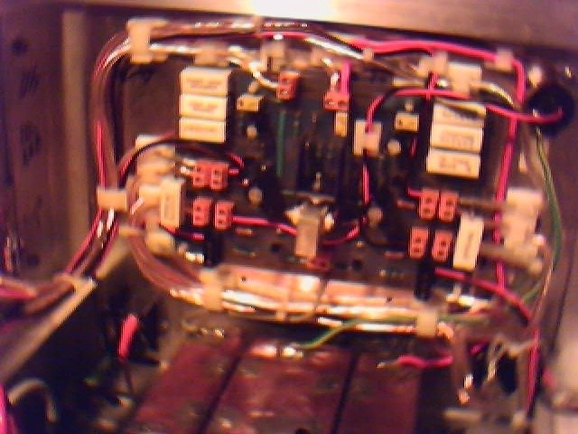

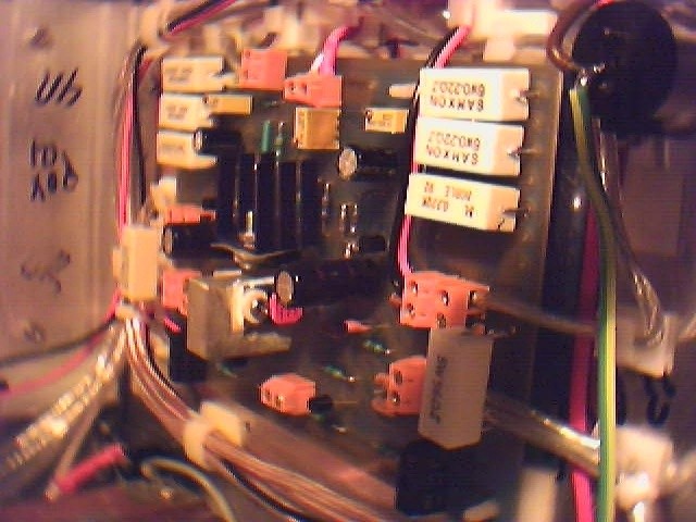

I have started the wiring up.
I had to decide on whether to keep the 2 way screw termnals on the board and provide strain relief with clamps or remove them and solder directly to the board.
Well, for at least the time being I will continue with the terminals.
As you can see (I hope) with so many wires and the weight of the wiring on the 2 way screw terminals I made liberal use of adhesive cable clamps to the rear panel.
Don't worry it looks better in the flesh (some real pics in a few days)
macka😎

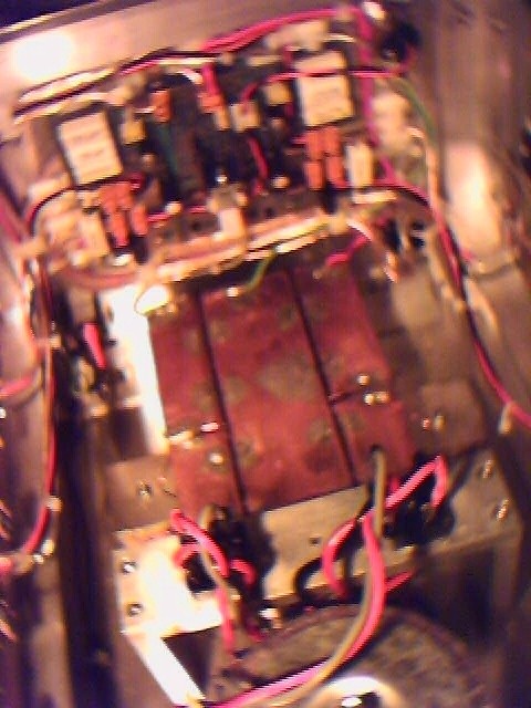

One more go.
The thick gold snake along the bottom of the board is a double cable run to the Speakon output connector. There was provision for two wires from each 2 way terminal block so what the hell.
I figure it was the only area where there was is " high transient signal current" to the outside world and the way this thing delivers it might help.
No whimpy 2 watt full range drivers on the end of this Baby though, she would blast them into orbit.
macka😎

So those toriodal chokes really do work:bigeyes:
Since its been going..about an hour now, I've come to appreciate the additional losses in terms of heat with the X Aleph, that is the higher current draw does cause voltage losses which must be accounted for in your box design for heat losses (ie AX 200 specs)
The bridge rectifiers which are mounted on a solid length of aluminum bar are quite hot, the chokes are hot and the dual transformers (300+300VA) are now quite warm....thats with the lid off..... :hot: :bawling: :bawling: :bawling: .
One may have to investigate some additional ventilation the box!:idea:
