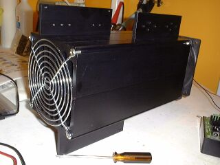

Cool, I actually was thinking in terms of 140 to 160 TOP per channel. should be easily achievable with 2kVA transformers and 24 FET's. I have some very nice heatsinks in mind that are designed as a male and female peice to make a box assembly. You mount a fan on one end and yo have mega heat dissapation, not to mention a very expensive foot warmer.
Here is a photo, I have sinced machined the tabs off and mounted a pair of PZ4's to this one. I have 5 more assemblies left. I was thinking 4 assemblies might be enough for a pair of Aelph X's.

Coulomb,
you are going to need a 2KVA humidifier to go along with the amp.😉
I am envisioning sore throats, veneer peeling off the MDF and woofer suspension cracking. That was among the reasons why I set my max dissipation so low.

Here is the chassis I am working on for my High Power Aelph X, I have two of them. I hope to have the metalwork finished in January.
Anthony
Anthony

roddyama said:Oh yeah,Now I remember those cases from the first time you linked to them a while back. They should do the job quite well.
Yeah they were going to be for an Aelph 1.2 but the Aelph-X seems more worthy. I have had some troubles with a place to host my pics so my links keep changing, Most annoying.
The cases are not finished, I have to do something with the corners. There will be a Hardwood trim on the bottom on the front and sides with the I/O on the lower back.
Right now I have Dales boards set up to give me two FETs per heatsink - 16 in total. With the spreadsheet I grabbed from this forum it looks like I want 8 Amps at 27 VDC rails.
