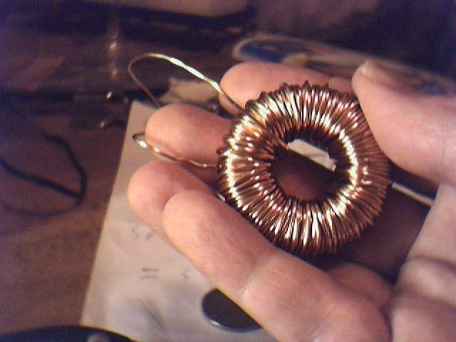

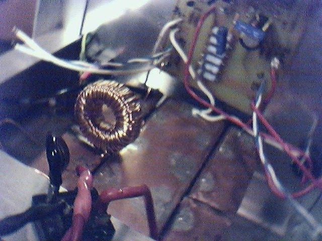

Today I wound some chokes so I though it may interest some of you.
I was not happy with the idea of the bar chokes with bigg losses.
Exploring a few options, the issues were losses (heat), ripple reduction and holding the supply rails.
Finally I decided to take a punt a wind some high current chokes using Iron powdered toriodal cores. The ones I used are 39mm in diameter and use a material called Hy-2, they are yellow in appearance and coated with an epoxy finish.
They took about 3/4 hour each to wind, my fingers are sore but the results appear worthwhile.
Heres the tech stuff:
http://www.allegromicro.com/techpub2/arnold/bcore.pdf

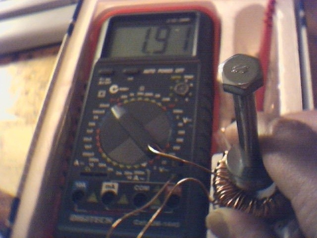

My very limited understanding is that while there are many variety of these cores, the idea is that the iron power mix creates a sort of continous air gap, improving performance in a number of areas.
With three layers of 1.00 mm copper wire I got 1.9 Mh for a dcr 85 milliohms , the voltage drop is about 1.17 volts. According to the simulator the ripple is about 62 millivolts...not bad.
I have put a small speaker on the amp and there is only the faintest hum (no inputs), the proximity of the tranformer and high current wiring on the test bench appears to shround the hum the filters rails.
Similar chokes in Farrnels catalogue rated from 5 - 10 amps but not this combination of L and DCR.
Oh, I nearly forgot to mention, the rails are now 25.76 volts, about double the Baby X.
macka

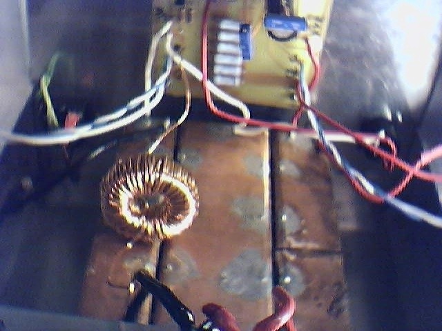

Here are the chokes I refered to in the earlier posts.
I next problem will be mounting them, I may use a fibre glass support, not sure yet. (You would not pick the toriod from the ones out of the factory.......Muhahahahahah)

Good idea,
I suppose you wanna prize Ha!!
I was more concerned about a shorted turn mounting b/n two metal surfaces and metal (steel in the centre), however this may not be the case, only when you short the top of the bolt the other end?
macka
Where do I mail the prize...email me you details ( a free sample........this will jump start the thread)
macka😎
Ps a Bird in the hand is worth two in the bush.
Okay,
The picture tells the story.....this is what I like about diy ..and the forum...we can tend to mix up the theory sometimes...but we bounce off each other and work out the solution.
Thanks Taco
macka😉
Ps That 5 1/2 inch bolt is just for illustration, not the one I will be using Okay Guys...its for holding down two meaty power toroidals

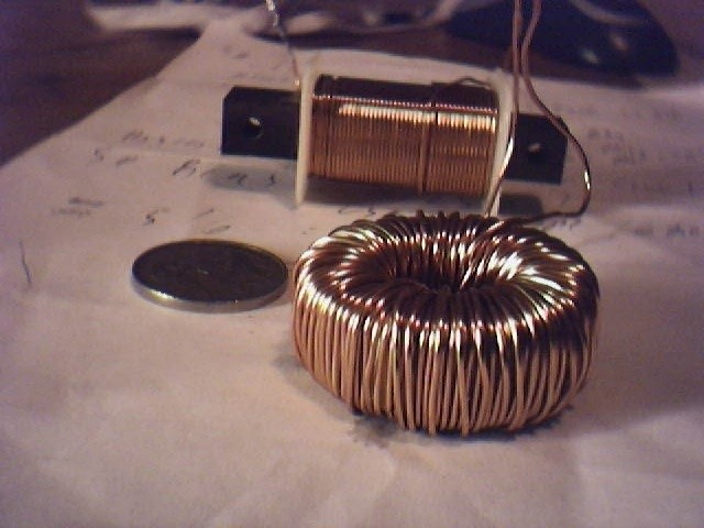

Sorry Grataku,
My lighting and over exposure does not portray this well.
The picture is post 222 is clear.
The reel states it is in fact 1.00 mm enamel copper wire for winding chokes, crossover coils etc.
I have never heard of laquor coated copper and I have searched the calatoge , they do not sell it?
macka

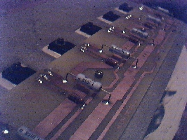

One of my 1st considerations was to determine if the exisiting matched fet sets for the Aleph 2 (2) x (6) , tested at 0.5 amp each, would still be a match for 1.00 amps for my design.
So with my trusty 22 volt lab supply (actually an unused 15 watt JLH supply regulator...(Mr Pass will growl at Me)) I carefully tested all the fets. To do this I made a jig so that I would not have to remove each fet from the exiting heat sink.
This entailed lifting one end of each of the 1.00 ohm source resisters from the board and carefully shorting the gate to drain of each fet with a bunch of crock clips. With a big precision 18 ohms resister in series with the drains all I had to do was touch the negative side of the test supply to the source on each of the fets (IRF 244's) individually.
Well, much to my relief the match was surpirisingly good, within 0.03 VGS, so a guess transconductance of this lot was quite similar!!. Typically I got a VGS of 4.85.
All that remains with this phsse of the project is to mount the additional parelleled source resisters to get 0.50 ohms, cut the tracks on the middle of the board for the gate , sense, source and drain to create 4 sets of 3 fets and Bob's your uncle (sorry Karen...not your uncle Bob)
( I have already done this for one channel)

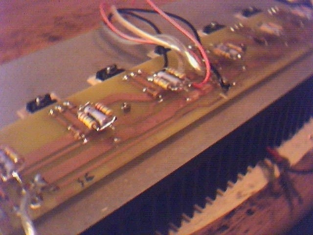

Here is the modified power board for the X Aleph.
Note the 1 watt power film resisters (2.2 ohms), they were the only value readily available to reduce the value of the source resisters to 0.5 ohms.
I have also carefully cut the tracks using a small grinder wheel on my PCB drill.
I have also dressed the boards with new leads, colour coded to avoid potential mistakes.
macka😉

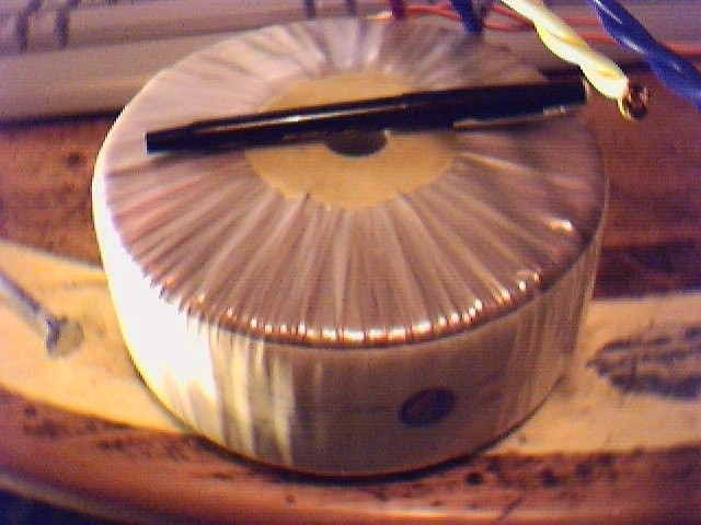

Here's the old Antrim transformer from the Aleph 2, 1000 Va 35+35 Antrim.
You need a huge Iron to solder those wires (double secondaries)
I am not sure what to do with it, door stopper?,boat anchor? tranni for a potential X Pass amp?, or I may post it the the trading post, dont know yet.
macka:bigeyes:
Her indoors would kill me if she saw that sucker on the dining room table...:dead: Muhahahah
