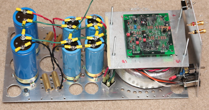

Between work, work, and work, I've had some time to get two 100w Aleph-X amps up and running and finish construction on a pair of dipole speakers and have a listen! What glorious sound - my conventional "box" speakers just don't seem to sound right anymore 😀
Anyhow, the amps ran great and sounded great (especially with the new speakers - bottom drivers are twin 12" and the mids are twin 8" so they play very cleanly to very high levels). At the end of my listening session, I let the speakers run with some white noise for about 24 hours. The next day, both of my amps failed within a few minutes of turning them on. The loud groan from the transformers led me to investigate the power supply configuration and I discovered that the bridge rectifiers (sourced as surplus, rated to 600v and 35a) in both amps had failed and were shorting the transformer which caused the fuse to blow. Apparently, over the course of 24 hours, the heat and current was too much for them.
The 1500va transformer has dual secondaries, each rated at 20v. One secondary powers the positive rail, the other powers the negative rail, so each bridge is running at 21v and 9a. The other bridge is mounted in a symmetric manner to the first one that is visible in the picture below. I thought having them mounted to the bottom of the chassis was enough, but when I removed them, I noticed I didn't have a silpad under them like I thought I did. So I've replaced them with another 600v 35a that can handle 35a at 50c and even at 75c can still pass 25a. This time, I'll remember the sil-pad for heat transfer...
A silpad will isolate your bridge case from ground...your fuses will not blow and protect your amp next time this happens. Just use thinly spread goop for thermal transfer...

Hmmm - I thought perhaps the diodes blew and ended up shorting the secondary leads from the transformer with ONE ANOTHER. I didn't consider that the diodes were shorting to GROUND through the case... Looks like I should do some measuring of the dead rectifiers!

YIKES! I'm beginning to realize this... I suppose driving AC into the caps and eventually the FETs would not be pretty. The only part of the amp that is fuse is "hot" side of the transformer primary. Does anyone use fuses anywhere else?

That could be too...but it is still wise to have the bridge case grounded.
