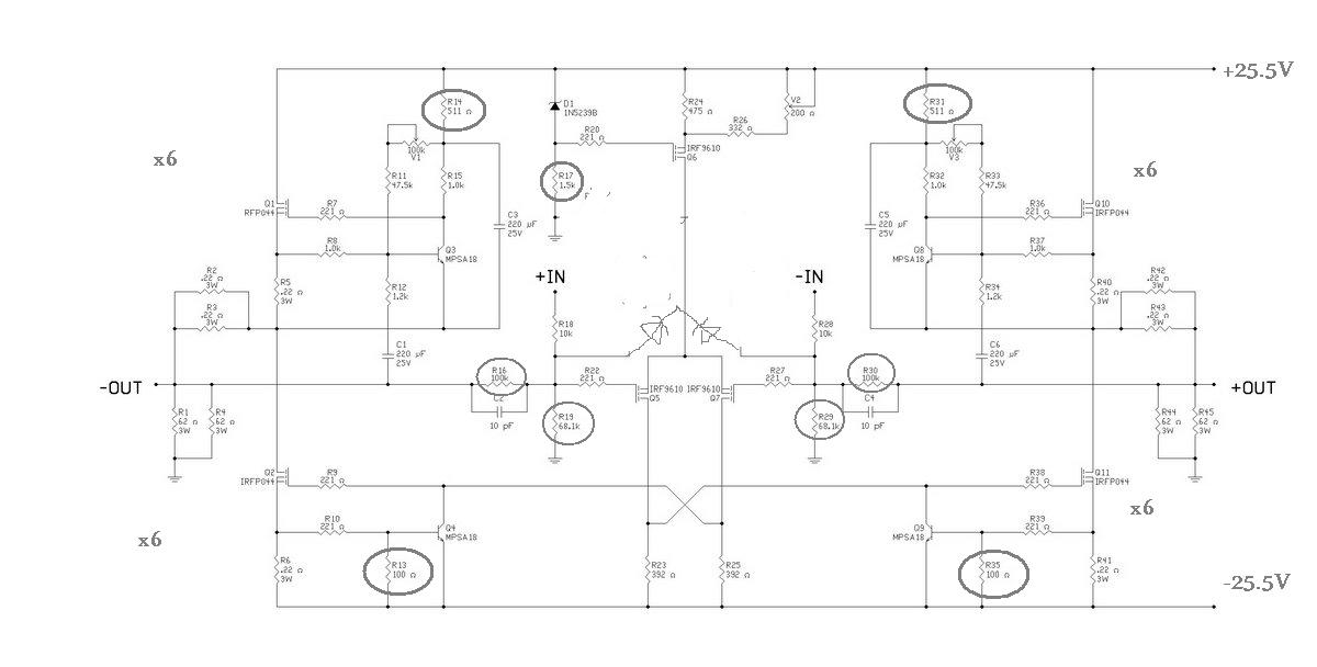

Hi there, anyone could drop quick look to my changed aleph-x ?
I mainly want to copy aleph 2 performance
its 25.5-26V rails 12Amps
24x irfp 240 per channel, source resistors 0.5ohm (1A per fet) it will also have spare option(may use later) with wired but not conected extra 8 mosfets (total in this case 32fets /16Amps) and changed toroid taps down to 20v.
I did some changes and would like to see if amp will operate well enought
changes-
1)output current limit resistors changed from 100 to 170ohms (r13/r35) which value in range 120-170 I should choose to operate circuit safely in accident shorted outputs
r17 changed to 10kohm ( according to original aleph2)
r15/r32 1.5k
r14/r31 3kohm
local fedback resitors for input fets 20kohm
output to ground 100ohms
r16/r30 200kohm (for bigger input sensitivity)
I want also to remoove 2 of input protection diodes , like in Graeme ax100, but on his schematic i see that he is also added 4,7uf input(which I do not use) caps together with 100kohm ressitor
(just before any part- from input to gnd) what this resitor does? and can I remoove r21 (3ohms) and reposition input protection with 2 zenner diodes?
thanks in advance for any input

Sorry, Elviukai - I'm still getting my head around the "original" version of this amp, so my skill level is not great enough to comment on variants of the design...

yes very complete article , thanks Eric, However I belive there some mismach in article about adjusting curent gain ,
change is made by ressitors r12 and r34. but I belive(from previuos Nelson post and seeing aleph schematic) its opozite- LOWERING values of r12/34 will INCREASE current provided by CCS , not increasing values. or I didnt understand description correct.

elviukai: Yes, something is off here... William indicated the same thing to me in an email some time ago, but I haven't been able to find where my calculations are incorrect. Following the calculations that I posted (that I think came from Edwin Dorre in one of the big threads) I reached the conclusion that lowering values decreased current gain. But then again, I wrote this section up before I was able to measure things with a scope.
Something remains incorrect in the formulas I have posted. If you (or anyone else) can help me identify the inaccuracy, I would like very much to correct it.
Thanks!
