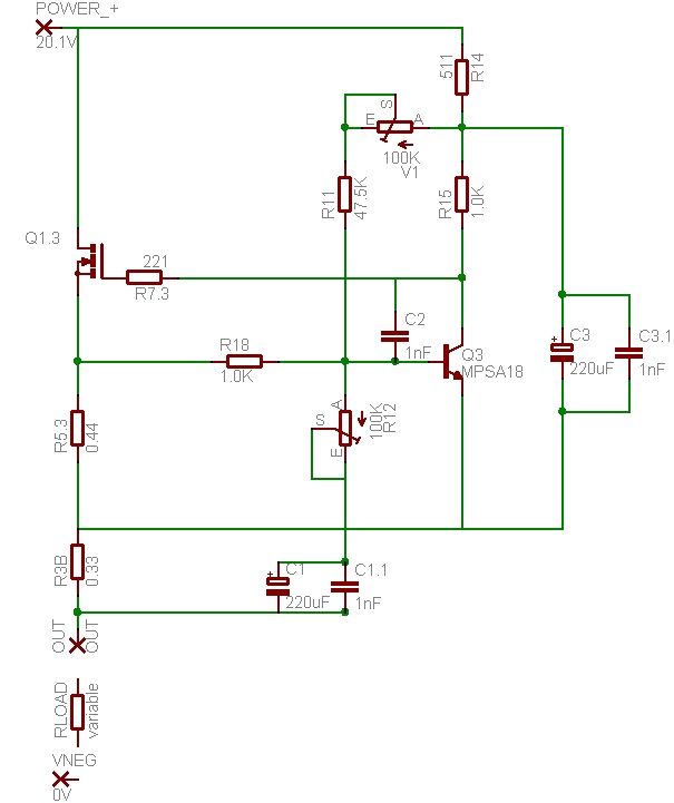

CCS working?
Hi Guys,
I am building an Aleph X. In the last steps of the process, progress grinded to a halt. I blew a range of precious matched mosfets, trying to figure out what was wrong.
Now, two months later, I traced one of the problems back to some broken capacitors (C3). My circuits started to oscillate as soon as the circuit started changing from voltage regulating (larger load) to current regulating (smaller load).
I thought I understood how everything worked (newbie attitude….) and started checking all separate parts of the circuit one by one. One part is still giving me trouble, the same CCS. I made my own PCB’s, so I am not 100% sure whether or not I have a problem.
What I wanted to do is test whether or not the CCS is working as it should be. I am testing a part of the circuit, just the CCS. The complete setup is in the sketch. During the test, only Rload is being changed. The power supply is CLCRC, so it will drop when more amps are used. That is why I included the Vtotal.
Measurements:
R8_________Vtotal______Vload______Rload_____=> Iload
0,321V_____20,05V_____2,835V_____2,977_____0,925A
0,307V_____20,09V_____1,791V_____2,078_____0,862A
0,288V_____20,15V_____0,875V_____1,162_____0,753A
(measurements after warming up. Retries a day later gave the same measurements.)
Conclusions: when I change the resistor load 256%, the current will change 23%.
1st question Is this a normal deviation?
Another problem. When I double Vtotal, the circuit shuts down. To get it conducting again, I have to change VR1/R11. I have the feeling that I will have the same problem when the Aleph X will have a full voltage swing.
2nd question Is this correct?
Thanks for all feedback!
