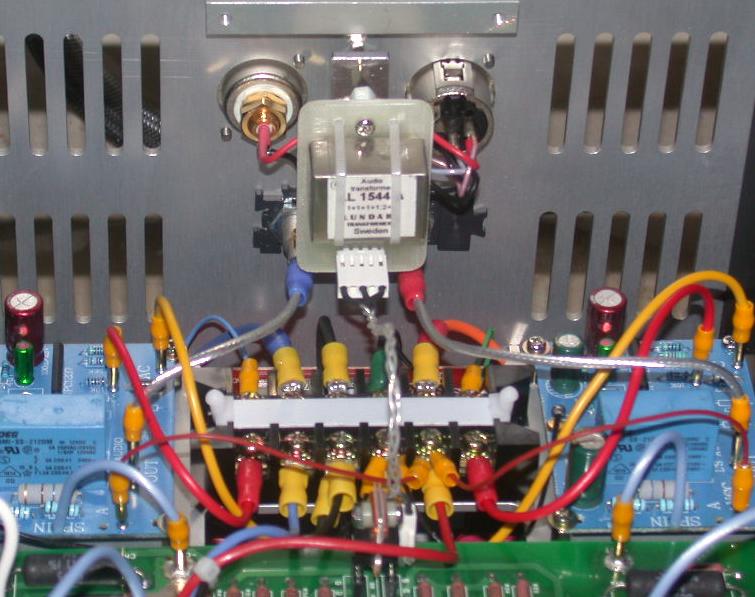

Relative DC offset change...
Relative DC offset changed to 100mV from no transformer at input 50mV.
Why this happen?
I want more gain...so I changed input resister 10K to 100 ohms.
The result was increased relative DC offset to 1V.
I dont knnow why.
