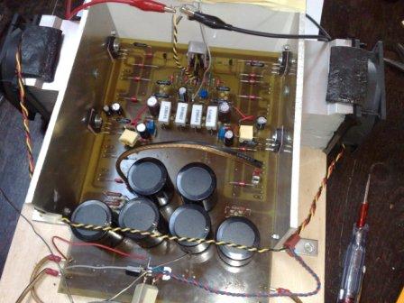

AX debugging
I have my Aleph-X v1.0 board with J505/9610 CCS (powered from a 3 amp +/-15v bench supply).
At this stage i want to verify that the board is populated correctly and that it's ok to install the power FET's.
For R48 ihave used a wire link and i'm reading 18.8 volts from that link to the negative rail - There is nothing across R23 and R25 has 8.6 volts across it.
R16 has 2.93 volts across it & R30 has 0.03 volts
Q5 has 3v on the gate, Q7 has 0v.
Could anybody point me in the right direction for where i'm going wrong please?

Progress
Ok - i found the fault - Q7 was dud.
Afterward replacing Q5/Q7 with a new matched pair i got 4.3v over R23 & R25 and decided to go ahead and connect up the main FET's.
So far so good in that i haven't killed anything yet, but i'm having some trouble adjusting the amplifier.
I'm using a variable PSU capable of 3 amps, but adjusting the bias with V2 is reducing the absolute DC offset but increasing the current draw until the PSU starts current limiting at about 2.8A.
R11 & R33 are changed out for 4k7 instead of 47k5
I'm struggling to get more than about 0.3 over drain resistors R5, 6, 40 & 41.
I'm also not totally convinced about the CCS created by Q6 - i'm only seeing 8.8 volts across a 9.1v Zener, have tried replacing the zener but no difference.
The inputs are floating, the outputs are loaded with a 7R resistor.
Any help would be greatly appreciated.

Current limiting is preventing it coming up correctly
The power supply going into constant current t=rather than constant voltage mode is causing the problem - if i wind Vr1 back far enough to shutoff one of the CS FETs completely then i can get 0.5v on the 0R22 drain resistors on the other other side of the circuit easily - i'll be building another power supply tonight.
