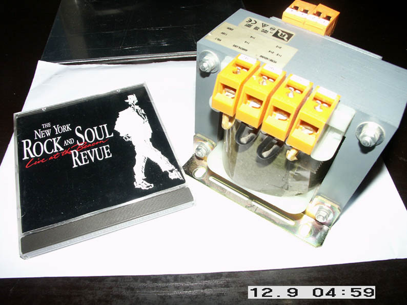

I have a small question.. do you guys know anyone who built Aleph X with a E-I core tranny? how did it sound?
i asked because im really interested in this amp and i think i can manage, but times are bad lately in this part of our little planet. hehe just the monetary conversion alone to get torroids is killing me.
Any replys is highly appreciated and would help a lot in my rough planning.thanks and sorry if i disturb the flow of the discussion.

I don't think there should be big sonic differences between a toroid and an E-I transformer.
If you can deal with the larger size and weight for a given power rating (probably meaning a bigger/stronger chassis) and you take care of the bigger stray EM-field of an E/I core type transformer, there shouldn't be a problem; I even read somewhere on the forum that due to the smaller "bandwidth" of an E/I type transformer you would have less trouble with powerline noise/-interference if present.
I myself am building a kind of stereo 50~100W "prototype'' AlephX with two 12/18/24V-320VA E/I type transformers and from parts I already had laying around or could get dirt cheap to get some experience with the AlephX .
It will be some time though, before I can give you some sound quality impressions, things go slow with this project....... 😉
