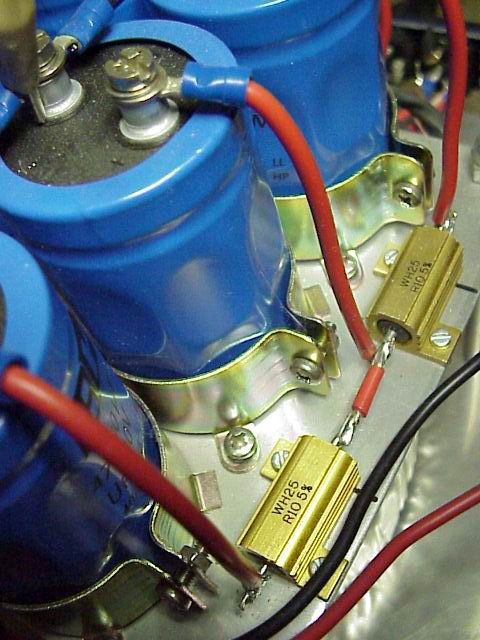

After using my Aleph-X for almost 1 year, one channel has some 50Hz hum after warming up. The dc off-set looks oke, it's in the same leage as when I built these amps. The problem also occurs without a preamp connected. Everything is fine, when the amp is cold, in the first 10 minutes or so. Then slowly the amounth of hum increases.

If the caps are new and BC computer grade, you took among the best there are IMO.
Of course one of them could have problems, one never knows.
For some reason I don't like the resistors you use between the caps. The wires look too fragile to conduct that amount of power cleanly.
The cheapest way to test if they are the culprit, is to bypass them with solid wire, firmly attached.
You will have more ripple (and a slightly higher supply voltage) when cold but it should stay the same when the amp warms up.
I included a picture to show you how I did it. Big, solid resistors, mounted on the alu base where the caps rest, strong solderings and tick wire.
Let us know what you found.
/Hugo 🙂

Those BC caps aren't new, yes the are unused when I bought them, but the production date is mid nineties I think. I'm sceptic in bypassing the resistors, I am not sure my heatsinks can take the extra heat (they most likely will). Also, everything worked fine with those resistors and still do in the other channel 🙂. How can these resistor create a ripple on the voltage rails?
Resistor with thin wires
Well I thought you actually want some resistance at that location in the CRCRC, so I can't see any problems with thin wires at the R, scientifically speaking.
Furthermore, both your resistors and those from Taco are wire-wound resistors (yes, even those in nice aluminium housings) -- guess how thin and long those wires are within the resistors themselves (Break one up to find out for yourself, the ceramic ones cost less than 10 cent each). And that also means that they have inductance -- which is also not unwelcome in a CR(L)CR(L)C.
If you really want them 'clean', try some Vishay RCH50 resistors (available from RS at around 4 Euros, still affordable for 50W). They have less than 50nH inductance. Then you can claim pure CRCRC. I wonder if you would hear any difference.
Patrick
