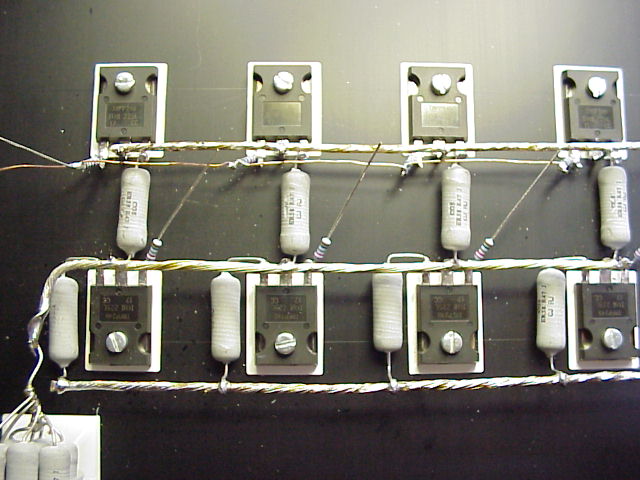

That last picture doesn't look very stock Aleph-X.
Why are you mounting transistors on auxillary boards when you
are only using 2 FETS per sid? Build it all on the board supplied,
it's a really nice PCB!
The gainclone isn't stock either... (way too much PSU capacitence)
Simplify... then you may be able to troubleshoot easier.
You ARE doing something wrong, becasue i have built the stock
Aleph-X and it DOES work.
good luck!

Hi moe29...
For aleph-X I'am using 4 mosfets per side , 8 per channel...so no place on PCB...( on picture is one channel )
GC, well I was just put it together to play some music...I did not bother to make it like stock GC...then I would have to make a really nice chassis for it...this is just to have something to play with...As Netlist say,to cool me down ( didn't find wine in frigerator ), and give AX another try...
