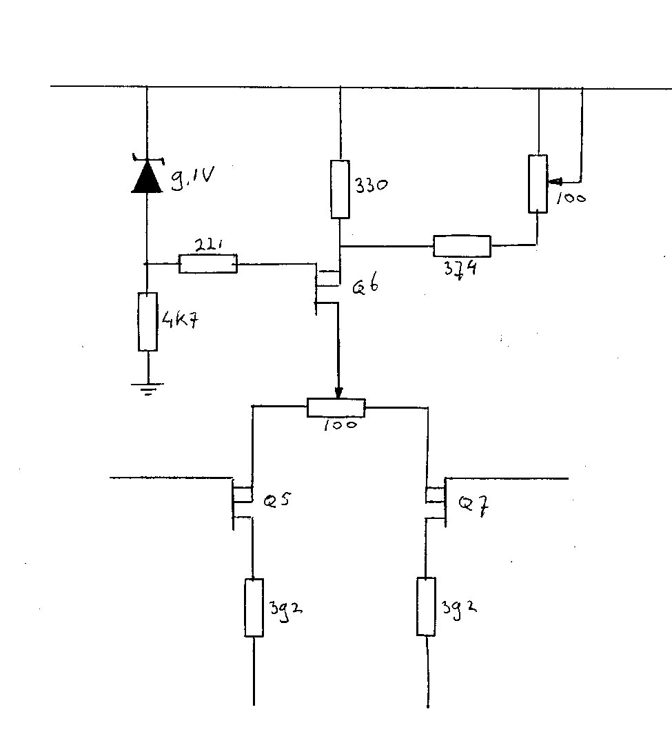

Differential pair
I am planning to match devices and couple them thermically but any remaining offset could be removed this way isn't it?
