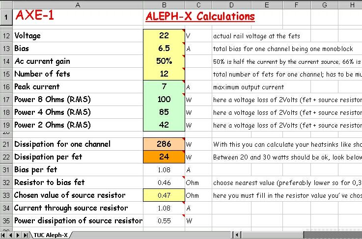

Source resistor rating
I searched, but did not find - maybe bad searcher :(
What is the minimum wattage for source resistors on AX-100?
According to William's spreadsheet, it is not even 1W.
Now why are 3W and even 6W suggested here?
Can I use 3W anyway, cannot get good higher wattage locally?
Another guestion re. cap quality, if I must choose a good place for a HQ cap, must I rather use HQ for C3, C5 or for C1, C6 (on Grey's circuit). I got 4 x Elna Cerafines which I want to use somewhere and 4 Panasonic FC caps. Which will be best suited where (all 220uF, 35V) - stereo amp.
My planned specs:
Moderator
Joined 2003
Re: Source resistor rating
3W will do fine, 1W would probably work but will run much hotter all the time. (SOA)
I don't think the mentioned caps are that important unlike C2 and C4.
Any good quality device will do. I would go for 105°C rated ones.
Like everything there could be an audible difference. Try and let us know. ;)
/Hugo
