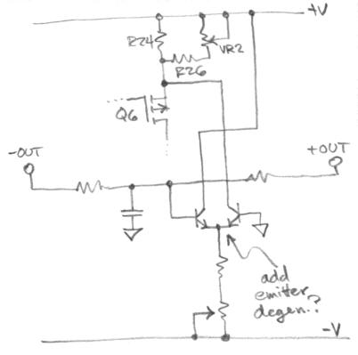

Wow, I haven't experienced anywhere near that much thermal variation. At most, I'm seeing +1.4V to 0V from cold to fully warmed up. Do you have the MacMillan resistors installed (R46/R47 on my schematic)? With my prototype channel, nulling the absolute DC did nothing for the differential offset (actually made it a hair worse, as I recall).
I have an idea for a simple two-transistor servo which could be connected to the existing Aleph-X circuit to null it's absolute DC offset (see attached image). Basically, this circuit just adds and subtracts current directly from the main CCS, thus affecting the absolute DC offset. A pair of equal resistors forms a voltage divider between the outputs, thus removing the differential-mode signal, and a cap forms a low-pass to help further attenuate stray signal voltages at the servo diff pair input. R1/4/44/45 must remain to keep the open-loop absolute DC gain low, though the MacMillan resistors would be rendered redundant and could be removed entirely. I provided a trimpot to control the overall current through the servo diff pair. This can be trimmed so that when operating at normal temperature, the servo diff pair sees roughly equal currents on each side, or as needed to prevent servo saturation when the amp is cold and coming up to temperature. With the servo installed, VR2 becomes useless for adjusting DC offset, but can instead can be used for additional control over current balance in the servo circuit.
BJTs should be low noise types, and I haven't done any calculations, since it's still just an idea I scribbled down on a post-it. In practice, some emitter degeneration resistors may be needed for the servo diff pair. In fact, the servo should have a low-noise CCS of it's own for best results, but you get the idea here.

In theory, if you used deionized water, you could completely submerge the DUT, since pure water is supposed to be non-conductive. I've never tried it myself, but with a constant-current source feeding the DUT like in jwb's pic, the worst that could happen is the water would short out the device, and you'd get a voltage reading of 0V Vgs... no harm done. For the diff pair, I would not heat the water to boiling temp, though I understand your motivation to do so, since it provides reliable temp regulation of the water, and gets the silicon close to it's actual oprating temp. In practise, the diff pair will be quite a bit cooler. Perhaps an aquarium heater would be the way to go?
I would make one small addition to jwb's circuit: a momentary-off switch to short out the LEDs. This way, the current source only turns on when you press the button, allowing you to do very quick momentary tests while the silicon remains normalized to the water bath temp. Rail-to-rail opamp would be needed, or maybe a discrete circuit.
Hi Chad,
I guess an op-amp, as jwb suggested, would also work here.Would the ZTX450 work here as well?It should be ok no?

Hi Protos,
Yes, an opamp would also work, though my preference would be to stick with a discrete solution, as it gives more control over the open-loop parameters, and is just simpler overall. Just about any BJT with sufficient voltage rating and power dissipation will work there, ZTX450 included. There are other ways to do the discrete servo too. One could concievably remove R17 and replace D1 with a resistor, then reroute the servo diff pair to feed current to it, thus affecting the other side of Q6.
I calculate your zener is running at 14mA, if your rails are +/-15V... that's about 1/8W dissipation which is a tad high, but shouldn't present major problems. It would be worth bringing this down a bit as Scott suggested... a 4K resistor would be about right.
I wonder, are you using Q6a or Q6b? If you're using Q6b, it should be fitted with a small heatsink, as the little TO-92 gets much warmer than a big TO-220 will. Thermal variations in the CCS will mostly come from Vgs drift in Q6, so the greater it's temp variation, the greater the variance. Measure the voltage across R24 when the amp is cold, and again when the amp is hot, then you'll be able to see exactly how much the current is changing with temperature.
