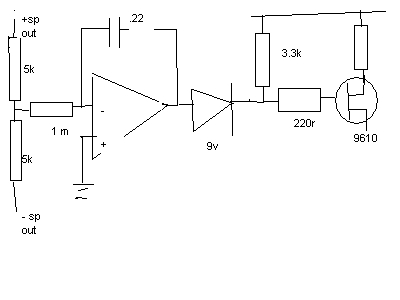

today i fail to apply dc servo (inverted mode)
i replaced d1 with 3.3k resister, remove r17
feed op of servo to gain of 9610 via a 9v zenar
dc offset get improves within 20mv but not steady
ac o/p 7 volt clearly wrong
may somebody help
thanks

Re: dc servo for aleph x
/Hugo
Yes, but please give us a schematic or a link to it. 😉arthur said:
may somebody help
/Hugo
Trying to run the Zener via an opamp?
Hmmm.
Why?
A servo for this circuit need not be complicated. I whipped one up using (as I recall) two MPSA18s instead of an opamp. I never bothered posting it in the Aleph-X thread as no one seemed very interested. I believe someone else did post one, though. It should be fairly early in the thread. If you can't find it, I'll see if I can find a hardcopy of my schematic for the servo. After losing my hard drive this past winter, I'm having trouble finding some things.
Grey
Hmmm.
Why?
Grey

will the 2 trs servo act as an osscillator ?
any more informations for dc servo aleph x i/p current source
I can not tolerate cold to hot dc variations (4v to 0 volt)
Arthur

The servo will only serve to correct the DC offset between output and ground. This is not at all important because it is the same on both sides of the speaker (just like in the SOZ) and doesn't really have any effect on things unless it's really extreme. The worst you'll face is that one rail will clip before the other.
If you're talking about DC offset from one speaker terminal to the other, then a servo will do nothing to help this problem. There are several possible causes. If you disconnect the inputs and the DC offset is still there, then it's possible that the MOSFETs in the input differential aren't matched closely enough. If all is well until you hook up a source, then you're facing another possibility--leakage of DC from the source (I just had this happen to me--thought it was the amp going nuts, but in reality it was a piece of test equipment belonging to a friend of mine that was passing DC). Small amounts of kind of DC offset can be cured by using the pots I added to the Aleph current sources, but it's best to actually track down the problem and cure it.
Make sure that the amp is adjusted properly, then figure out which kind of DC offset you've got. The next step is to see if it's coming from the source or the amp itself. With a little bit of detective work, you can limit the number of things that might be causing the DC and set out to fix it.
Grey

thr differential dc op offset are only 7 mv and 20mv for 2 channels.
only absolute o/p offset varied from hot to cold (4v to 0v)
i am worry for 0.4v offset at the ip . So i want to install the dc servo.i want direct coupling with my preamp.
As i am not an electronic enginner , i dare not to experiment too
much,
so i ask asistance here
Thanks alot

If your DC offset at the output is below 100mV, you have nothing to worry about. 4V absolute offset when the amp is cold isn't going to hurt anything since the speaker doesn't see it.
DC offset at the input (I'm assuming that's what you mean by "ip") is much more easily dealt with by using DC blocking caps if it's a problem.
