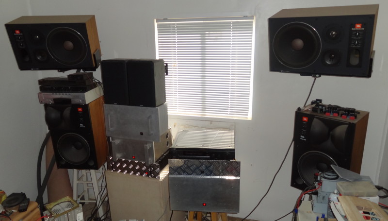

I got a chance to play around with my amps some more today. I think I finally found what everyone was excited about. As I bumped up the volume of each amp the AX started to gain on all the others. The louder I drove it, the better it sounded. A couple of the other amps started clipping or sounded brassy but the Aleph really started to get nice. Pretty surprising that the weakest of the bunch shined the most when played loud. Very nice. These are the amps I was playing with. ES P101, Leach Low TIM, Symasym 5. Krell KSM 50 clone and of course the A-X. What fun!

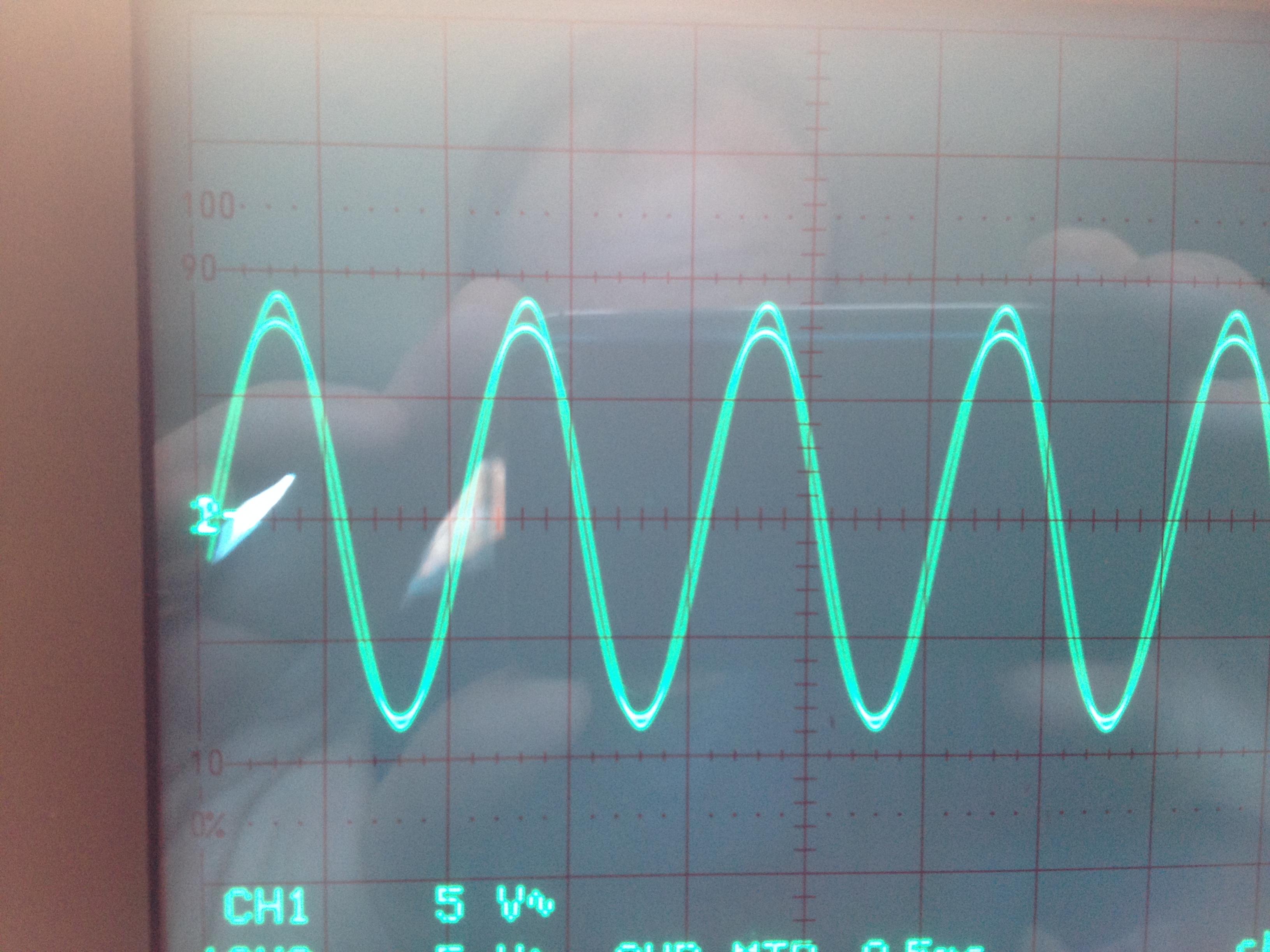

Aleph-X, Asymetric waveforms from output
Input is a 1khz sine wave. I measured the outputs (one side connected to Ch1, the other side connected to Ch2, Ch2 is inverted and superimposed over Ch1) - There is a slight difference in amplitude and waveform shape.
I have 180mv across the output and about 90mv from each output to ground - can't seem to reduce these offsets (I'm guessing at this being due to FET differences at the bias current, mine were matched at a lower current). I can play with these later.
I had amplitude differences previously but searched through the forums and found that driving the amplifier from a single ended input could cause this (increasing the value of the "Macmillan" resistors reduces the effect but with side effects elsewhere (i.e. start-up DC offset)), so I added a DRV134 single ended to balanced convertor and tried to drive the AX inputs directly from that (i.e. without additional coupling capacitors) - I have already checked the amplitude of the DRV134 outputs and they are correct (so inputs to AX are definitely of the same amplitude).
I would greatly appreciate some assistance in trying to resolve this issue.
