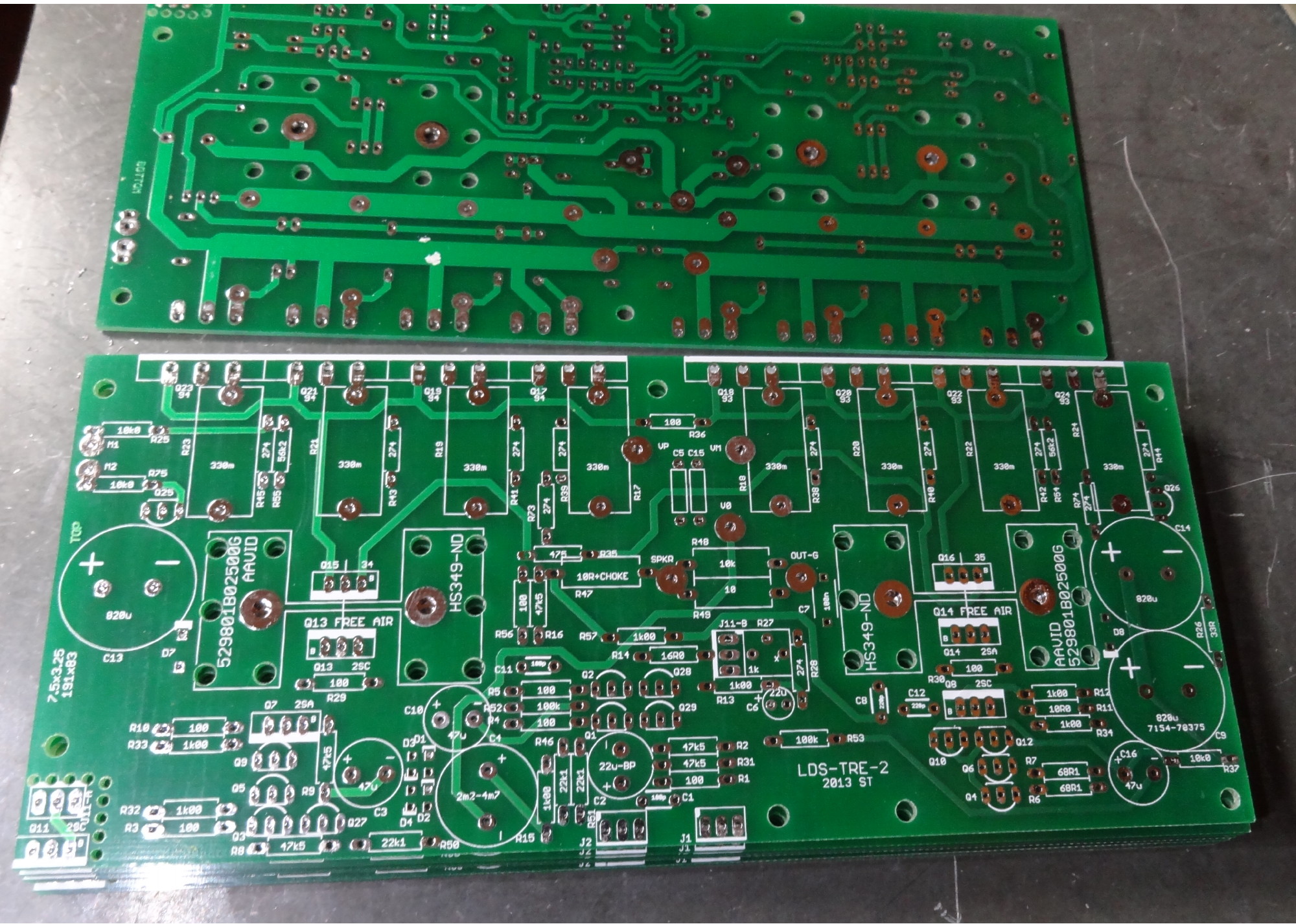

It was this company.
Printed Circuit Board - PCBs in 24 Hours.
It took a month to get them, though to be fair, I chose the cheapest shipping. They produced them within a couple of days. I was surprised how reasonable it was. The boards are very nice. Makes you think about the logic of home etching. Here's a pic of the boards I got.
