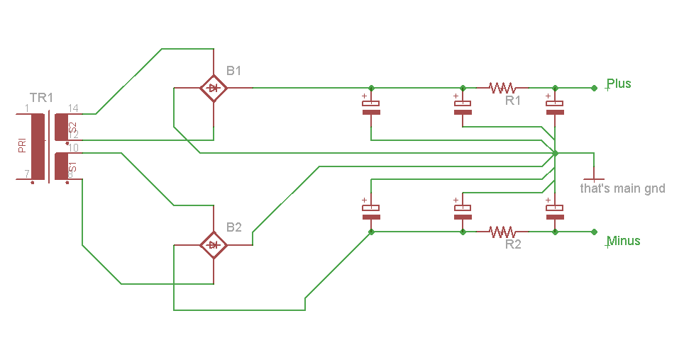

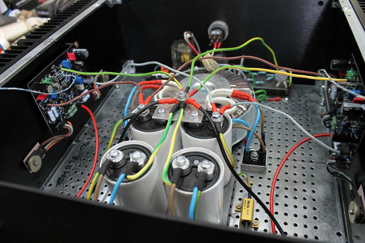

I was just poking around under the hood and found something rather strange. I was measuring voltages at different points in my power supply and found a strange result at the ground terminals.
The power supply is pictured below. The green wire is the ground for the caps and there is an additional wire between the second set of caps (not shown in the picture).
Here is the interesting part: I can measure 7mVDC across the ground terminals on the two caps on the right even though they are directly wired together. In my other two amps, all measurements across the ground terminals show 0mV. I'm thinking it's time to rebuild the power supply in the amp and see how things measure then...

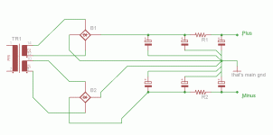

positive and negative wires can be made in series fashion - from Graetz to cap to cap to resitor to cap
ground wires - bridge between two last caps (pos and neg) , ground wire from CT (or two Graetzs , if you're using that arrangement) to mid point of bridge , and separate ground wires from each cap to mid point of bridge
something like this
then that point - middle of the bridge - is your central ground point
