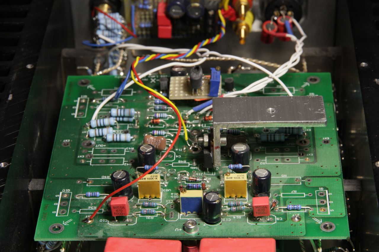

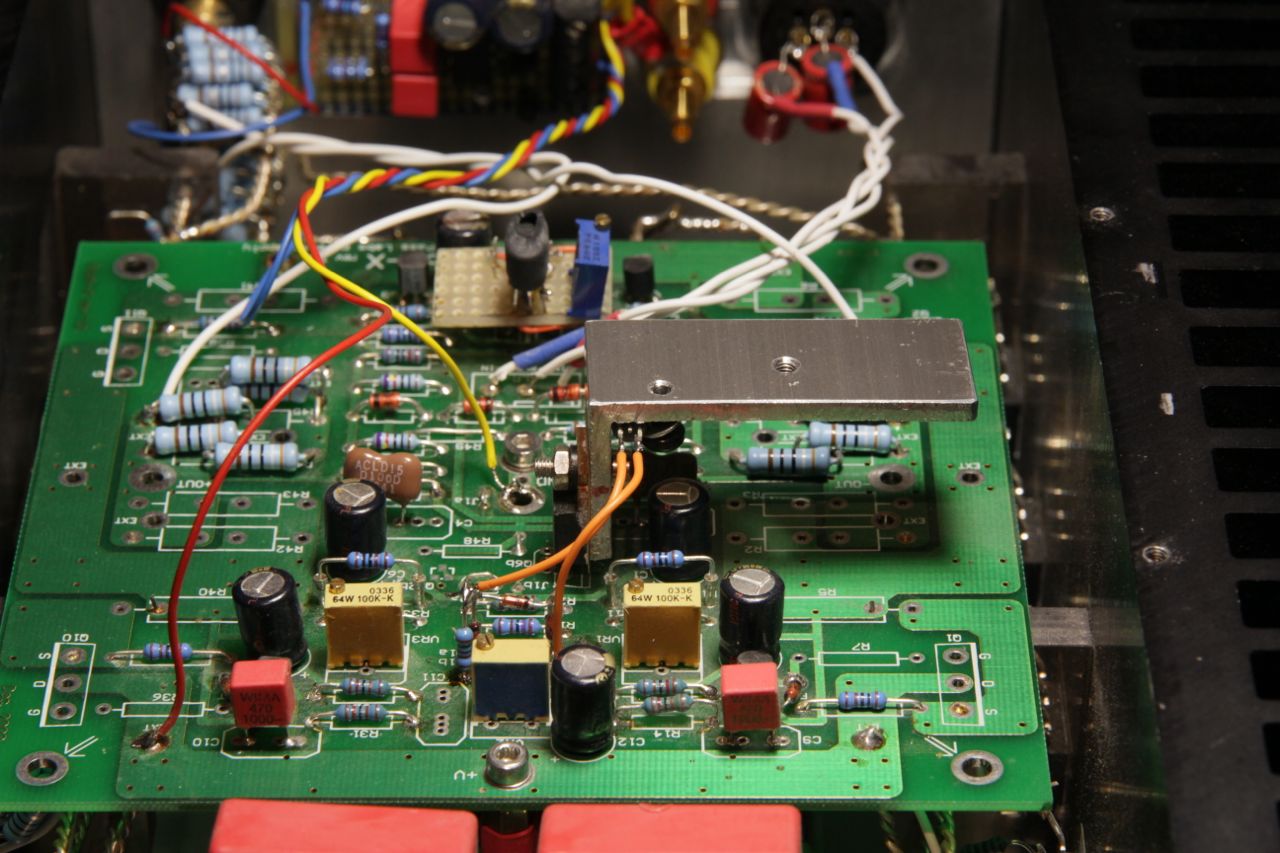

Temperature compensation
today I tried to put some PTC's in the current source for the input diff pair.
I've used KTY81-110 as suggested by Salomon (thanks again!).
Until now the current source was build around Q6a (IRF9610) with 3x2.9V zeners and the following values for the resistors:
R24 2k7
R26 680R
VR2 200R
I've replaced R24 with a KTY81 and a 1k5 or 1k2 resistor, the rest remained unchanged.
The PTC is coupled to the IRF9610 which is coupled to the top of the case.(see pics)
Well, it seems to work fine. The calculated 1k5 seems a bit high (the absolute DC get's more negative during warmup) so I've put 1k2 in the other channel which is better. I'll watch some real cold starts and do some long runs to decide which one is better or if I have to go even lower.
This setup will probably only work for my amp but with a different combination of resistors it should also be possible to make it work for IRF9610 or quod JFet inputs.
William

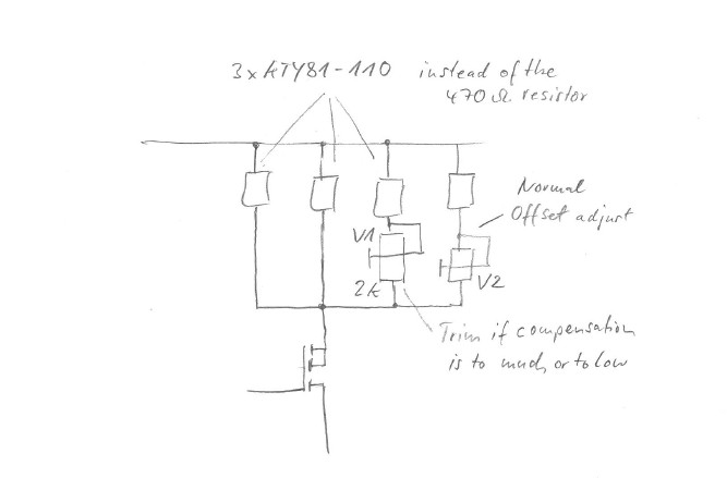

Fixing all Aleph-X Offsets
I am sure with with the right combination of PTC it is possible to completely compensate the temperature drift.
It is my opinion the type of zener diodes does not make such a big difference.
I only can speak for the normal version of the Aleph-X circuit with IRF9610.
For all who use a Aleph-X with JFETs I am sure William will find a good part combination.
I use 2 pieces of the KTY81 PTC. I chose this device because it has a very linear characteristic.
With three pieces and a trimmer in series of the third part it is possible to compensate for the temperature drift completely.
Please see my attachement
The new trimmer is for right adjusting between over compensation and under compensation.
Try a 2K trimmer and begin the adjustment with adjusting the biggest value.
First you have to adjust he normal offset trimmer and to judge the remaining offset drift from cold to warm.
If the PTCs don`t compensate completely the temperature drift, you have to decrease the adjustment of the additional 2k trimmer to a smaller value.
The right adjustment is a combination of the adjustment of both trimmers.
If changing the adjustment of the 2K trimmer it is important immediately to re-adjust the normal offset trimmer to zero offset.
A good thermal coupling of the PTCs to the temperature of the output FETs (heat sink) is very important !
We are speaking here about the offset that we measure from each output pin to ground. This one you can compensate with the PTCs.
The offset measured between both output pins is depending of the matching of the IRF9610, its Drain Resistors and the matching of the parts of the output stages.
If you want to easy get a little remaining offset to zero it is possible to solder a resistor over the Drain resistor (390R) who you can measure the bigger voltage of both IRF9610.
Try to determine the right value with first solder a 10K trimmer over the Drain resistor.
Begin to trim from highest value (10K or more) to a lower value.
If you measure 0mV over both output pins you have found the right value. Solder out the trimmer and measure the value. Now you can change it against a normal resistor and solder it over the normal Drain resistor. This choice is better for long time offset stability.
Now the offset between the output pins allways will be stable at 0mV or less than 10mV . Cold or warm amp will not make any difference.
Sorry for my bad English, but it is important for me to make this information accessible to all persons in the world who love the Aleph-X like I love it.

had the amps on quite long last night and measured around -2V of offset. Measured again this morning (cold) and had around 3V in the left channel and 1.5V on the right channel. So the voltage swing is around 5V left and 3,5V right (remember there are different R24 in both amps)
This means, that I have to raise the influence of the PTC a bit more, lower
R24 and raise R26.
Before the swing was around 8V (R46/47 being 22k). Changing R46/47 to 27k would have changed this to around 10V.
@Eric: I coupled the KTY to the current source fet as I found out this had by far the biggest influence on absolute DC Offset. Cooling and heating the outputs, diff pair and some more had almost no influence.
On the input are a pair of black gate F? (the red ones, bipolar)
@Graeme: Yes I would because it means you can raise the value of McMillan resistors which (I think) has a positive influence on sound quality.
I did install the 3 zeners but somehow that didn´t work as it should have (giving a negative tempco)
William

Out of the results of the two amps I can calculate a third setting to get the drift to (almost zero). Will be something like R24=680R plus KTY and R24 = 820R. Will try this evening.

Hi William,
i am sure both stages have a temp offset drift
It is clear that the drift of the input current source who changes the Drain voltage of the IRF9610 has more effect because this changing of the drain voltage will be multiplied by the gain of the output stage.
It may be a good idea to be heated driver or heated input current source stage taking as reference temperature for the PTC
For me it was mechanically easier to take the temperature output stage as the reference.
I think with both variants you get a good offset compensation.

Hi William,
very interesting!
I am sure you will find the best values for a perfect compensation.
Maybe its better to use only one of piece of the PTCs because you a using a JFET stage if you get over compensation.
Using the normal IRF9610 circuit it is not possible to get over compensation.
If users with IRF9610 want to make a full compensation, the have to take three pieces of the PTCs and solder the second in series with a trimmer. See my other post.
I am also interrested how it sounds with the bigger values of the McMillans.
Thank you for all and good luck.
Horst
