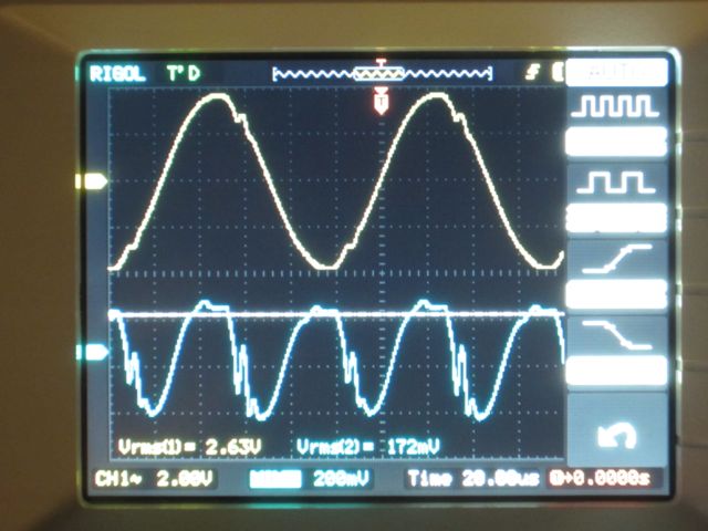

experimented a little more tonight. Put a 100R pot between the two 22k McMillans and connected the wiper to the JFet sources. This way I wanted to null the resulting signal. (I found out my input/feedback resistors are already 0,1% ones)
Set the amp at 4V rms output, signal at the sources was 4.5mV rms. This signal looks a bit like a sinus with a lot of second harmonic (I´ll post a pic later).
Turning the pot didn´t change anything🙁
After thinking for a little bit longer than it takes to write this down I came to the conclusion that you can only null signals that are 180° out of phase. Signals that are equal on both outputs (real common mode) are not influenced by this. They can only be reduced by raising the value of the McMillan resistors.
So matching the McMillans only reduces the voltage caused by the 180° out of phase output signals not the one caused by real common mode distortion.
I added both outputs on the scope and got the same signal I see at the JFet sources only 20x bigger. So there seems to be quite a lot of common mode distortion. Not sure where this comes from.......
William

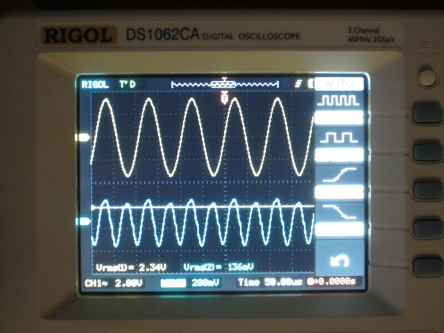

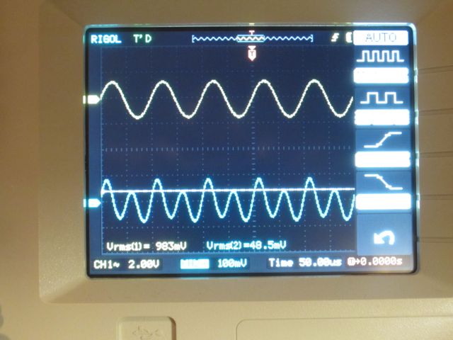

Here are the pics.
The first is 10V rms output
The second around 26V
The third almost 30V and clipping
the upper trace is the output (via a voltage divider) and a INA134
the lower trace is where the McMillans meet at the sources
William

I've not investigated this in detail but isn't quite a lot of common mode distortion to be expected? The X topology trades lower differential distortion for higher common mode on the grounds that the latter will have no influence on the speaker.
