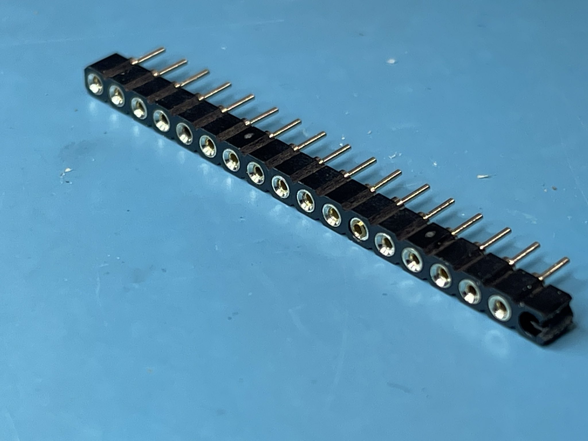

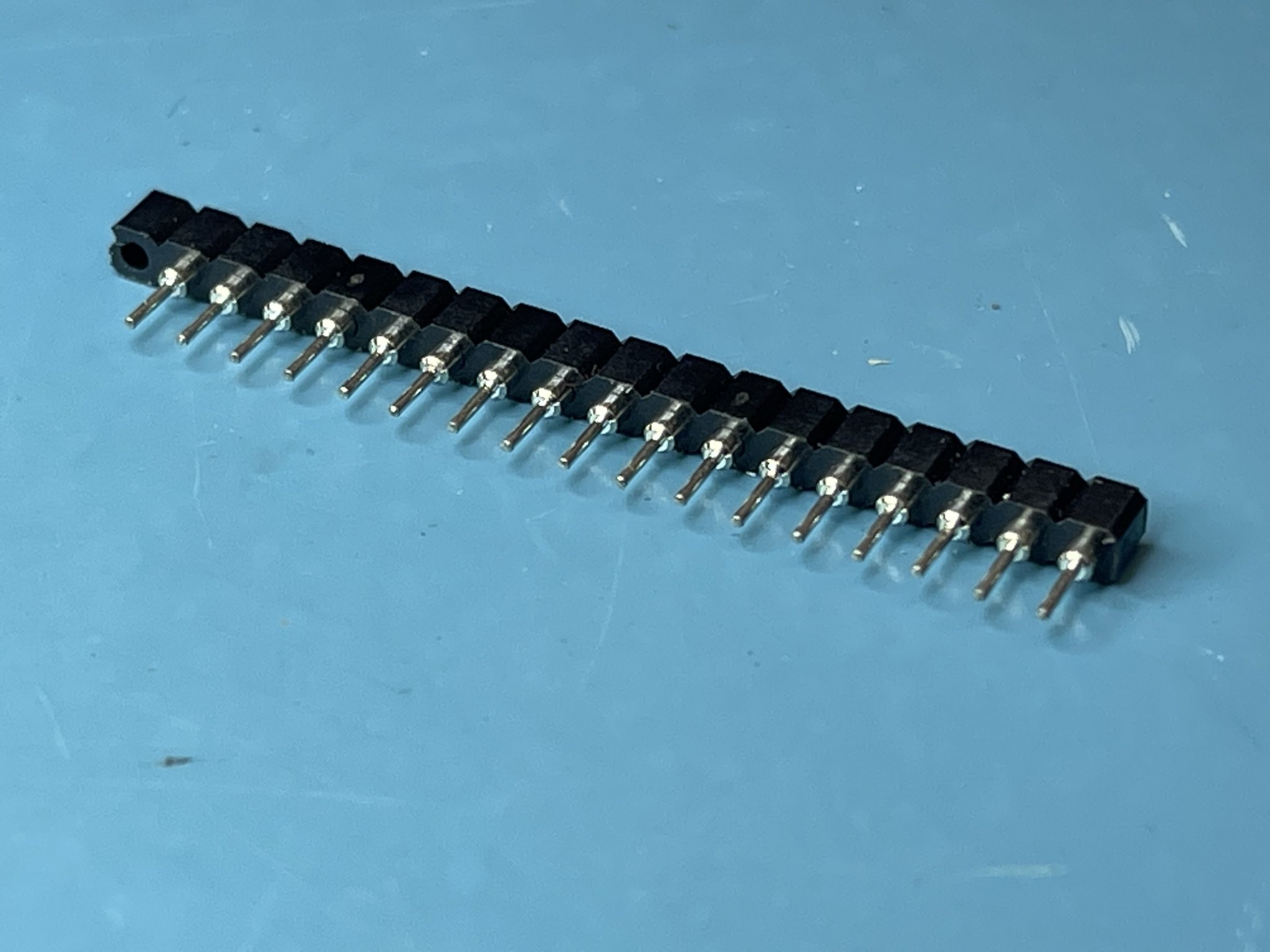

Sure thing. I just removed the pins from a SIP strip and soldered them in place. I fetched them from my neighbor who also does electronic projects. I asked him specifically if he had some with round sockets for hood lead contact, unlike the square contacts I have for PCB risers and such. Let me see if I can find a manufacturer and part number.Chris,
Do you have a link for those “female type” resistor socket doohickeys (the one over LR32)?
Best,
Anand.
Edit: this looks mighty close -
https://mou.sr/3jq3iPy
